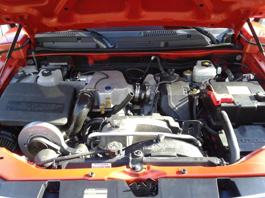

It's not finished yet, but it did make 2 laps around the house. Lol. It isn't tuned and the coolant system for the intercooler isn't plumbed. But it runs and is noticeably faster and I've only had it up to about 2,000 rpms. Also, the S/C is extremely quiet.

Okay, okay! :) I'll get vids and more pics when I can. I'm in my last week of school before summer break and things are hectic. I won't be working on the T much until next week. And there's always another part or two that I have to mail order. I've been very meticulous with the installation and I'm really trying to pay as much attention to detail as possible. I've been using OEM connectors and pins instead of cheap butt splices. I'm going to have to order more connector pins and some other odds and ends. Every mail order is like a week delay. And it seems like every step of the install requires another mail order.
This definitely isn't a project for everyone. It has been a bigger project than I expected. Hopefully it pays off in the end.
