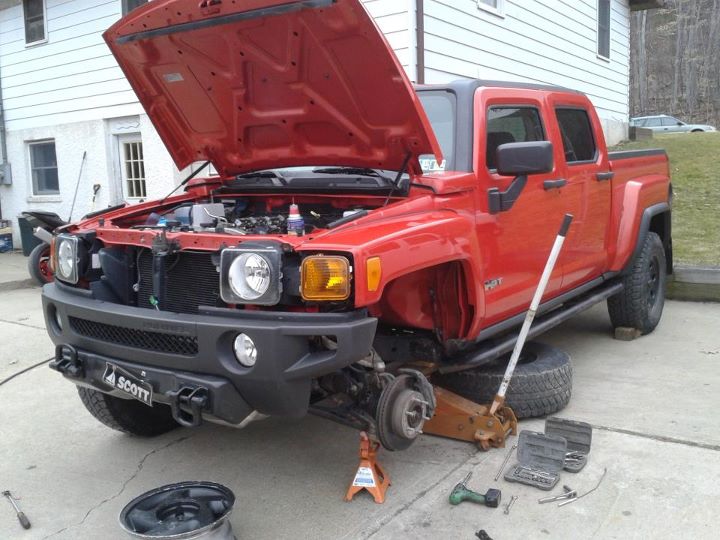

[video=youtube_share;SRshPCM9lhk]http://youtu.be/SRshPCM9lhk[/video]
I'm on spring break this week and got bored. Here's a little taste of what I've been up to.
Happiness is a warm ratchet.

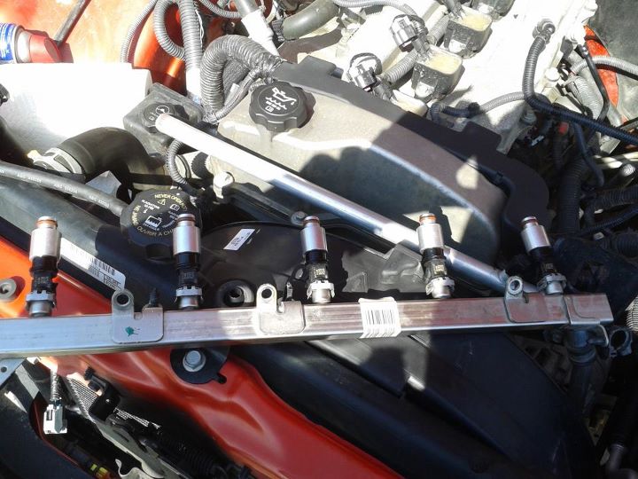

New injectors

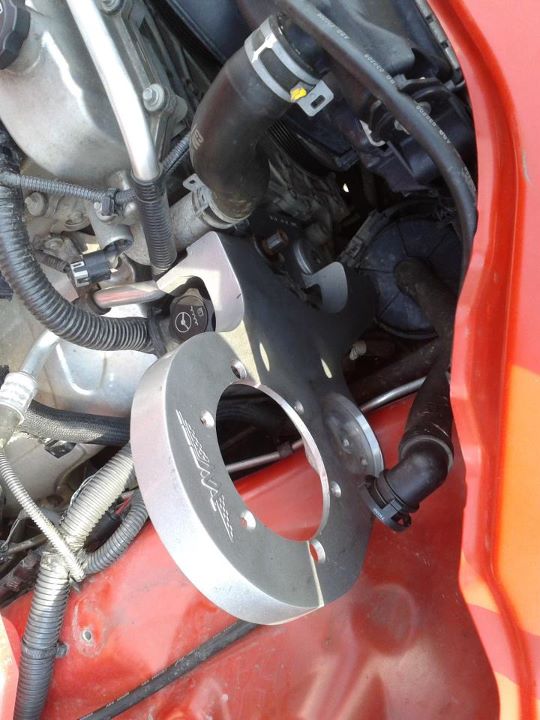

Supercharger bracket

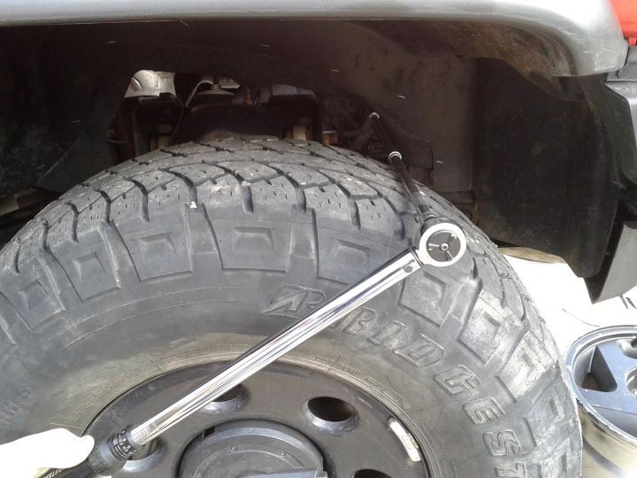

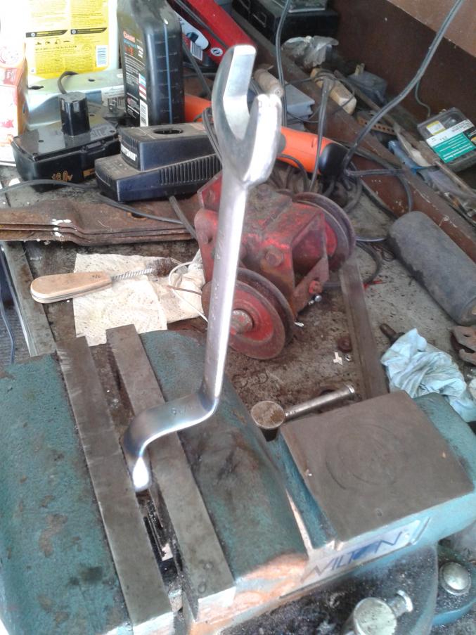

These were the easy bolts to get to

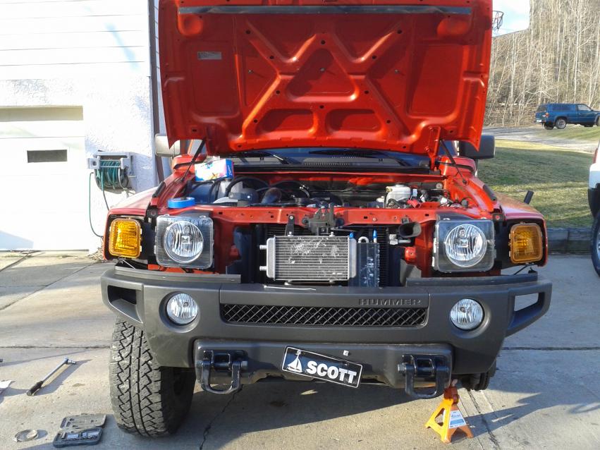

Do not..repeat...DO NOT turbocharge under any circumstances. Turbocharging an I5 = disaster and I and others have the repair bills to prove it. Wiser heads than mine cautioned but the mechanic advising me at the time said it would all be good...WRONG..WRONG..WRONG. The I5 didn't like the instant power of the turbo and a piston ended up with a hole in the top of it.
Supercharger gives a linear power and I had no problem with the reliability over 30,000kms of city and bush driving. The one thing I would stress is that you get someone who knows specialises in H3's and do not be someones test rig.
Mine included an air-water intercooler and I would strongly recommend as big assed intercooler as possible with a couple of manual fans behind the radiator to keep air flowing when high revving at low speeds as this was the only time I had the temp increase. Main area was on soft sand on a long beach for instance.
Power band is different and driving style needs to change as you need to keep the revs up for the supercharger, but the power is awesome...230-250HP at the wheels and aroung 400HP at the flywheel.

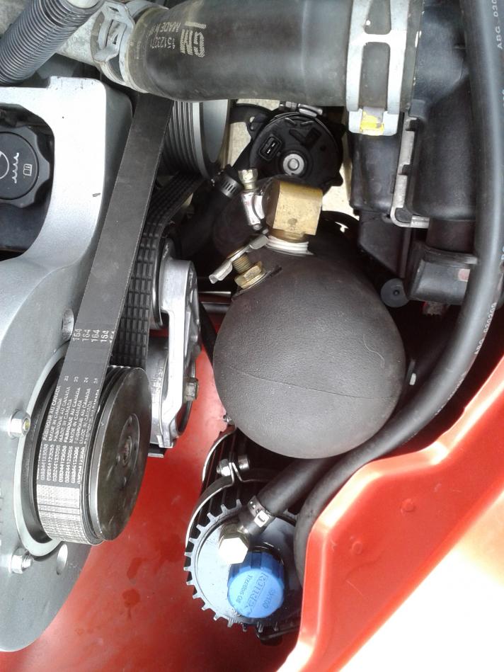

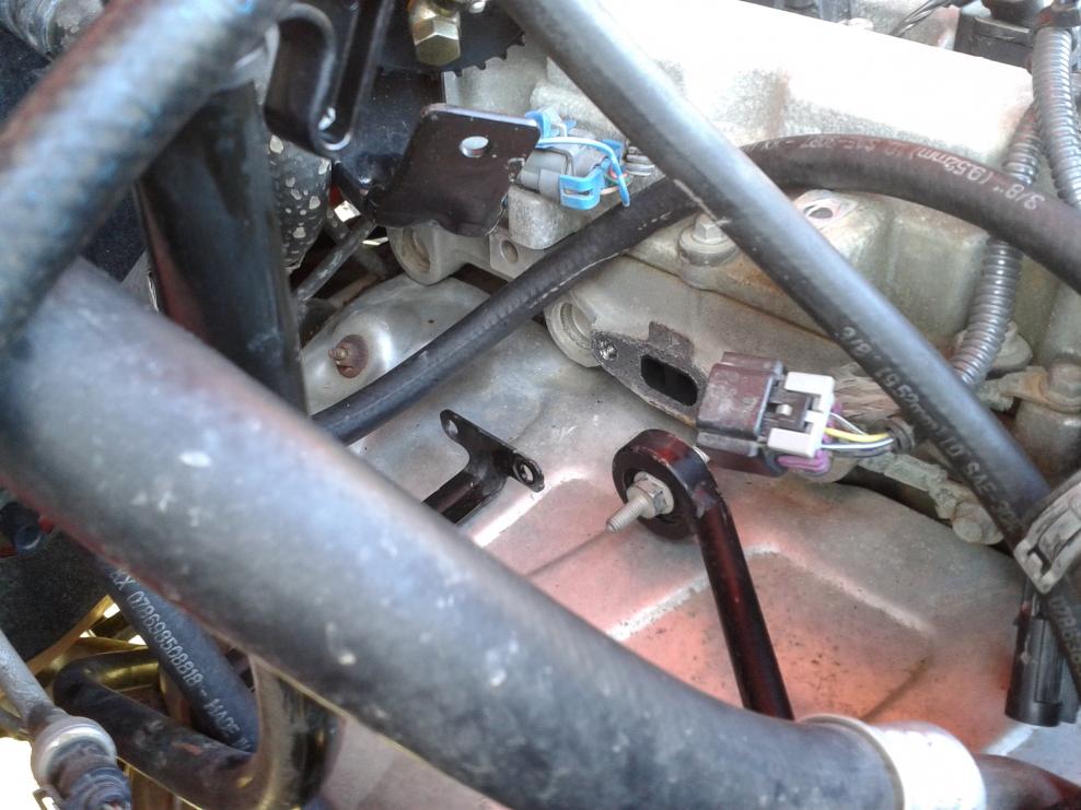

My busted up heat exchangers.
Air injection had to go.
Some time next week I'll make a block-off plate for that.

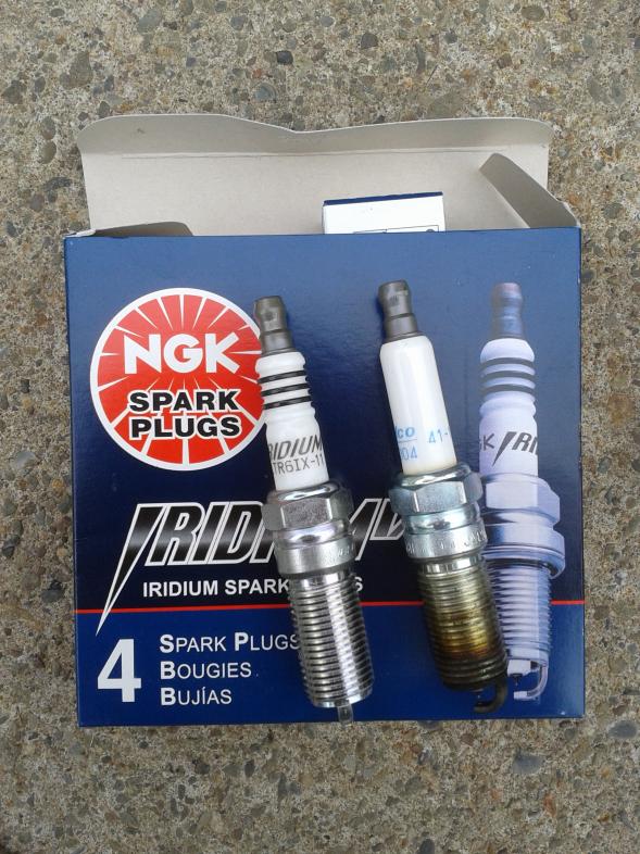

SolidusJ - I bought the kit used from theBroken. I believe I paid less than half of the retail price. I'm a little hesitant to post this, but...
Tally so far:
Supercharger kit - $3000
HPTuners -$650
Spark plugs - $45.16
Supercharger oil - $110 (A quart!)

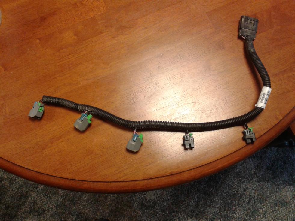

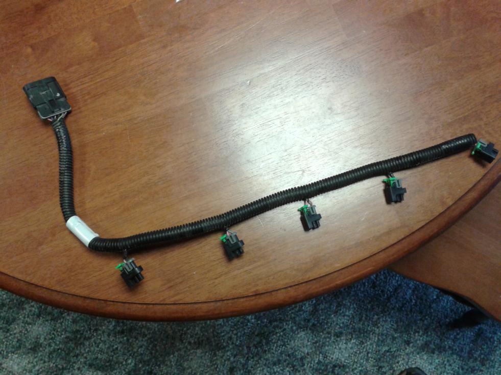

Connectors & crimping tool to make a new injector harness (new injectors have different connectors) - $165

Injector harness half finished to show the difference between the two connector types.
Finished harness
