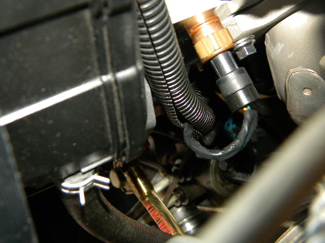

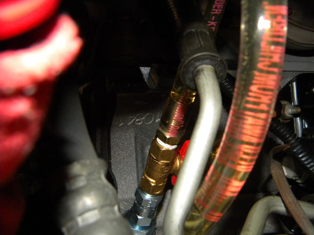

Just don't do the oil pan change like the "A$$" Monkey's on the Fast and Loud TV show. The oil pan is a structural member on LS engines and has a tolerance you have to pay attention to in regards to the back face of the engine. When you remove the oil pan you lose the "oil prime" on the engine so you have to pump oil through the galleys when you have everything back together. (I find it annoying that H3's don't have an oil pressure gauge.) Replace the O-ring on the oil sump tube. It doesn't matter on the mileage. If you take it apart don't take a chance on a failure. They don't necessarily seal the same when you take them apart and put them back together.
There is a plug on the driver's side of the block that you use to prime the oil galleys when the pan is removed. The manual states pumping two quarts through this connection. I drained the two quarts out of the pan before I was ready to start my engine. I turned the engine over before I connected the coil packs and made sure I had oil pressure at the gauge. Once I connected the coil packs my engine started immediately. That's the reward for all the work. There aren't any shortcuts. It's a lot of labor.
