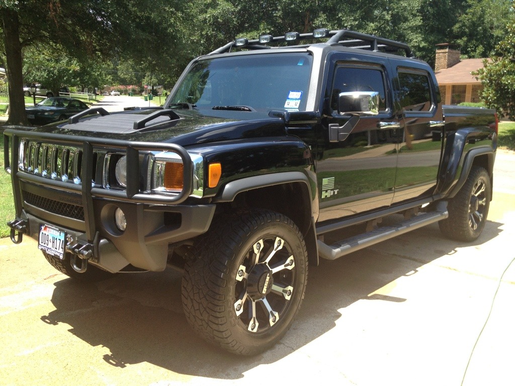

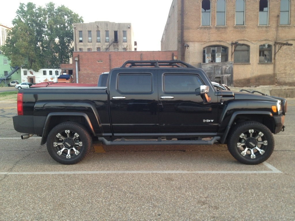

Well i was wondering if yall can tell if my truck is level or not... Still trying to decide if i wanna go with 35" or lift and go 37"... Still trying to do some studying. My truck already looks level but not sure if it was done when i bought it... What do yall think????
Tried to give yall some angles!!

Already looks leveled. What's it measure from the bottom of the fender to the center of the hub? Factory is about 22.5" and my guess is yours will measure around 23.5-24".
Sent using Tapatalk
*edit,
Going to be hard to get an accurate measurement with the E&G fender flares on because they hang down.

As I expected, it's already been leveled. Even 24" is a bit high. Hunner has a thread about slightly trimming the E&G fender flares to help clear 35s off road on full stuff.

Awesome! Im goin to go look for it now!! Should i drop it lower then 24"? Ride is stiff but doesn't bother me.. Bothers my wife more then me..
You're definitely sitting leveled. If you go with the lift and 37s, you'll be the first H3T with E&Gs to do it. You may havge to trim, but with another 4", maybe not. Another guy did 37s on a lifted T with no problem if I recall correctly.
