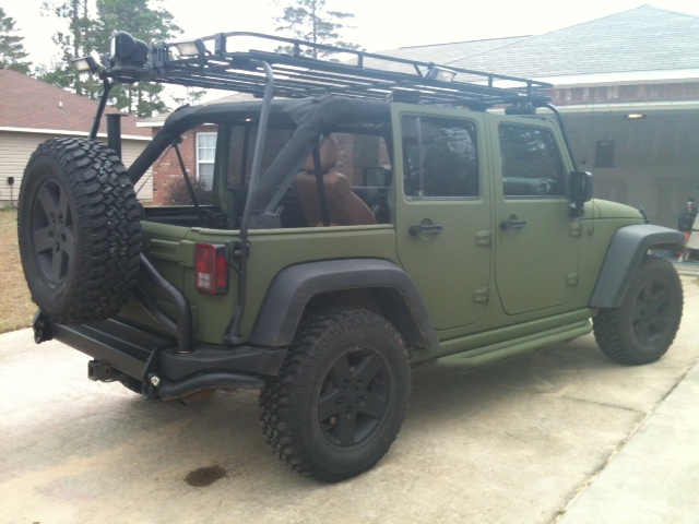

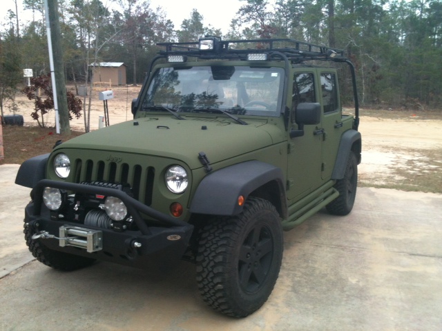

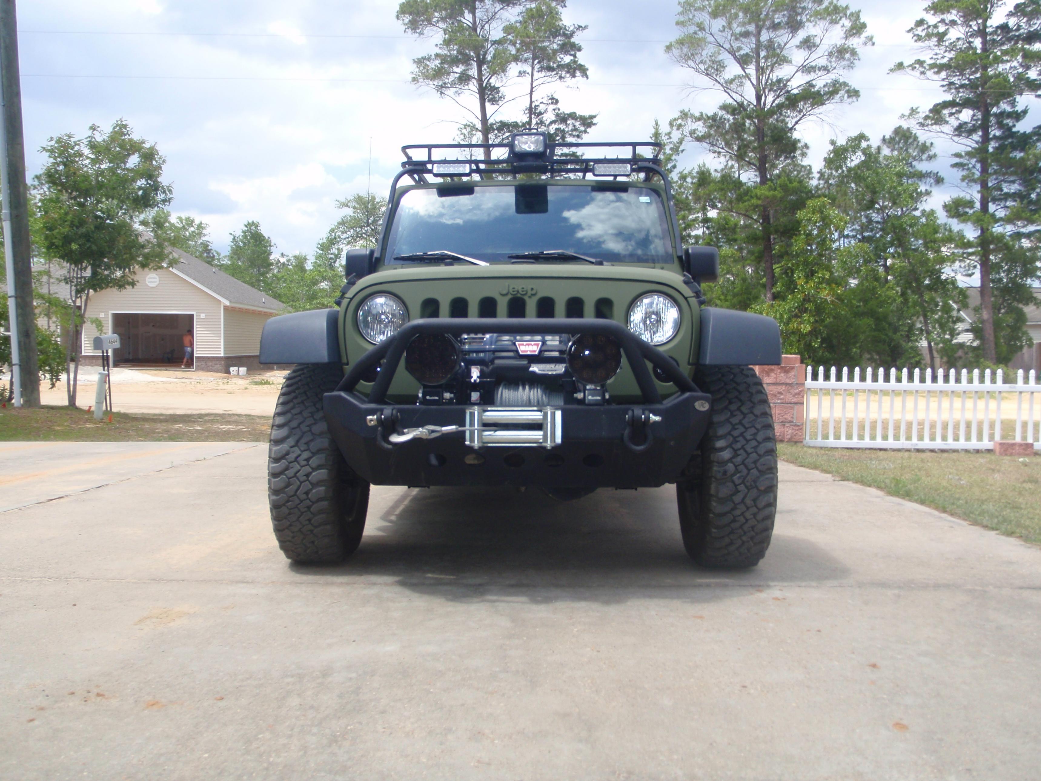

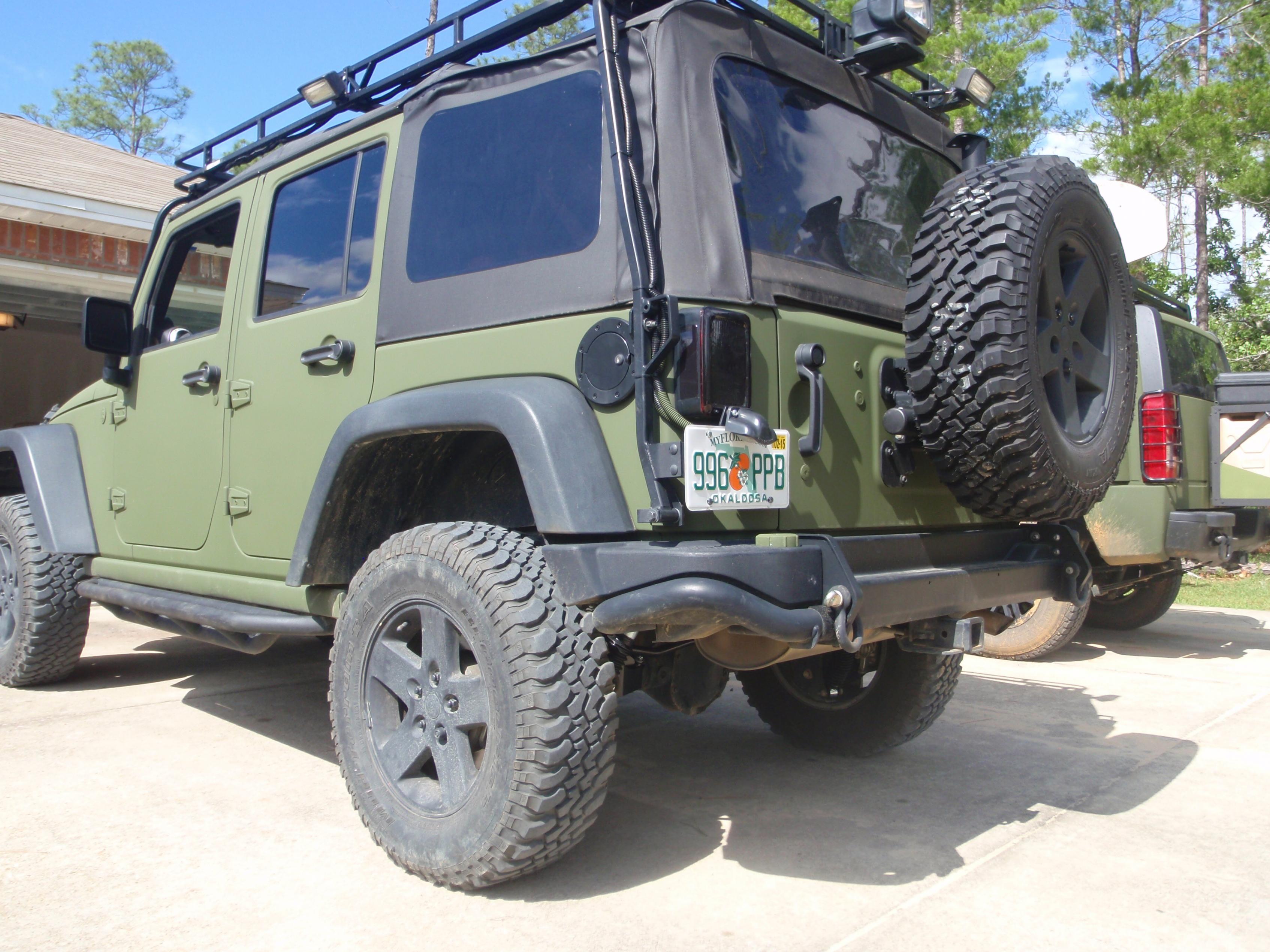

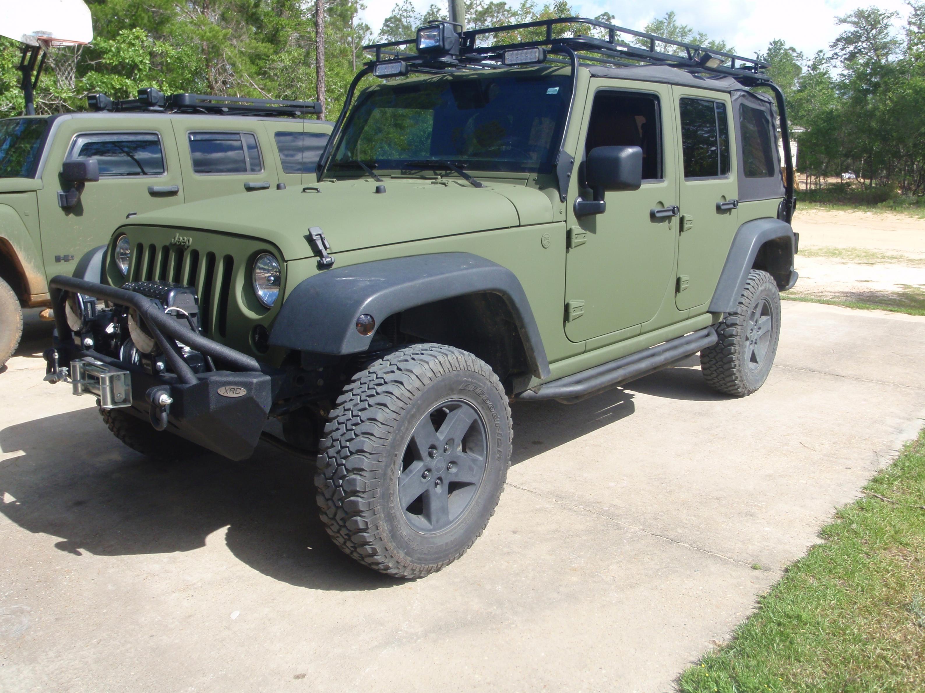

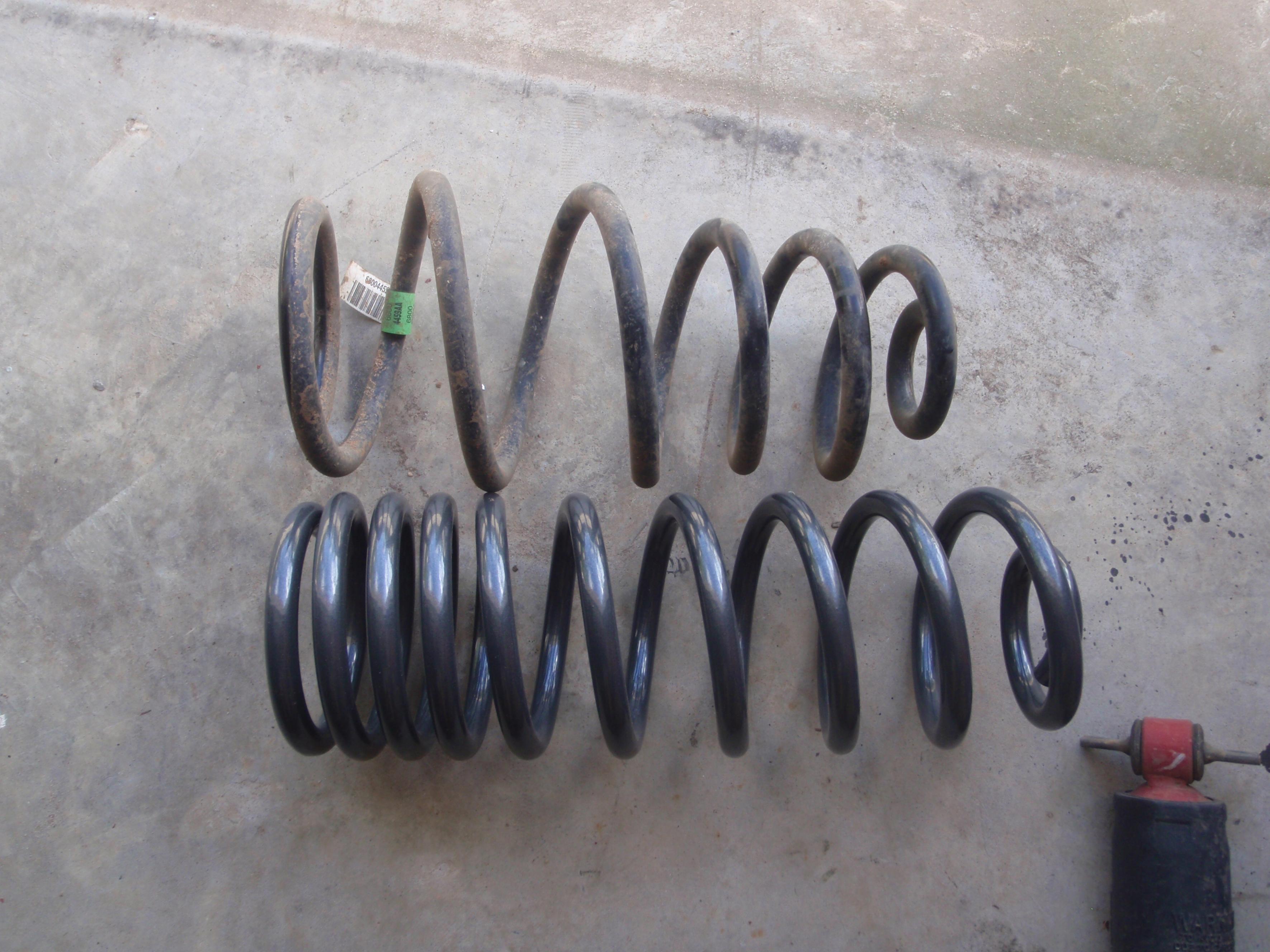

photo.JPG photo.JPG this is the jeep currently, its my friends, he out of town for a bit so i've been adding the upgrades for him, its pretty fun doing the work on the side. this jeep will look much better with the bigger tires and lift.

View attachment 10419 View attachment 10420 this is the jeep currently, its my friends, he out of town for a bit so i've been adding the upgrades for him, its pretty fun doing the work on the side. this jeep will look much better with the bigger tires and lift.
He has some weight on there with those bumpers. he will want a lift that was designed to support the weight of those bumpers. Here is what I would do: AEV 2.5" Lift, AEV control arm drop brackets, AEV ProCal, front driveshaft. He will either need to run wheel spacers or wheels with aprox 4.5" backspace. Outside of that, he's good to go. That lift will support that weight, ride great, and allow for the added weight of gear too.

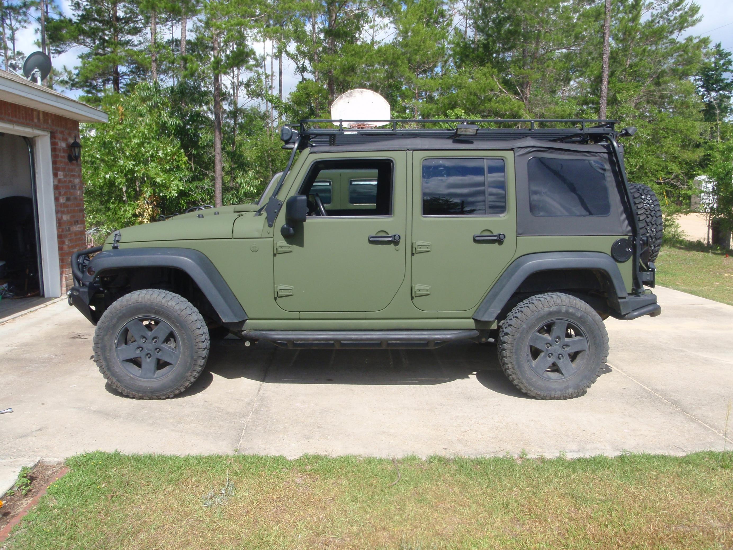

2.5" Teraflex lift with 35" ProComp Extreme MT's. This kit did not hold the weight of the bumpers and gear I took with. To run this kit, you need their 2.5" springs, front lower control arms, teraflex shocks, front driveshaft, front trackbar. That's what I had on that rig.

This is an AEV 3.5" lift with 35" BF Goodrich AT's. This kit is perfect for 35's and 37's down the road with flat fenders or more bump stop to limit up travel. quite a bit more room for 35's. Stock arms flex very well.

No welding. A little drilling on the lift if you go the 3.5". The exhaust spacers are super easy as well. Plenty of info on the installs (youtube). The links in my sig line are me. I own Expedition Hardware and also work for High Country.

my friend got the lift and waiting for it to show, i didnt get the post that those links are yours till after he ordered them already, thanks for all the help i will post progress soon, went with aev 2.5"

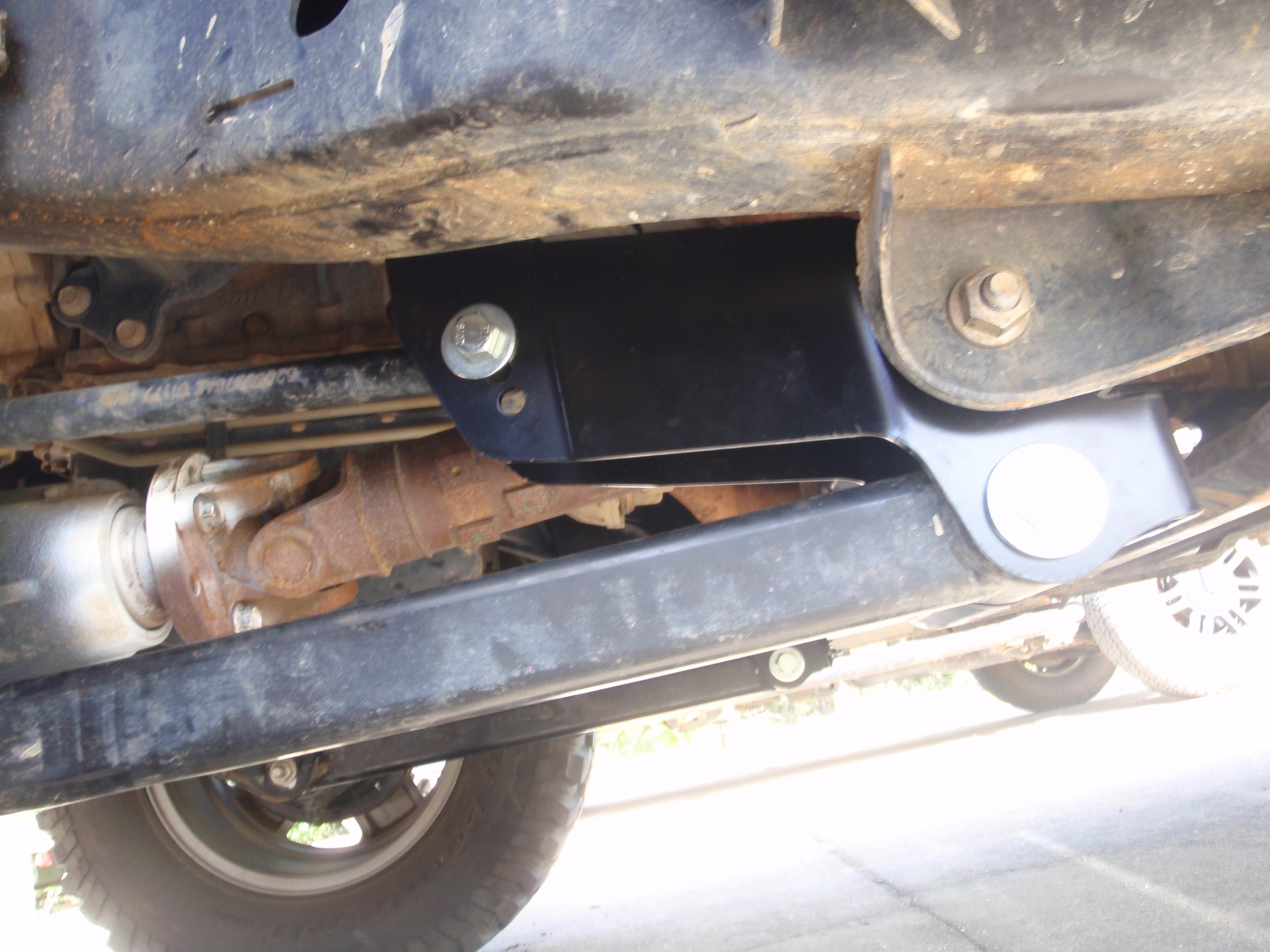

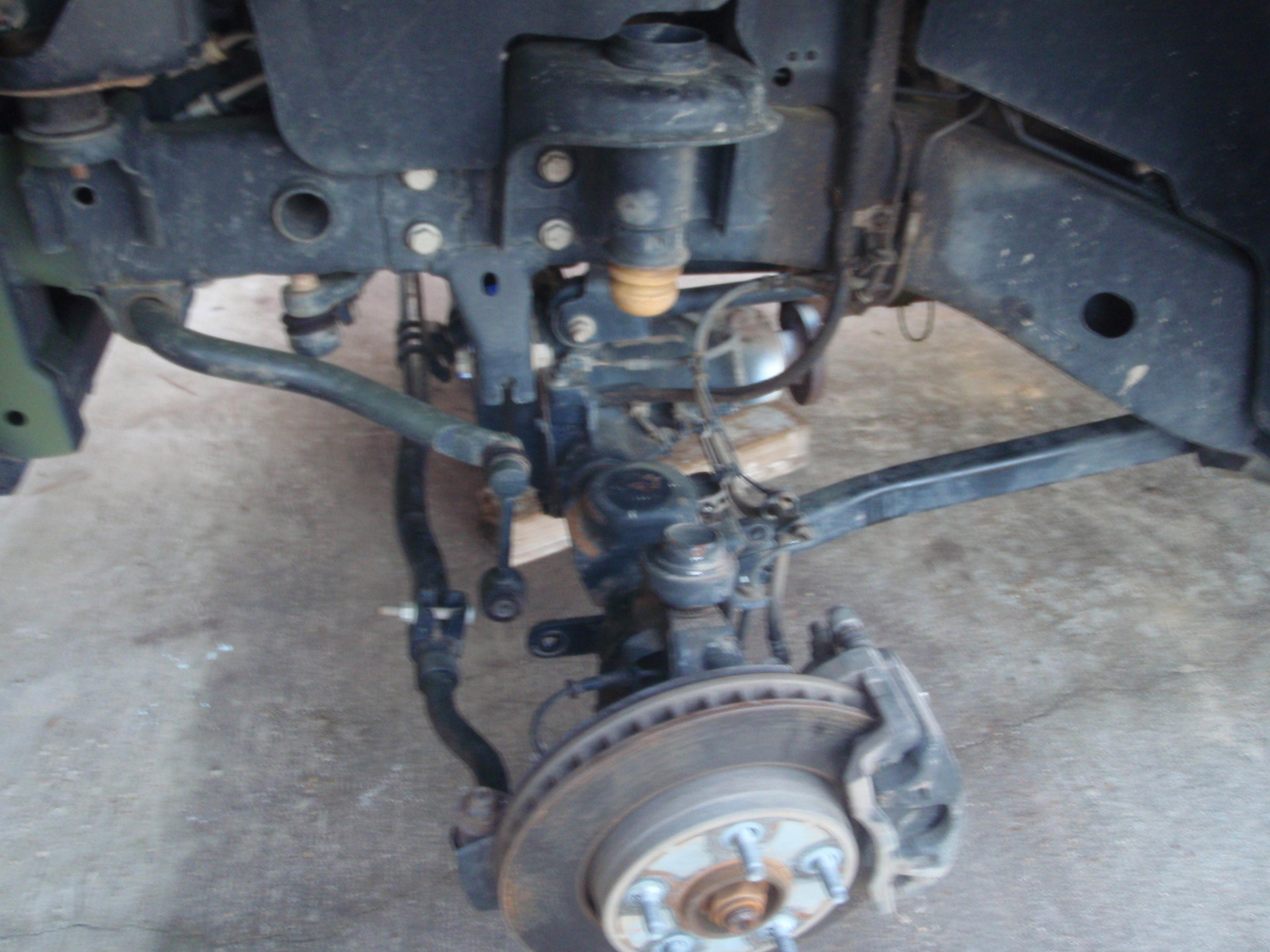

Make sure he ordered up the Geo correction brackets. They do not come with the kit. If he didn;t, get the coming asap. He will need them to put his caster back into place..will give him stock handling. without them, it doesn't handle well.

ok the lift just showed up yesterday, do you have a link for the geo correction brackets?

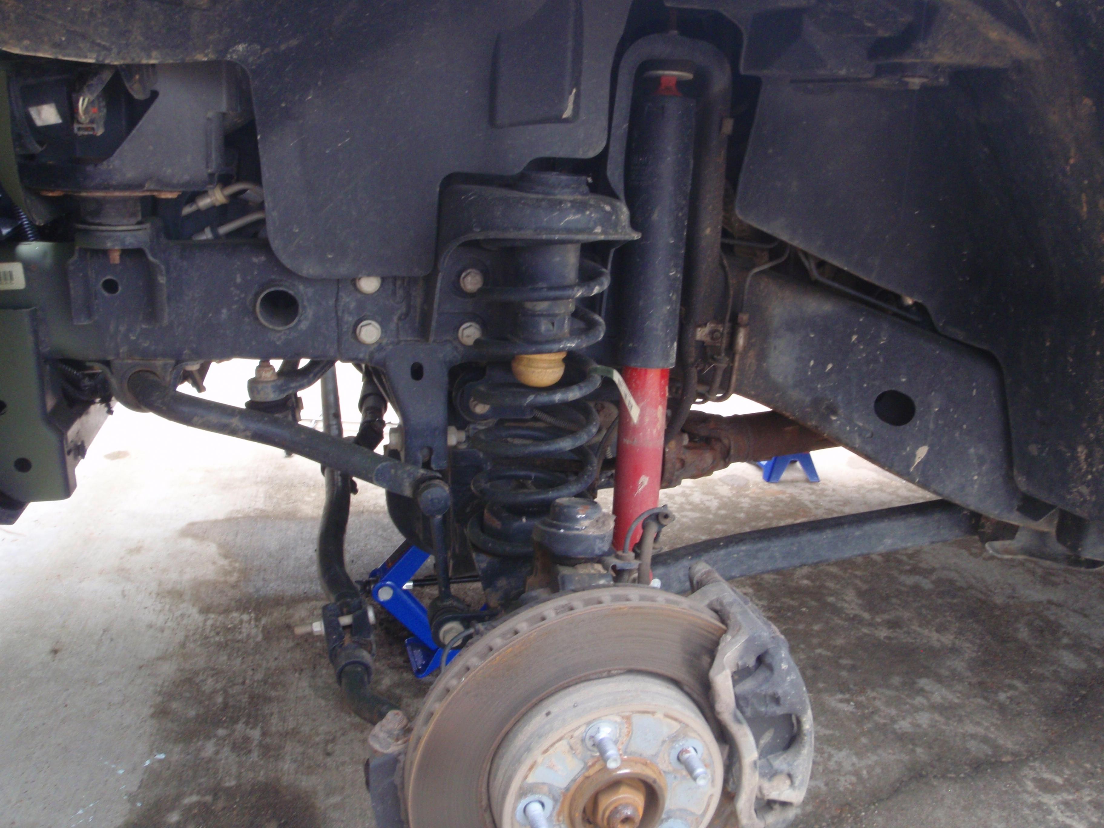

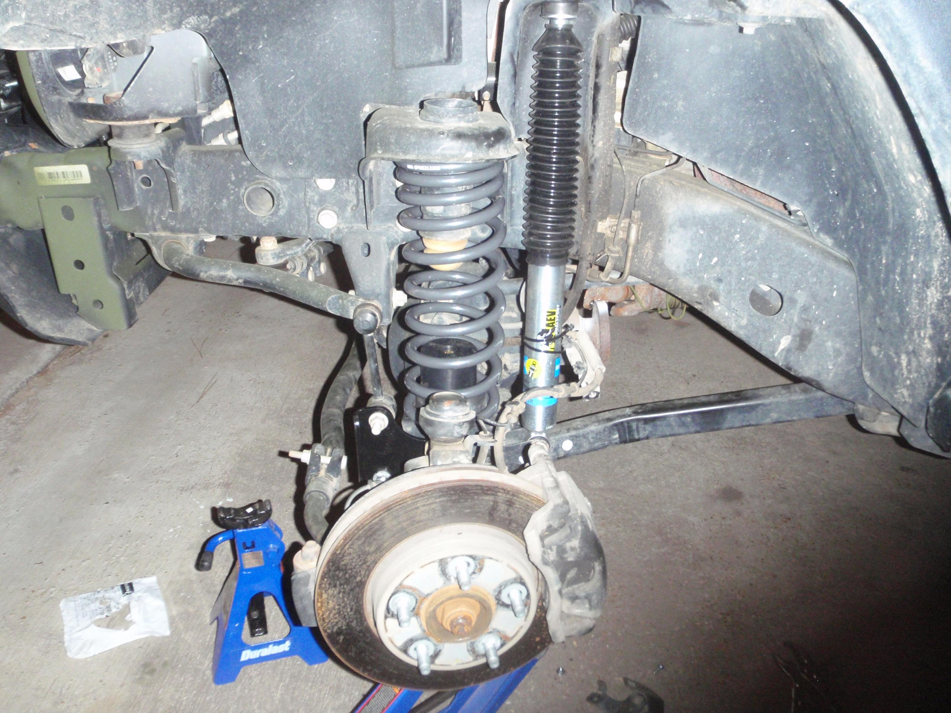

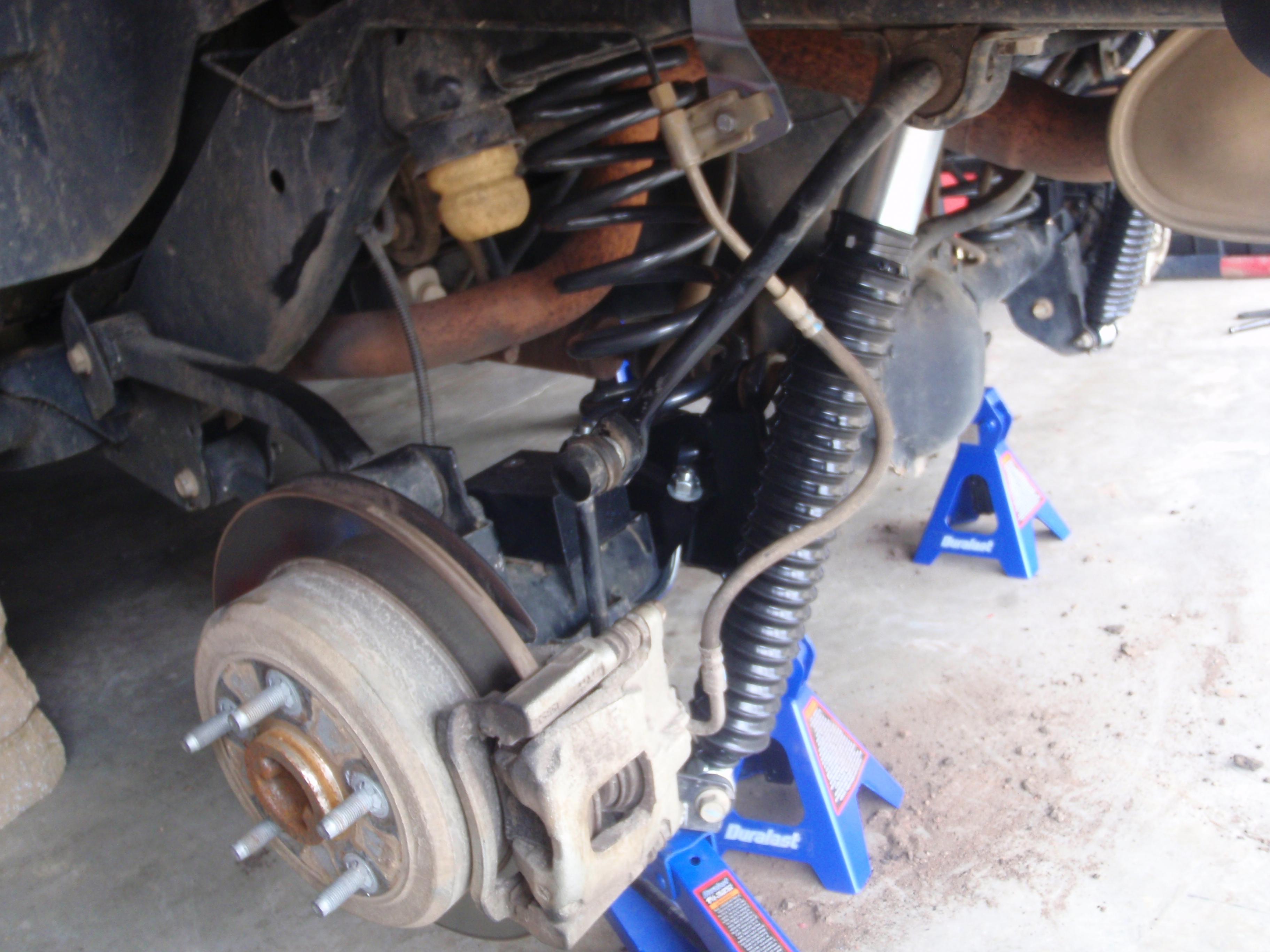

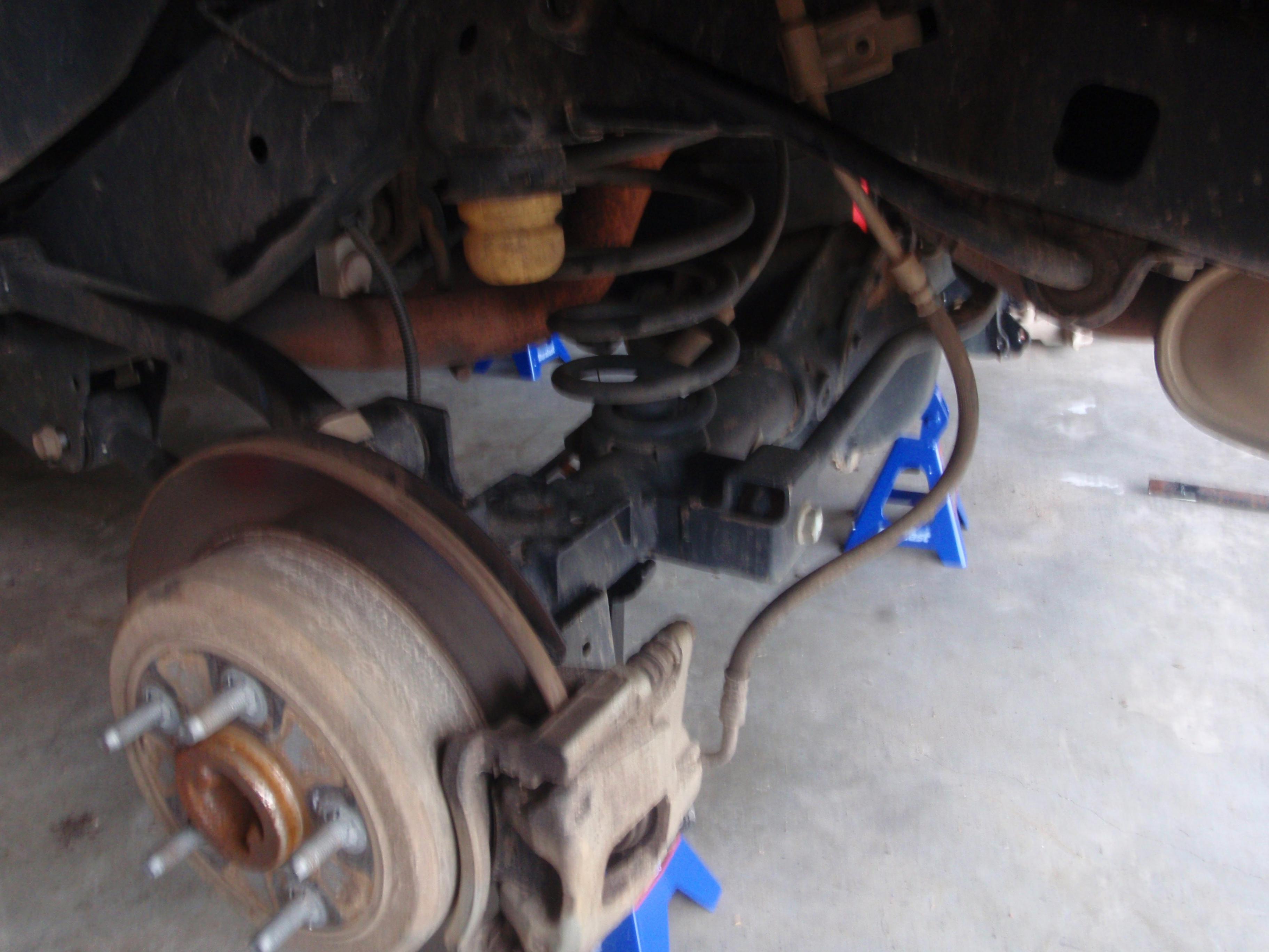

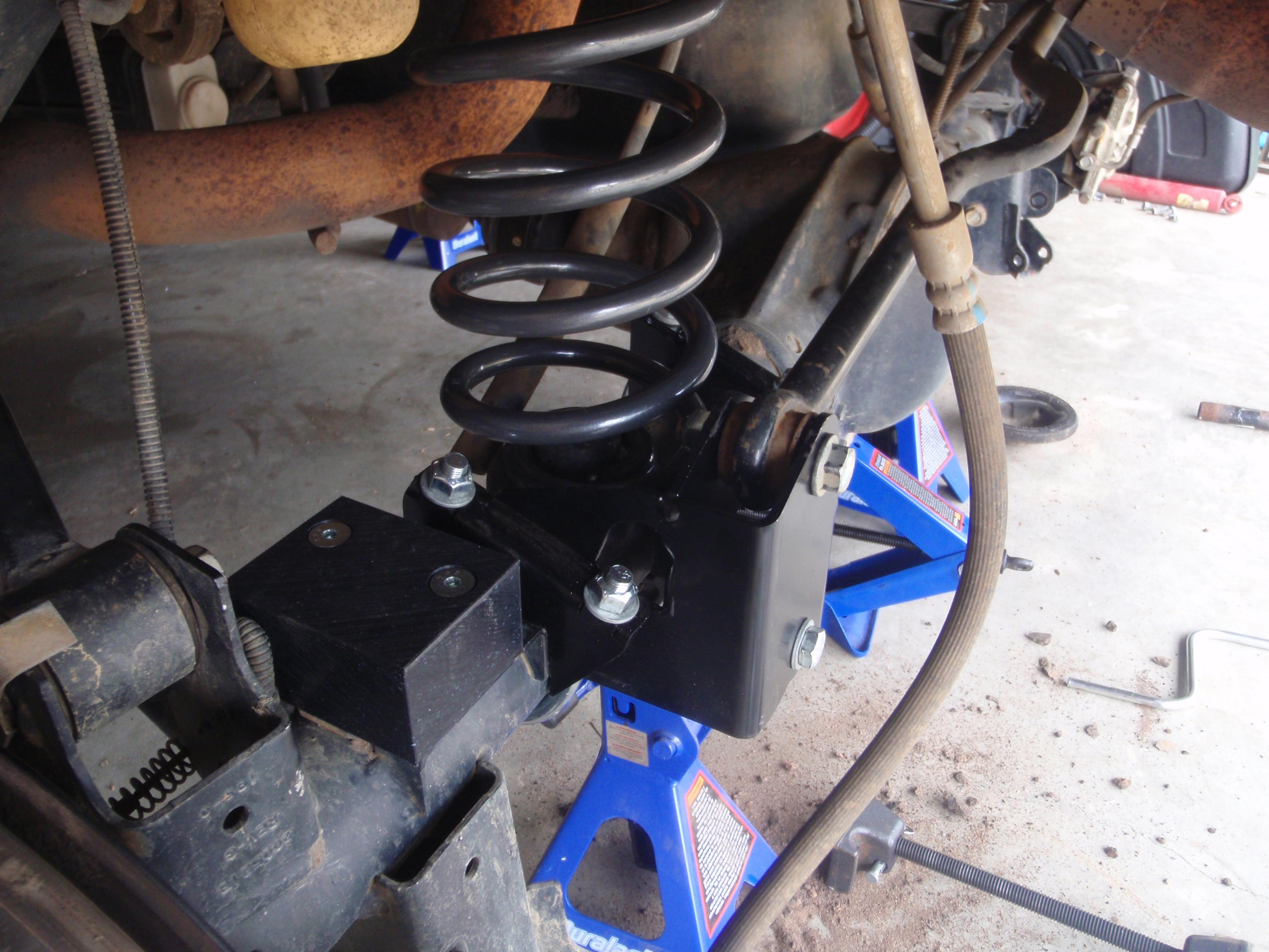

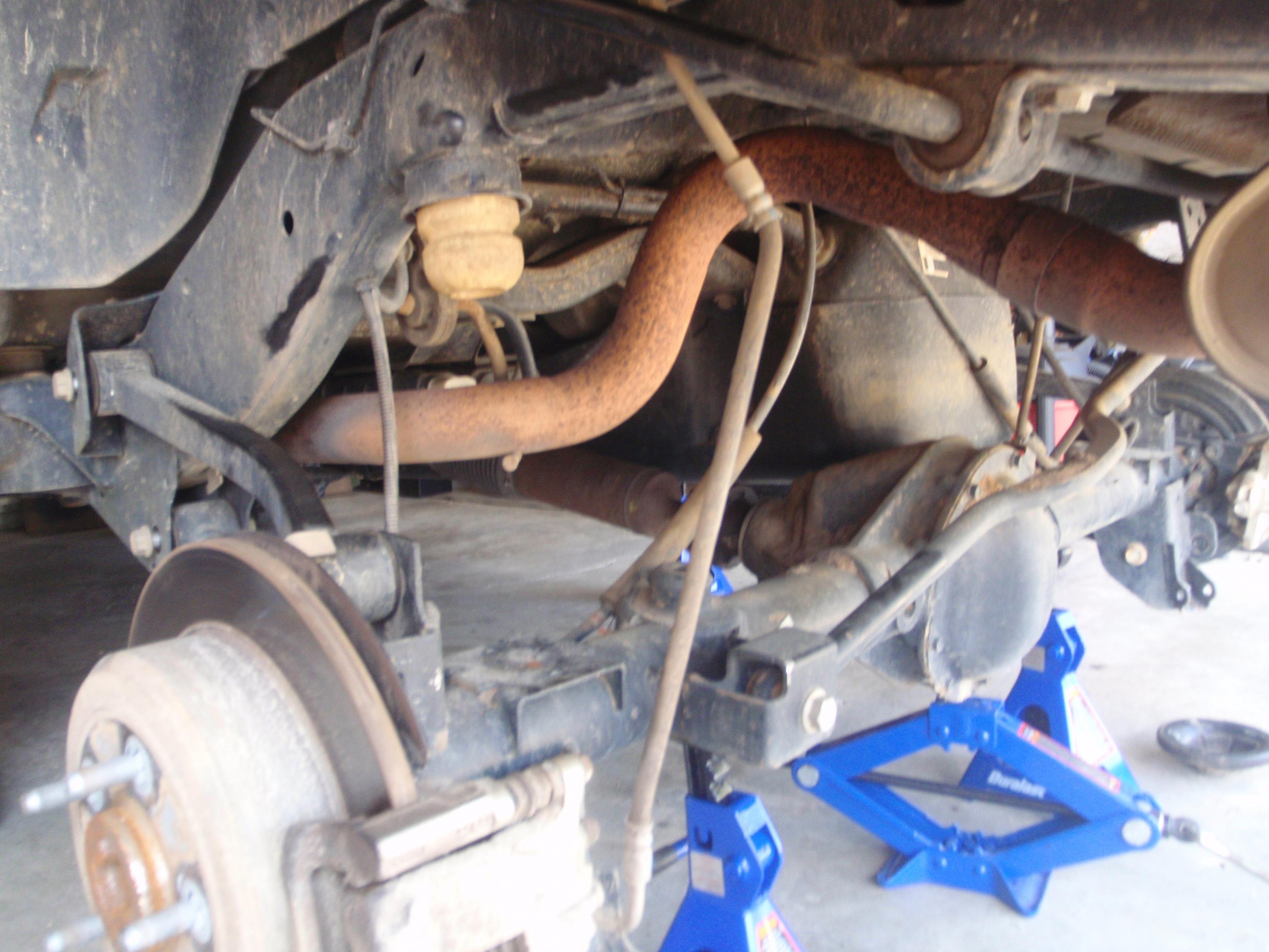

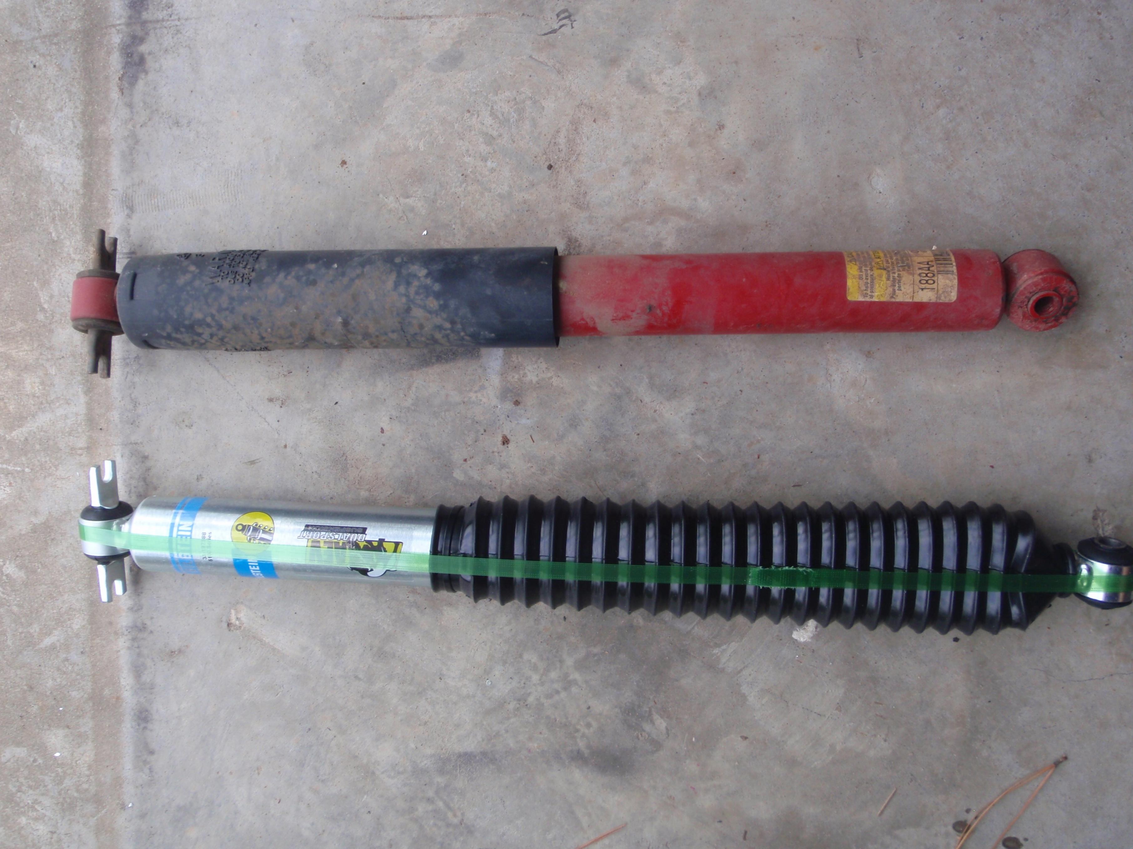

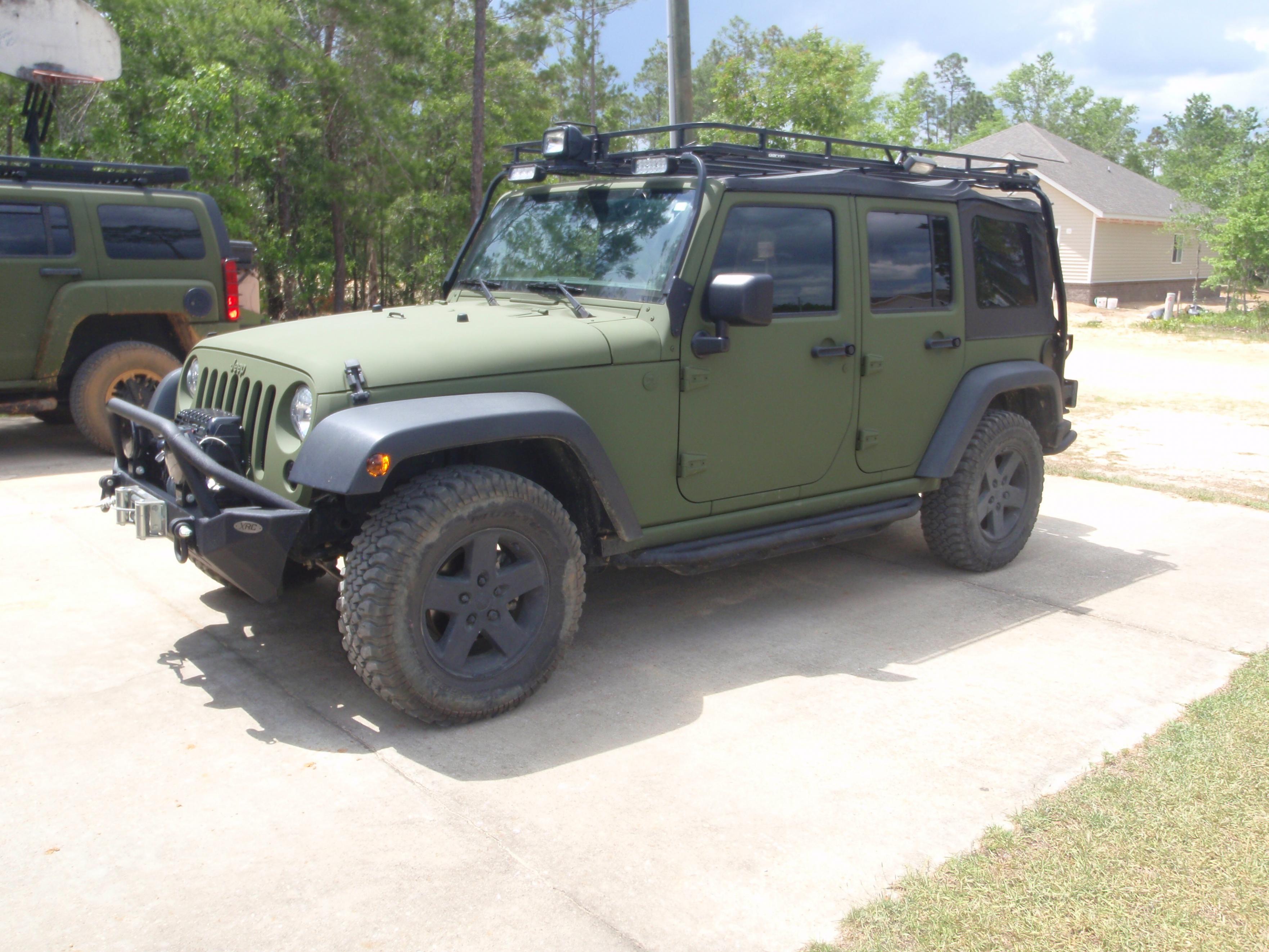

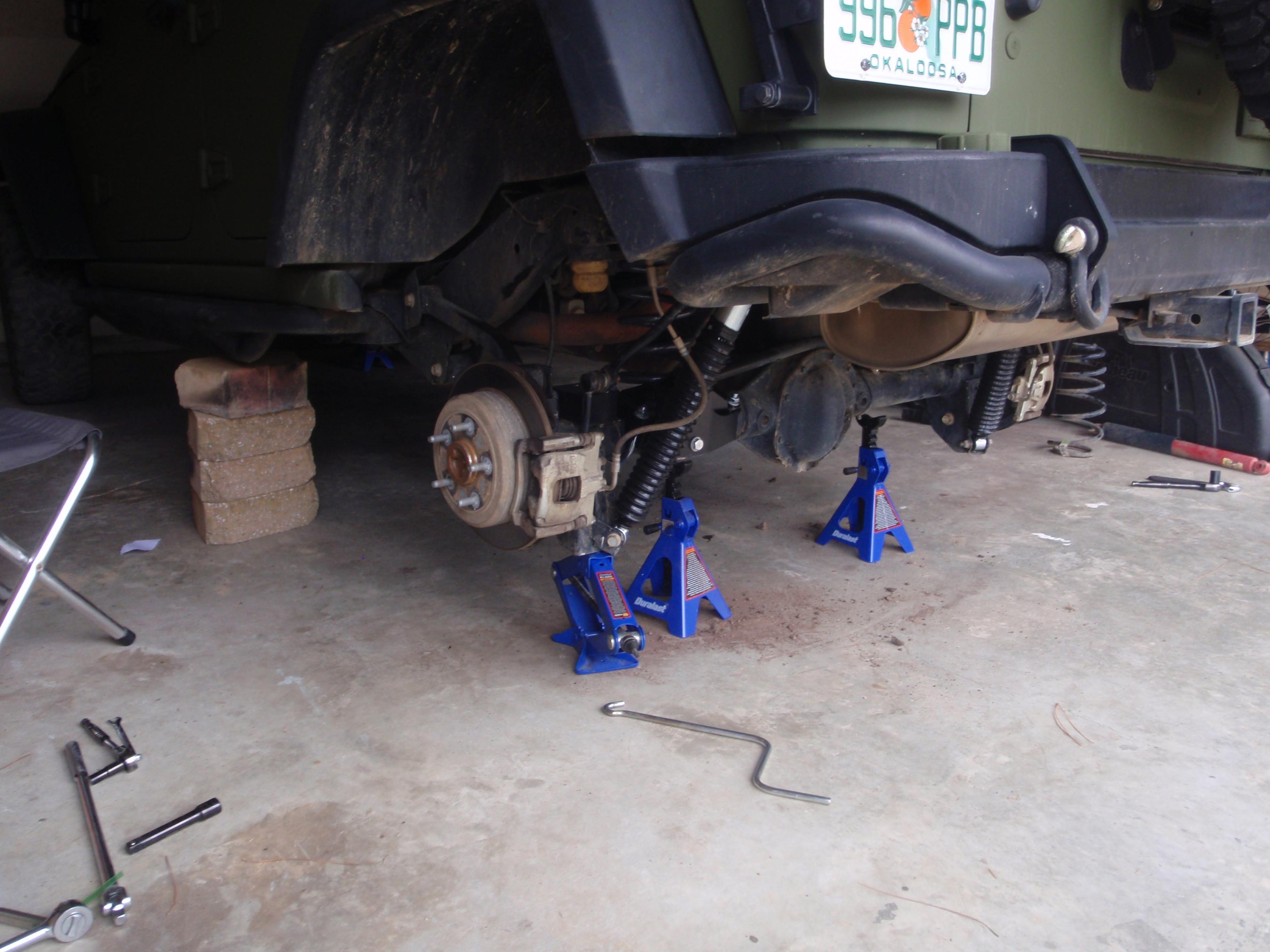

P6030205.jpgP6030206.jpgP6030208.jpgP6030207.jpgP6030210.jpg after i finished, added the geo correction bracket, and tomorrow the rugged ridge snorkel will be added.
