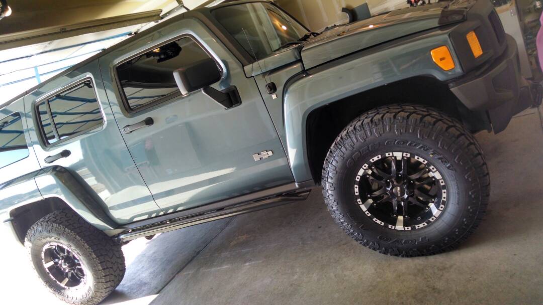

I just had Toyo Open country ATIIs installed this week and so far I like everything about them on the road and for light wheeling off road.

I've been running 35s for about 4 years now and I get any where from 15-16.5 mpg. With stock 33s I was about 17.5-18.
