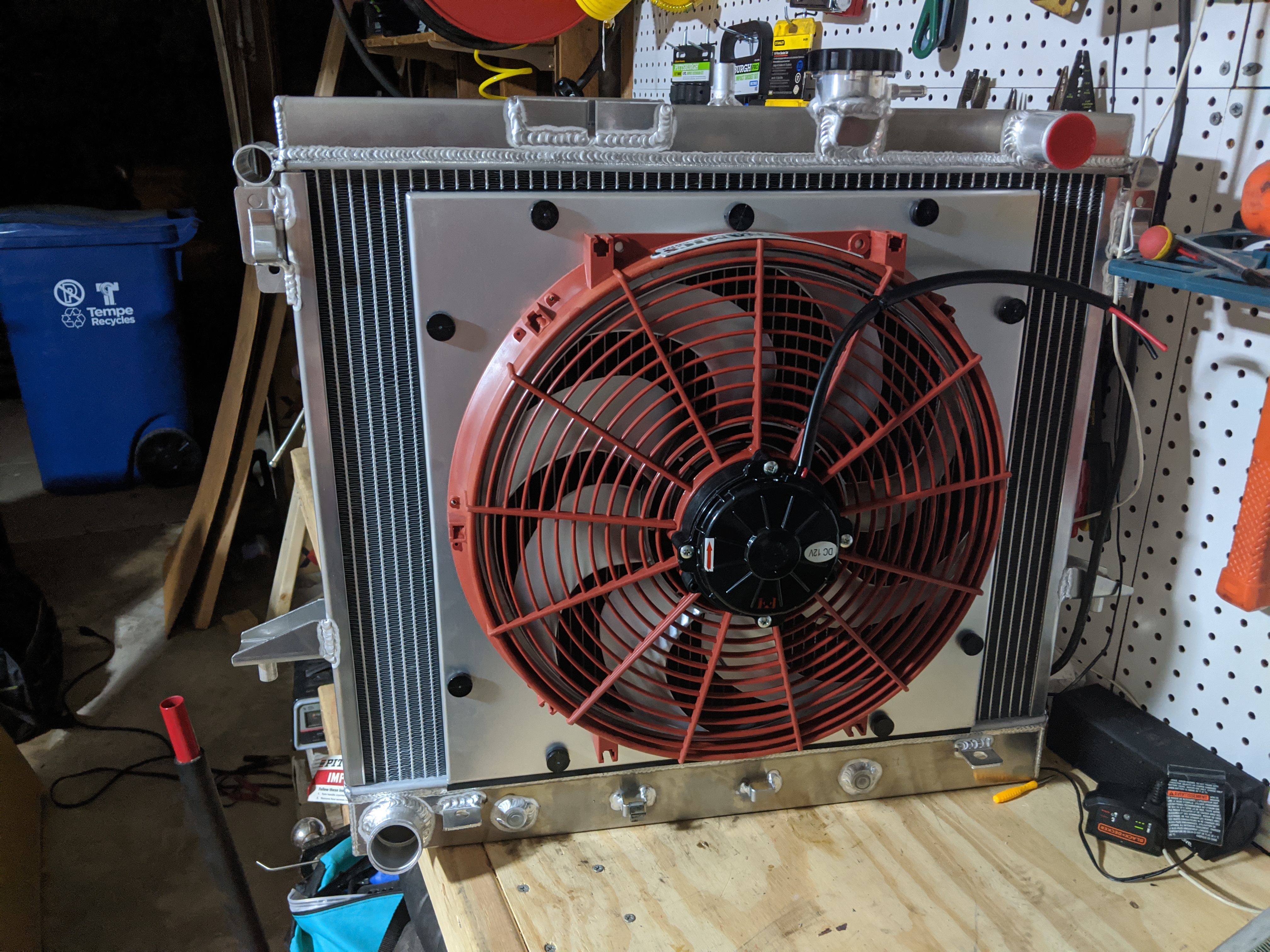

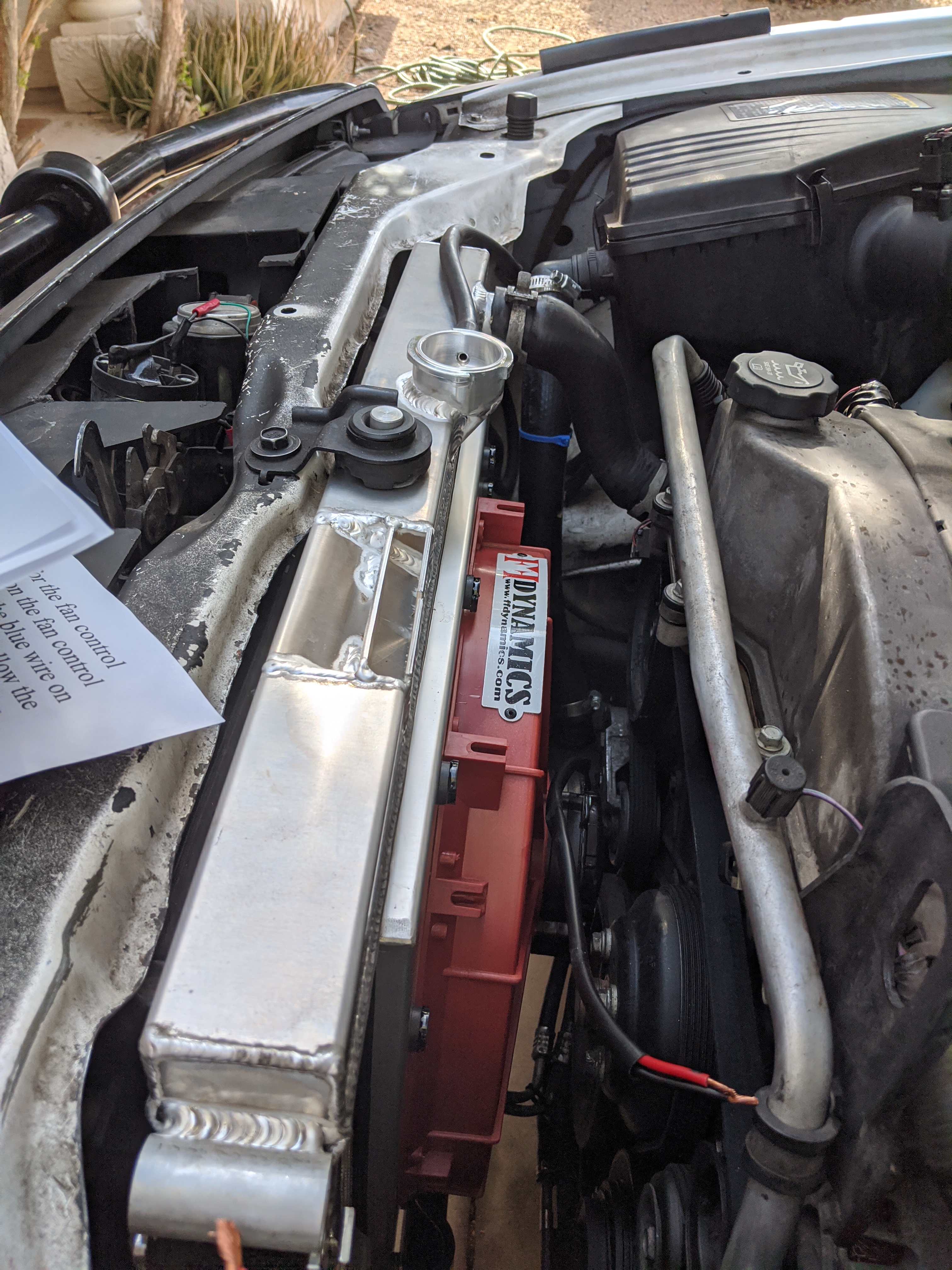

I've been using the H3 mod kit from FF Dynamics for several months and everything is going well. I ordered an amazon aluminum radiator to go with it
Wasn't a bad job to say the least, and here in Phoenix where my temp gauge was always at 3/4 or a little more it runs around 1/2 in 116 degree heat. I took Alrocks advice and used the add a fuse to wire
the ignition source and AC clutch positive in. Temp control unit works well and so far I have no complaints :) IMG_20200721_213924.jpg
