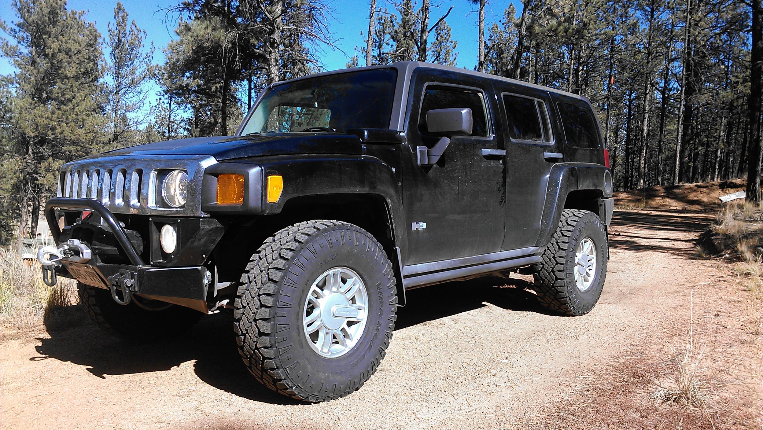

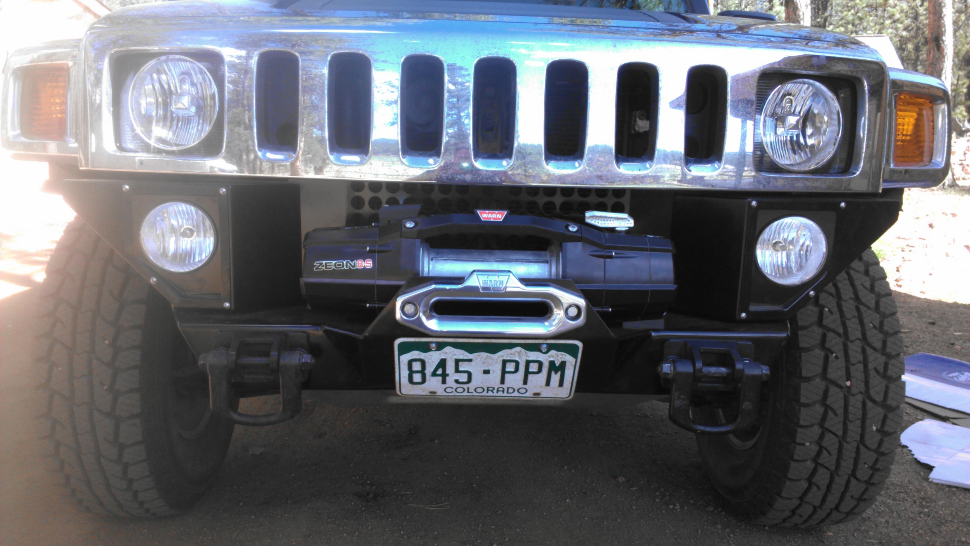

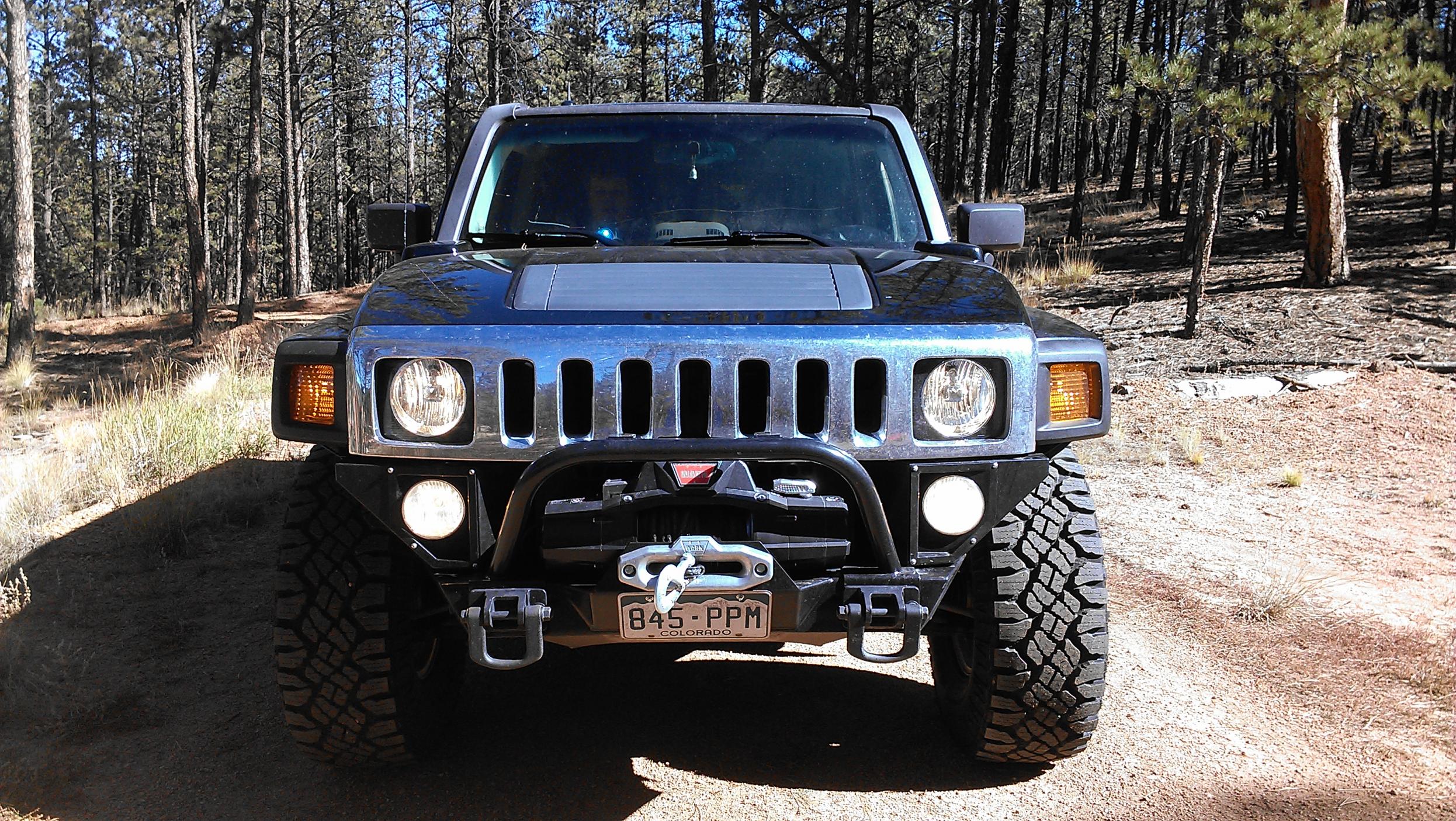

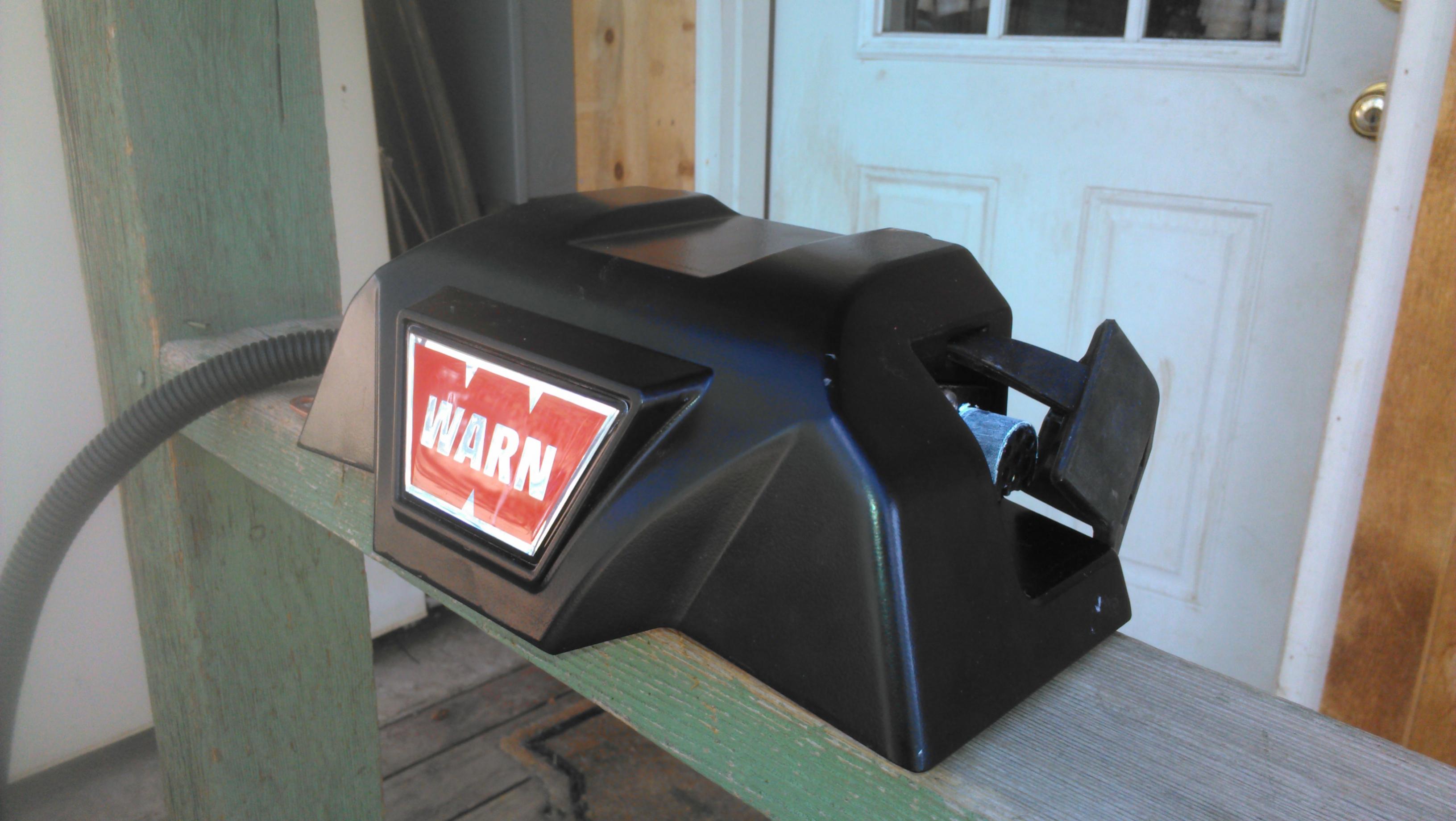

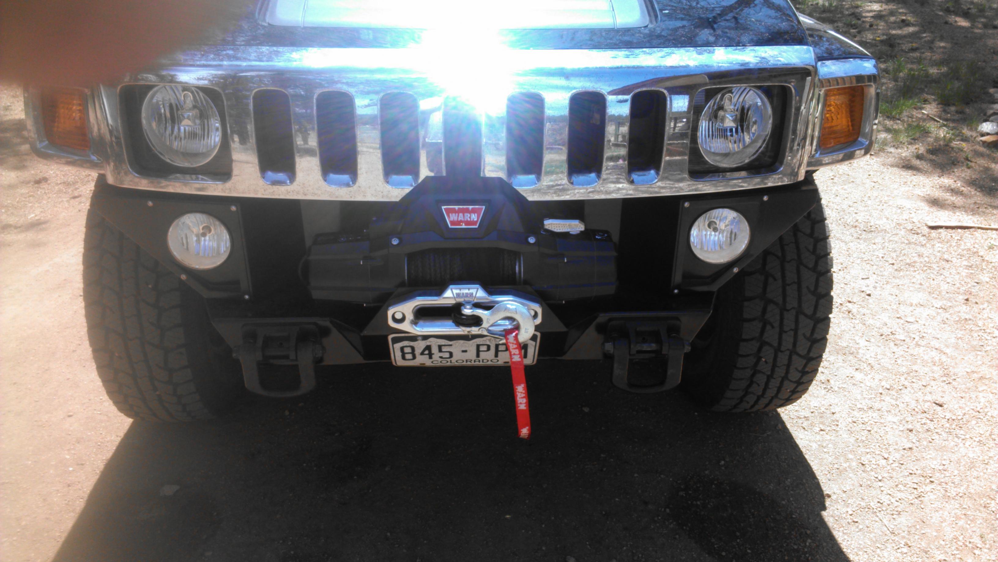

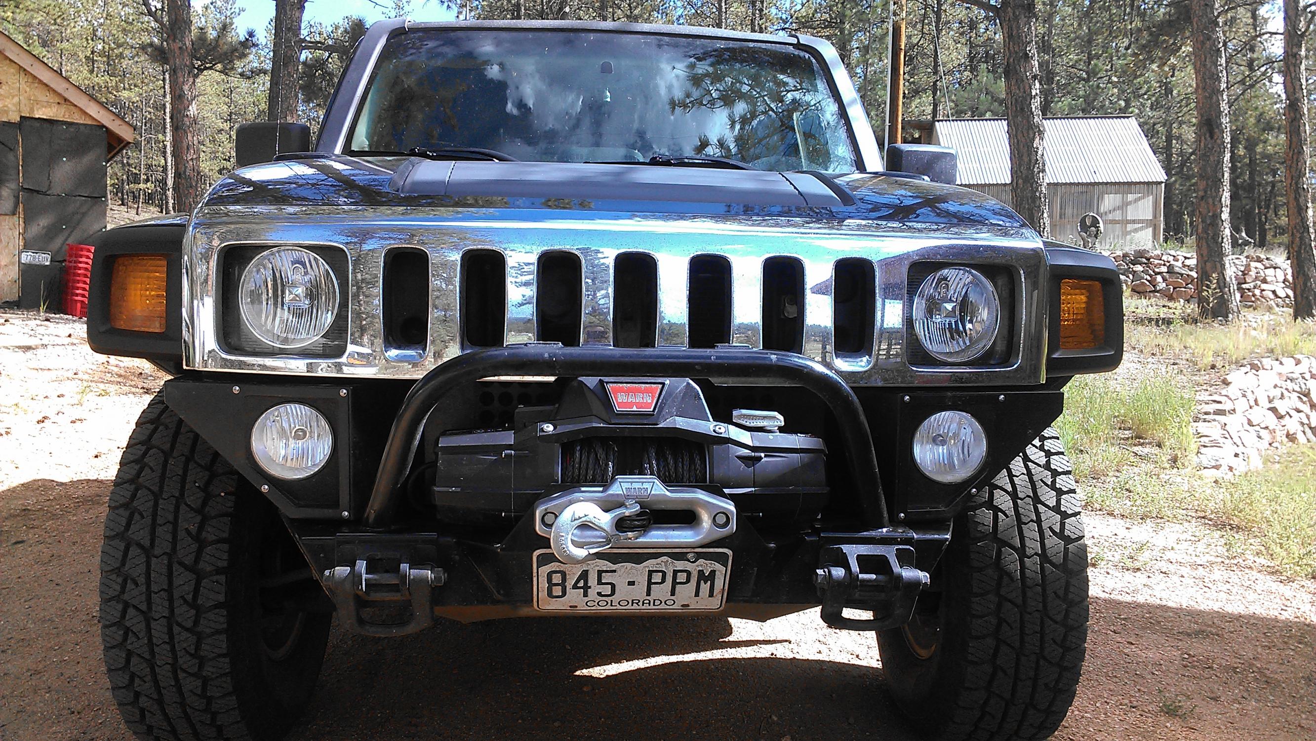

Becareful on your choice of winches w/ the Thor bumper. I went w/ Warns lastest an greatest, Zion 8/S. I still haven't used it yet but, It is tall w/ the control pack on top. W/ the new bumper it is recessed back some. So I had to notch my grille about an inch an a half to fit it. No big deal. If I was readin some of your other post correctly, you got a body lift. This should not matter if, you do you lift first. W/ the Zion and the control pack on top. They say you will save about 20% of power when in use.
I think also, I posted pics here over a year ago. At that time also they had a deal w/ recovery gear free when you buy it. I also went w/ the 8/S instead of the 10 cause w/ the block I got w/it, I double my load I can winch.
