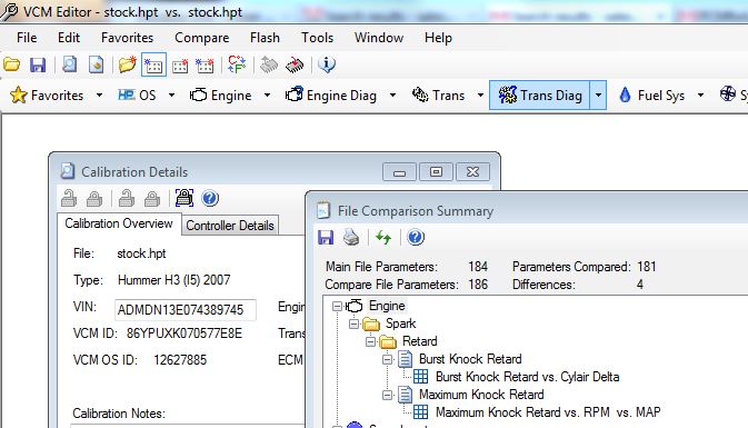

Have you guys done any South African Alpha Models? I have one and Im considering doing a PCM tune in the near future, just wondering if you've done any?

I decided to go the HPTuner route for my V8, but will definately push on PCMofNC when I start tuning. once I have the HPTuner, I will download my stock info and send it to Kelly and they can perhaps analise it and see what variation there is between the SA V8 and the Alpha. there shouldn't be any difference in my mind though

We have, they're not that different except for a few tables. Very subtle differences in idle, rev limiters, and a few spark tables. You likely would not feel the difference between one or the other.
The differences are very small for sure. Still great gains from the tuning whether it's a US model or SA!
