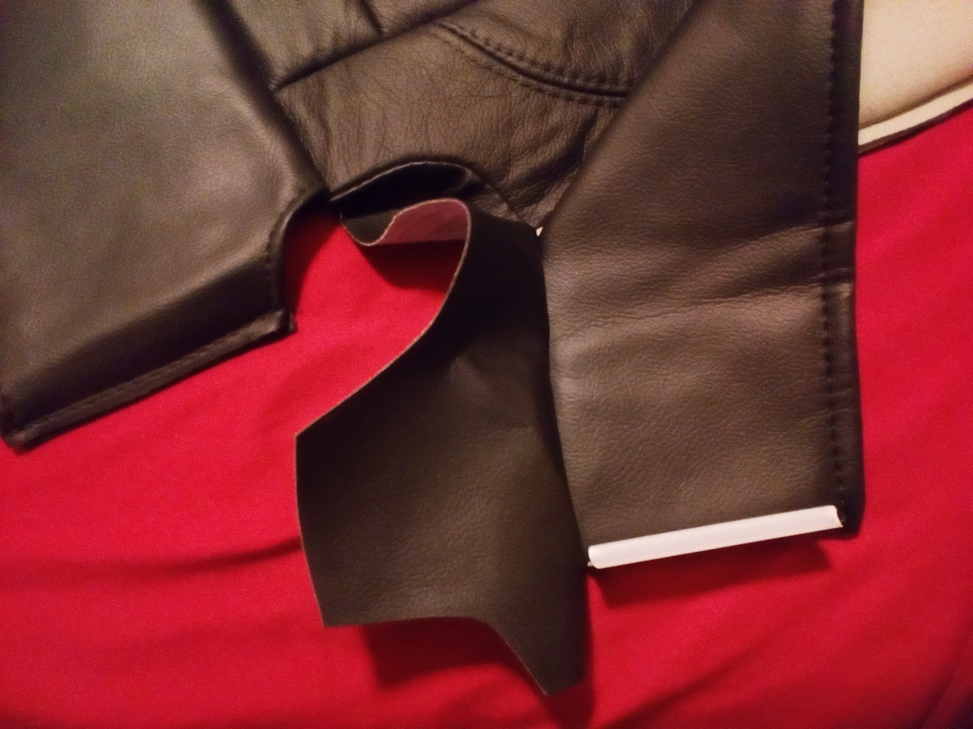

Well I'm talking to the company as we speak. I sent them photos of my oem factory seat covering skin from my passenger seat and it is quite a bit different design from what they sent. Not major but enough to stop me from installing it Tuesday night.
I had the passenger seat all tore down oem cloth coverings off and new leather aftermarket hog ring'd on when I noticed that the panel at the rear nearest the seat belt was sewn completely backwards from Hummer's original design. Its just not gonna work. I'm speaking with the company and may have to send them back. that is the only pattern they make/have and the head upholster is not open to altering there design. Lol! it doesn't match the GM/oem. I was told it should fit with some work.
I can assure them it wont.
Happy Hummer
1,462
Wisconsin

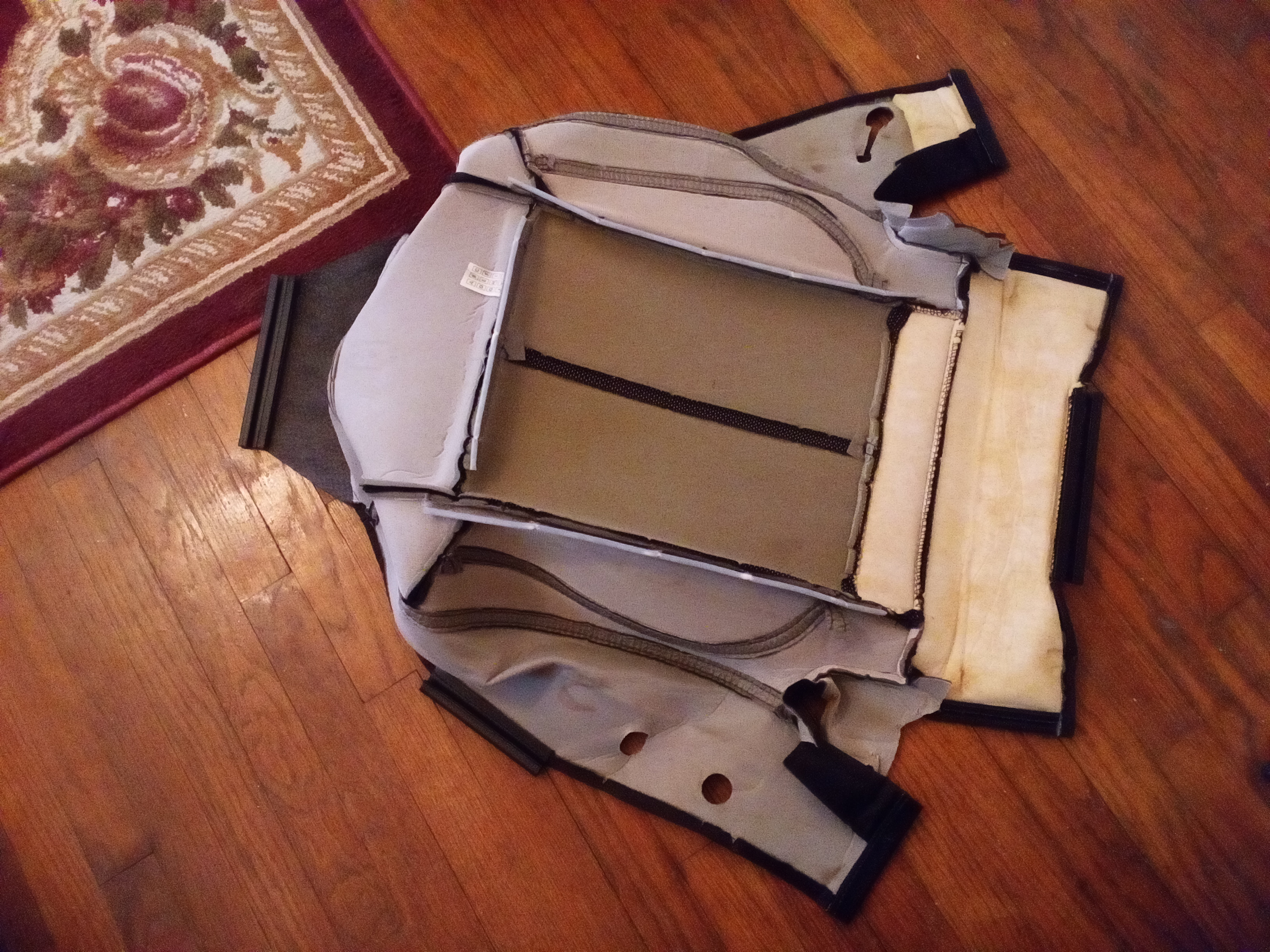

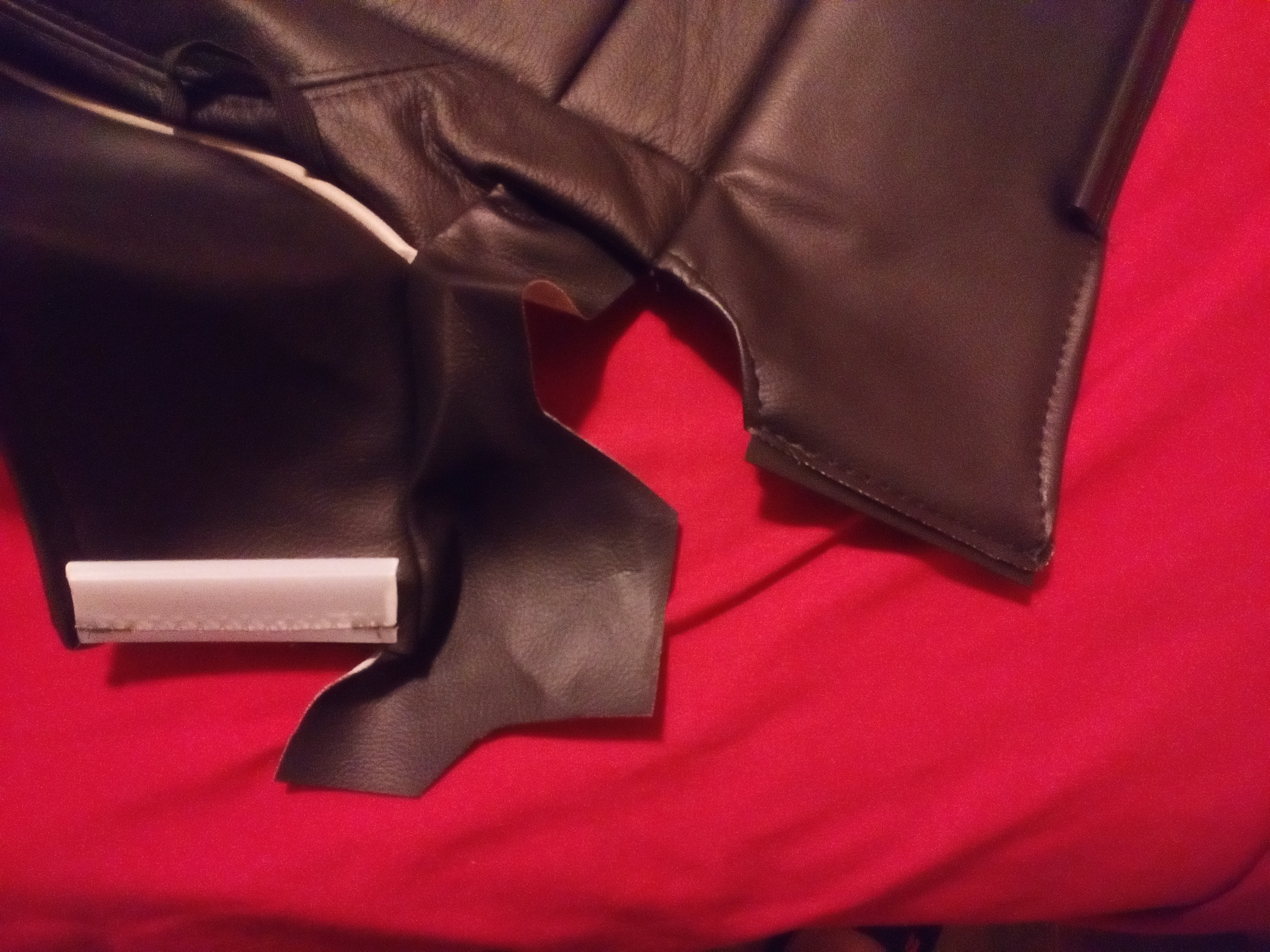

1st pictures are of the aftermarket cover. You'll notice that the flap is sewn to the side.
2nd group of pictures are gm oem and you'll notice flap is sewn to top cover where your bum is seated.
Unless I cut off the flap, reinforce it and re sew to the bum area I'm not sure what else to do. Short of sending them back of course.
The flap needs to be orientated correctly so as to hog ring that flap (3 hog rings for oem on each side) or the back lower section foam will be exposed and there will be no support for rear corners.
Unless you guys have installed this type of pattern successful? Please do say if you have... thanks

Actually, this entire process has turned into quite the let down.
First thing I did was to contact the company and let them know of the concerns and questions.
I received back a reply that the head of upholstery looked at the Hummer/GM pattern pictures I sent and deemed that the product they sold was the only thing they were offering. Lol! I should still be able to make them fit. I responded back that there was zero chance they would fit in the current incorrect state. The reply came with you can send them back for refund. I replied again inquiring as to any hidden fees, restock, etc. The reply was there shouldn't be a problem at least maybe NOT.
So, I was left with a lot of unknowns and a possible restock fee looming if they "maybe , sorta felt like it".
Spent 6.5 hrs. in my sewing room and completely altered them to match the Hummer/GM oem pattern.
Nothing about these covers upon further, deeper inspection seemed quite right. The flaps in the picture not only were sewn opposite of the oem pattern but were completely sh!t. One measured across the fabric 4.25"...the other measured 3.5"...yet another was 3.38"...you guessed the other flap was wrong too.
The oem measures 3" across the fabric consistently with a slight variation.
One cover was sewn across the pattern with more fabric in one panel, whilst the other was smaller.
The foam backing is no where near the thickness of oem. The seams, hems are done to the bare bones standard as where the oem are much more precise and beefy. GM puts an extra layer in the areas that needs the most support. Overall this was just a sh!t show.
Last night I spent 5 hrs. installing the passenger cover alone. Nothing matches up correctly. So, back to the sewing machine and razor, scissors. I even had to bring my die grinder out to widen some areas on the passenger plastic finishing piece. Today, I was able to admire the final product as I installed the passenger seat back in the H3. It turned out decent. That is only because of the hours spent rebuilding portions of there covers to make them work. The plastic pieces they provide to hold to the frame and interior rods and such are barely adequate. They don't even cut them to fit the areas they mount to. That is yet another modification the end purchaser must do.
Overall this product is ok as long as you have some mad sewn skills and lots of patience. Better get real comfy with the hog ring pliers too. lol!
Of course if your on a budget and Katskinz are out of your price range these can be a ok-ish buy.
Honestly scratch that... don't bother lol! They are nice looking after you put hours into remaking them.

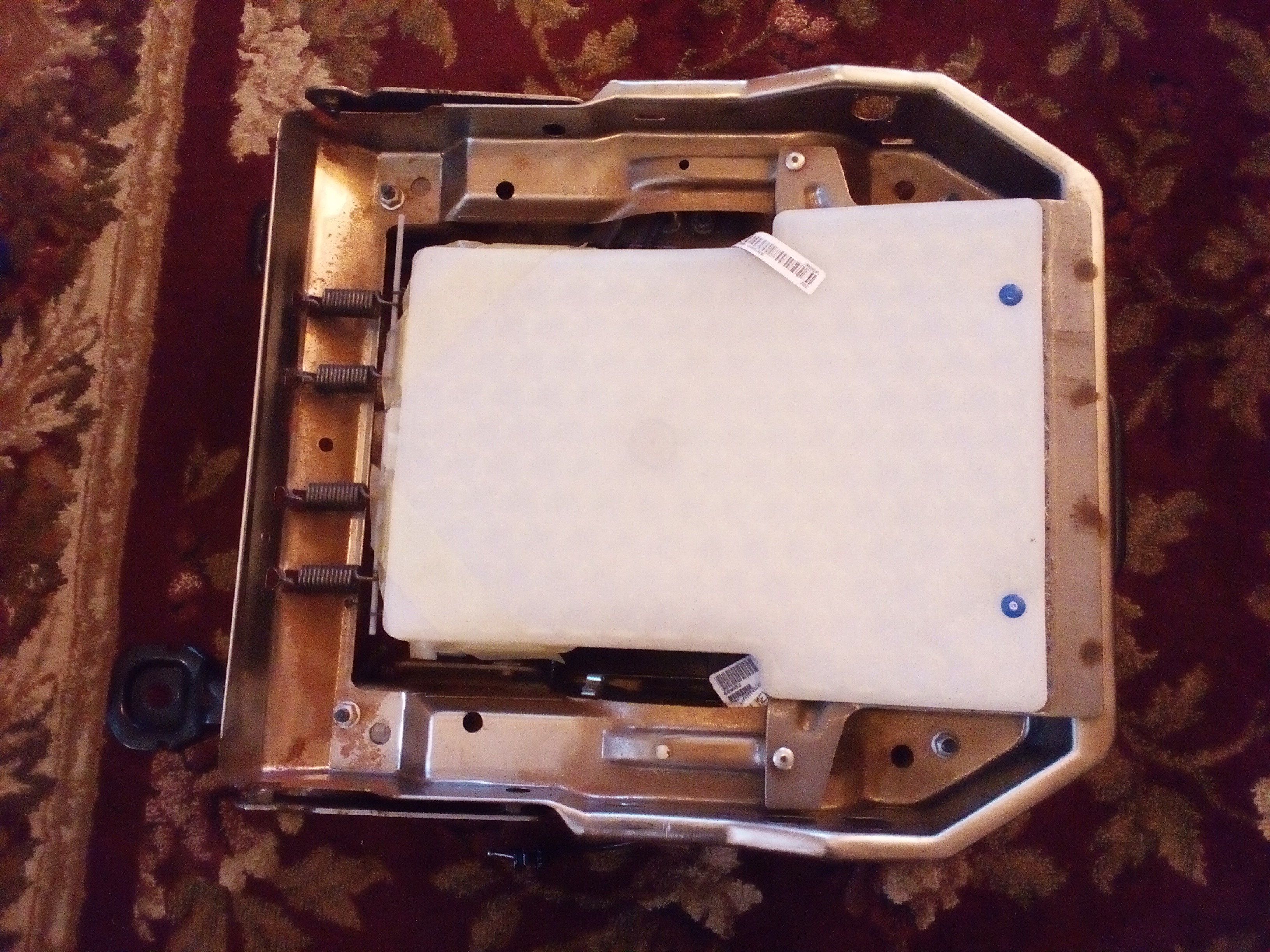

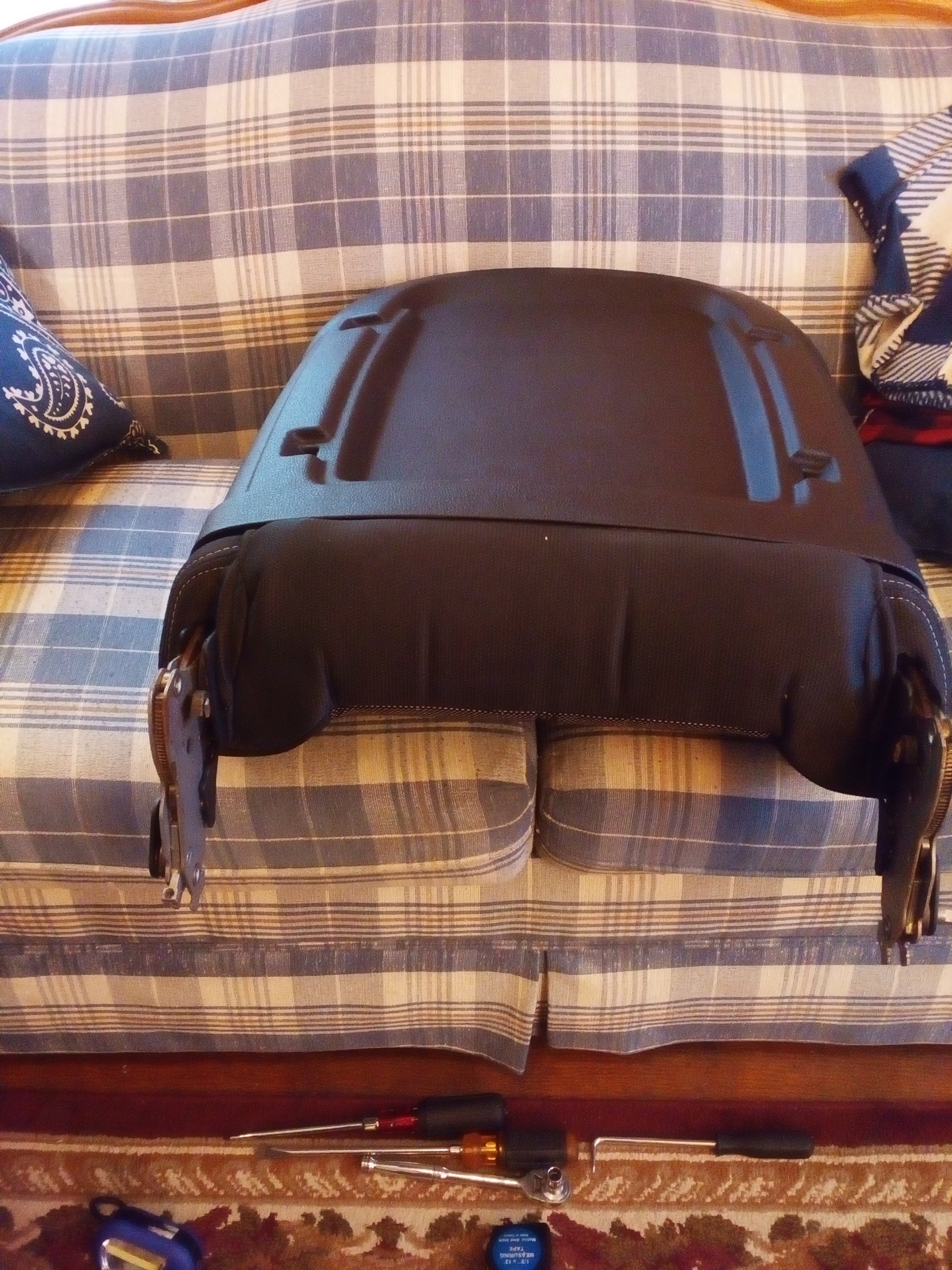

Well, was able to push ahead and get the driver's side seat torn down yesterday. Thank God it went pretty good. There is quite a bit more stuff to address, work around. The lumbar spine support rotary handle mechanism, knob, cable and seat angle adjuster.
Again, alterations were needed and the seat cover/skin was not pre marked or cut for any of the mechanicals.
I'll post pic's soon. Now to do the rear seats. Which I need to decide which way to go. This company does not provide rear covering's.
Please do not misunderstand, the problems with the covers are workable but results are pretty remarkable.
Upholstery shops deserve a at a boy, because this chit is pretty involved and labor, time intensive.
Oh and be prepared for cuts, scratches and snagged finger nail. Oh! The back of the seat (you know the hard plastic shell) is a difficult item to remove and reinstall. There are two large clips directly at top. Two smaller push clips at lower sides and two retainers at bottom.
Here are a few pics of seat torn down...

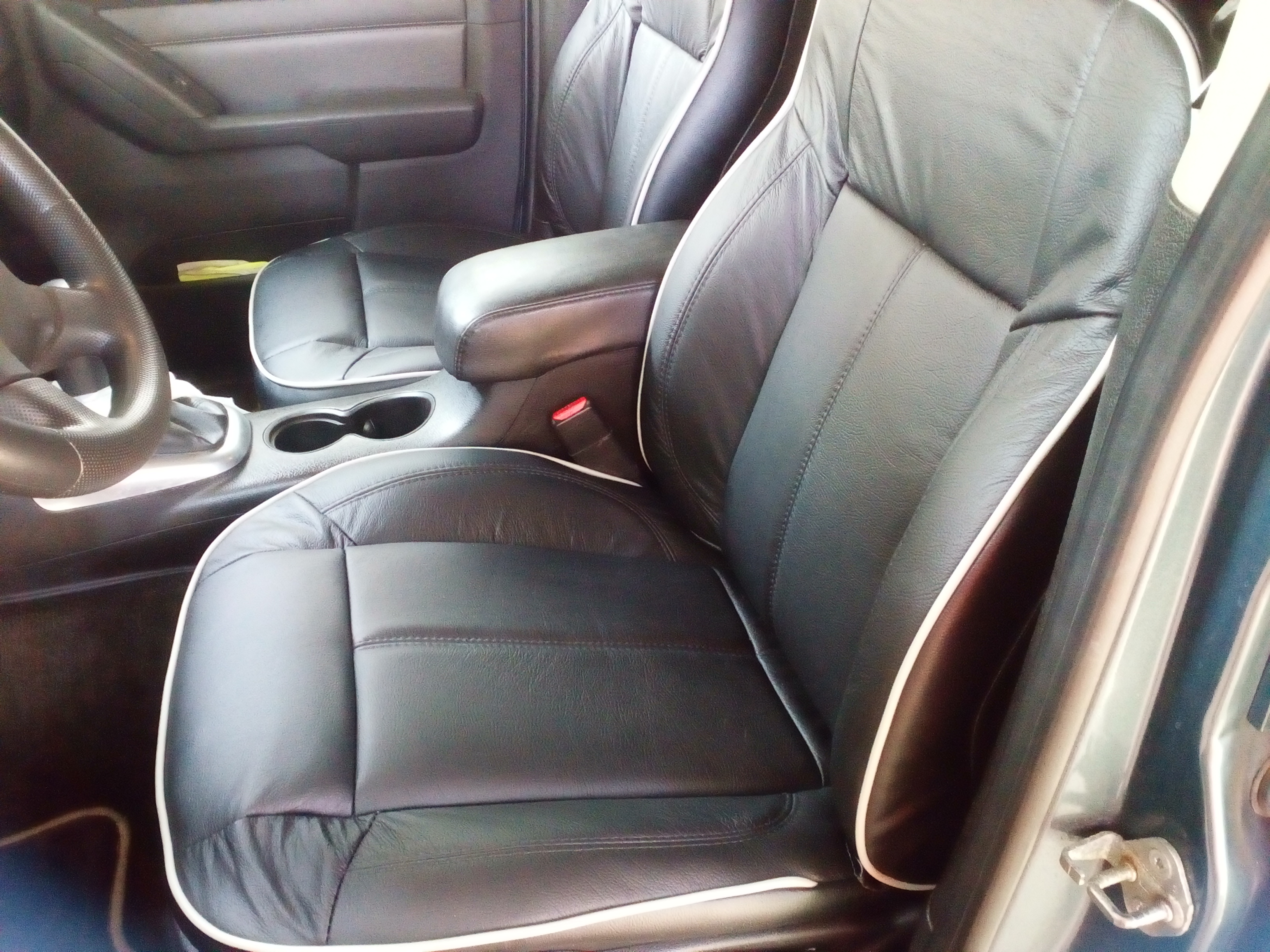

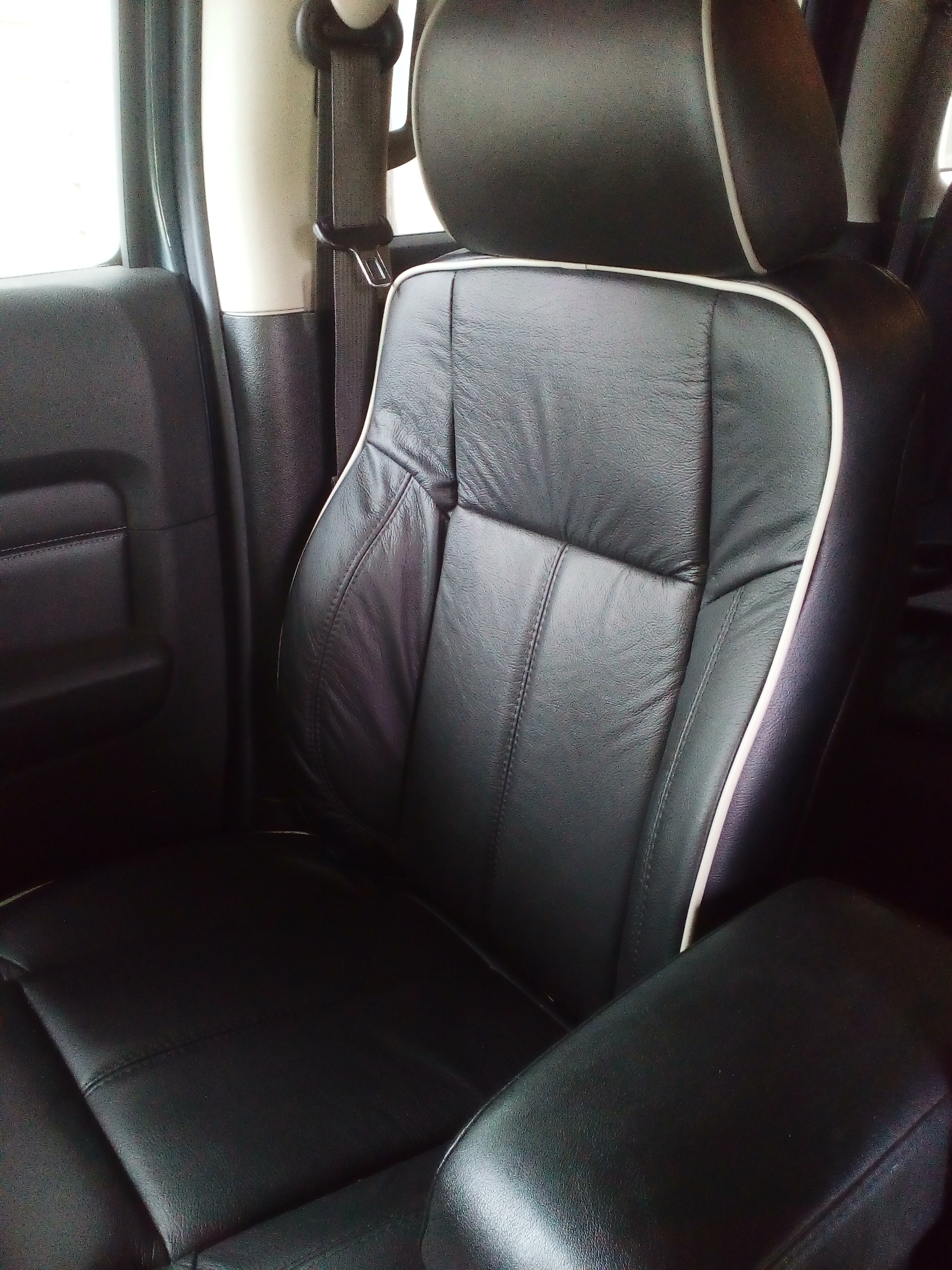

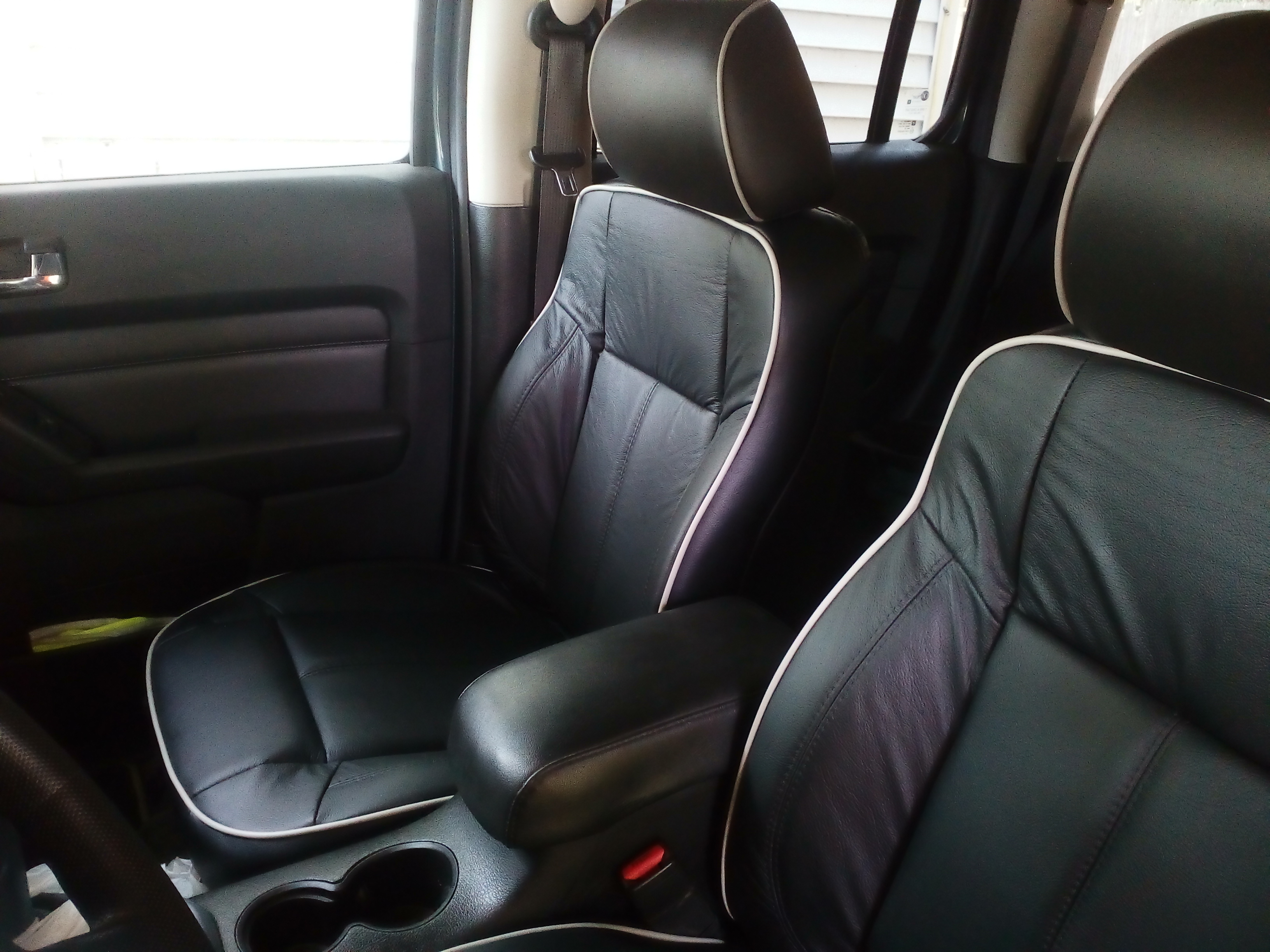

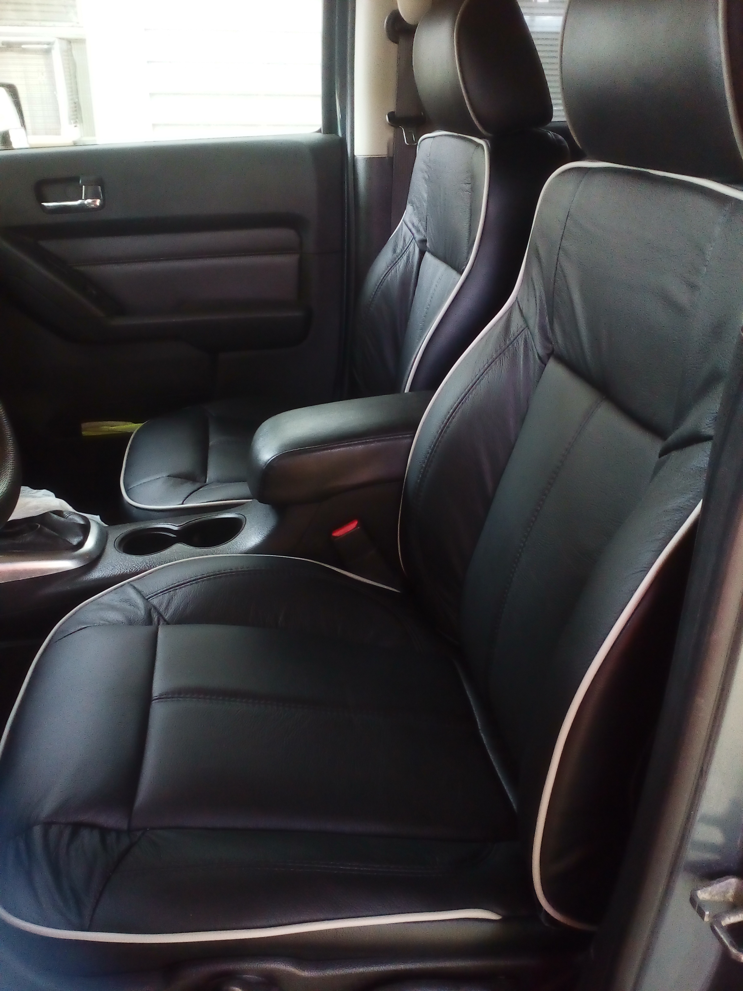

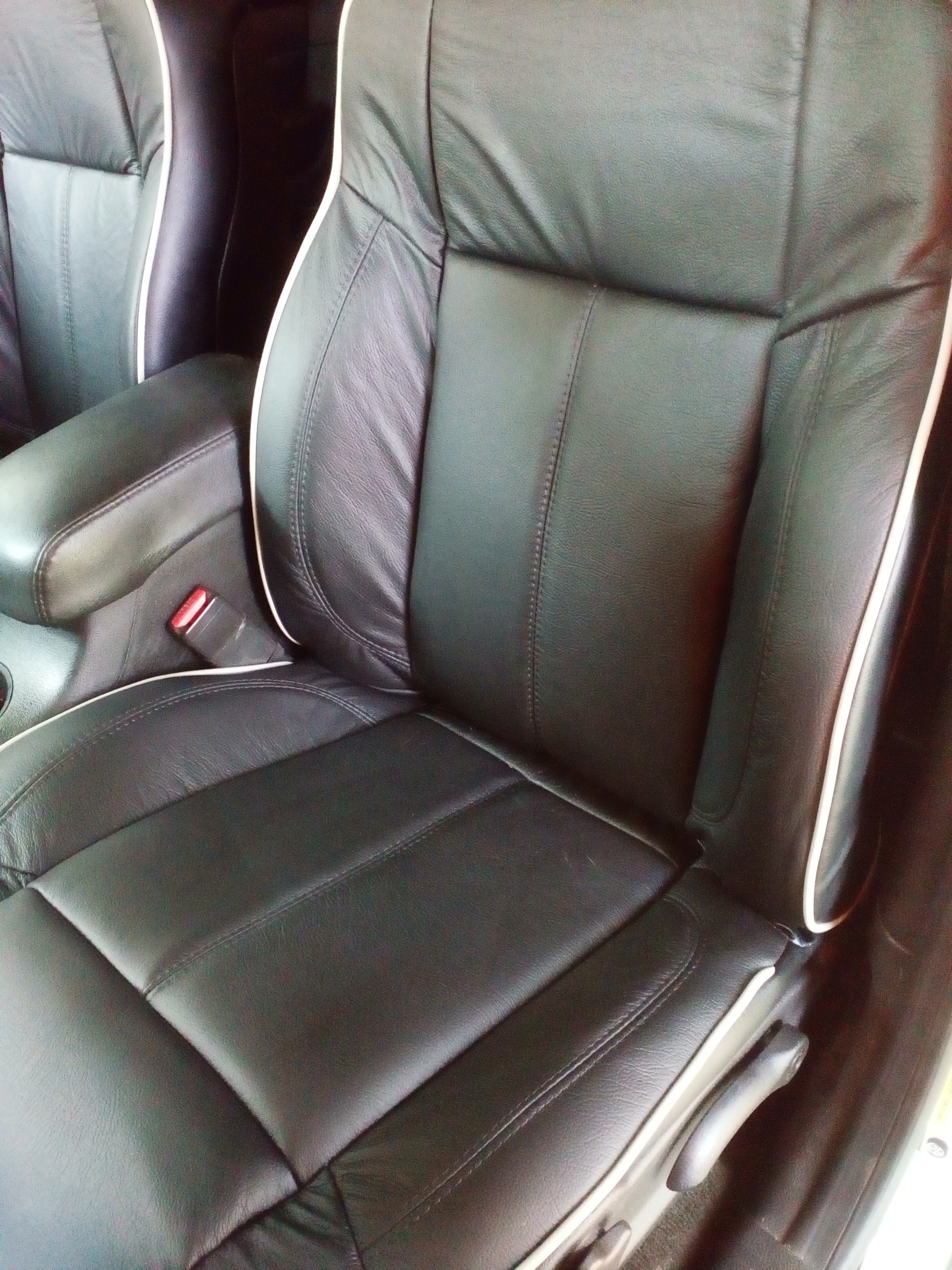

Well finished up today. Gave me a good excuse to vacuum under the seats lol. Smiling!😂 big time. The effort was d@mn near Herculean (for me anywho) but I think the effect comes across good. As promised pictures... I'm gonna leave them slightly wrinkled and fluffy looking because in no time the sun and heat will do there best to shrink them. I have a parking canopy in the driveway and I replaced the tarp portion 1 year ago and the heat a direct sunlight have shrunk, distorted and dry rotted/ripped it everywhere.

I was able last night to order oem upper right, left leather covers/ skins off eBay used. There the same kinda look black/gray piping. Got just the upper. Will keep eye out for lower next. These are for the back seat.

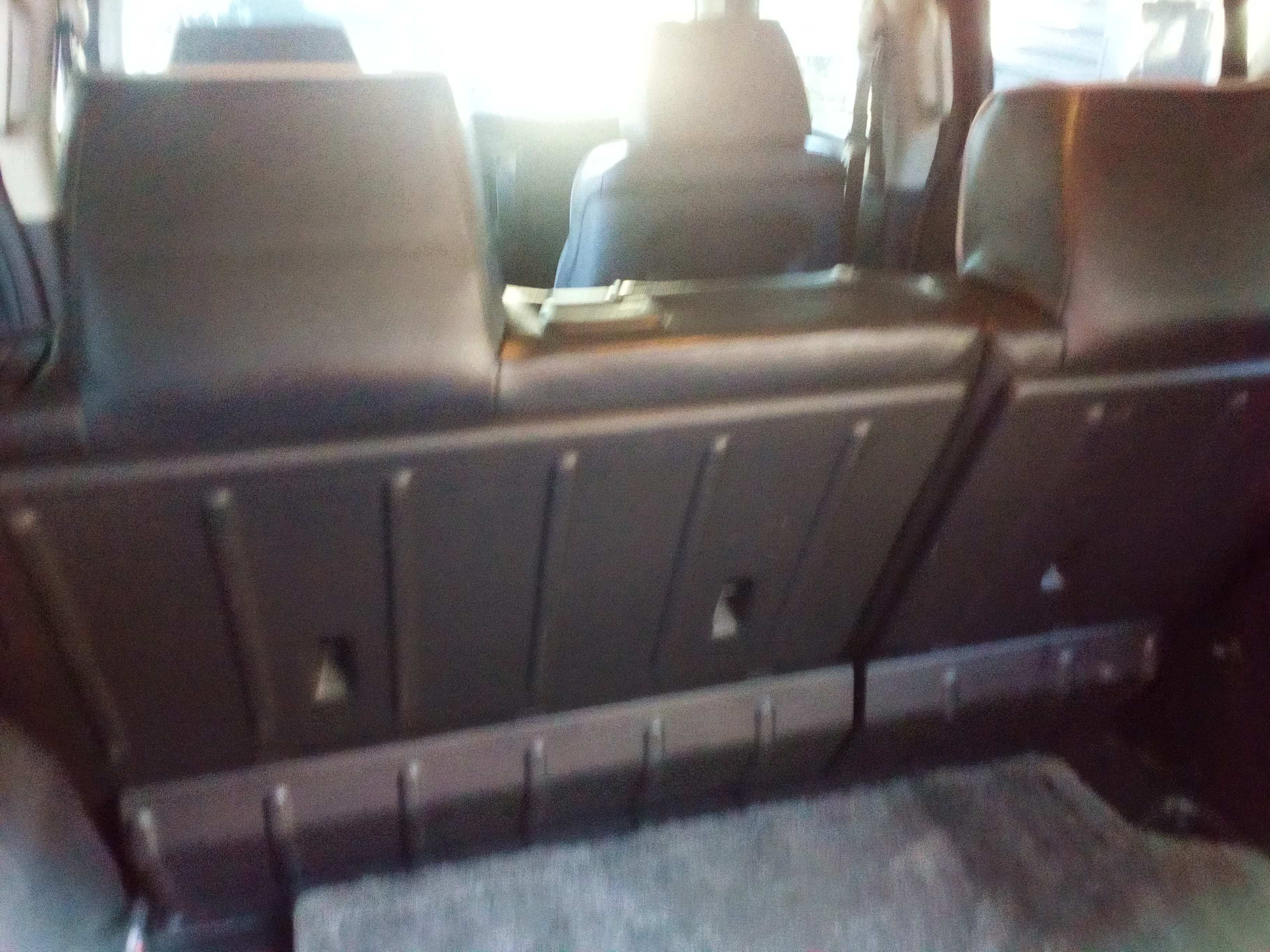

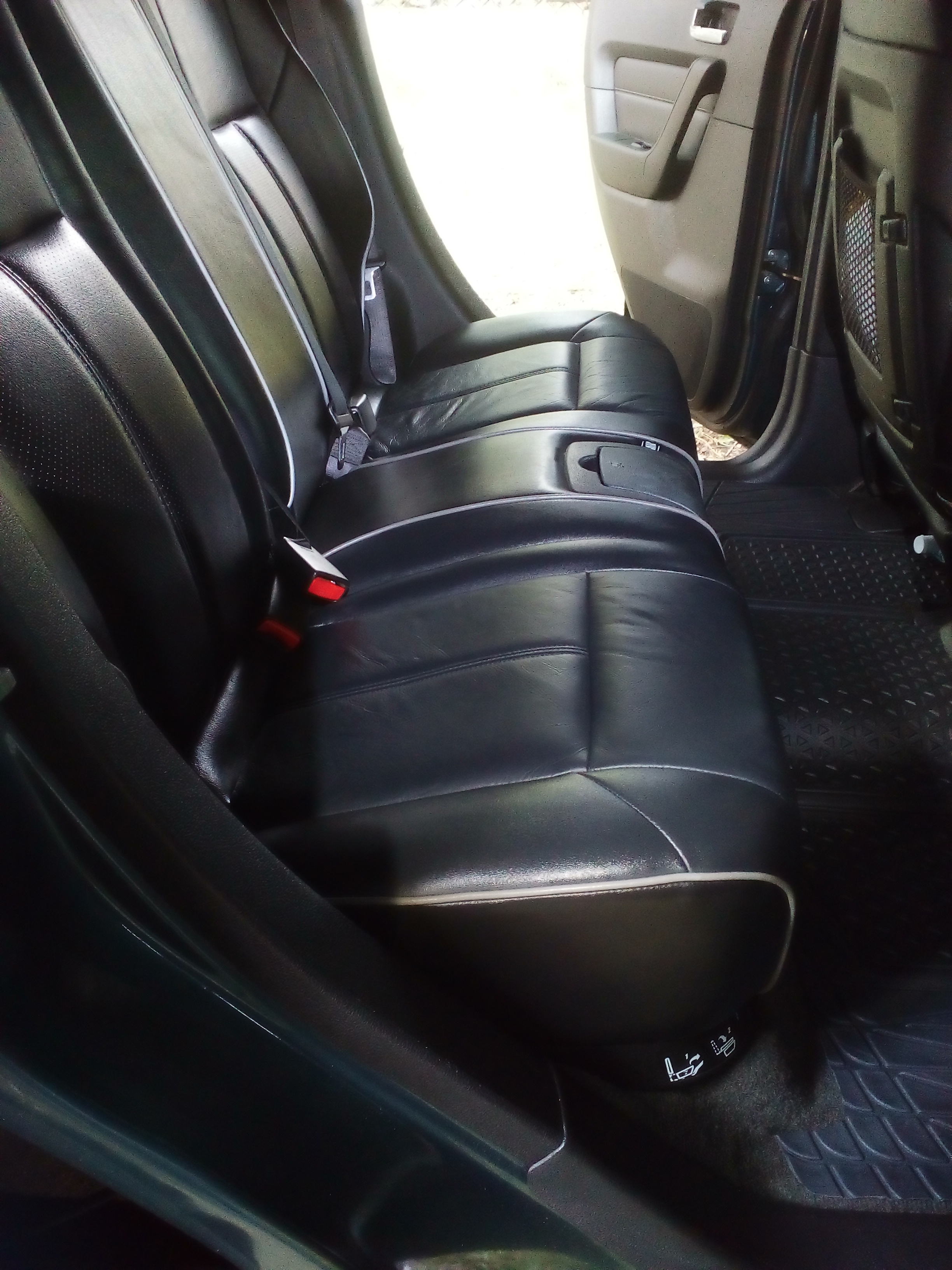

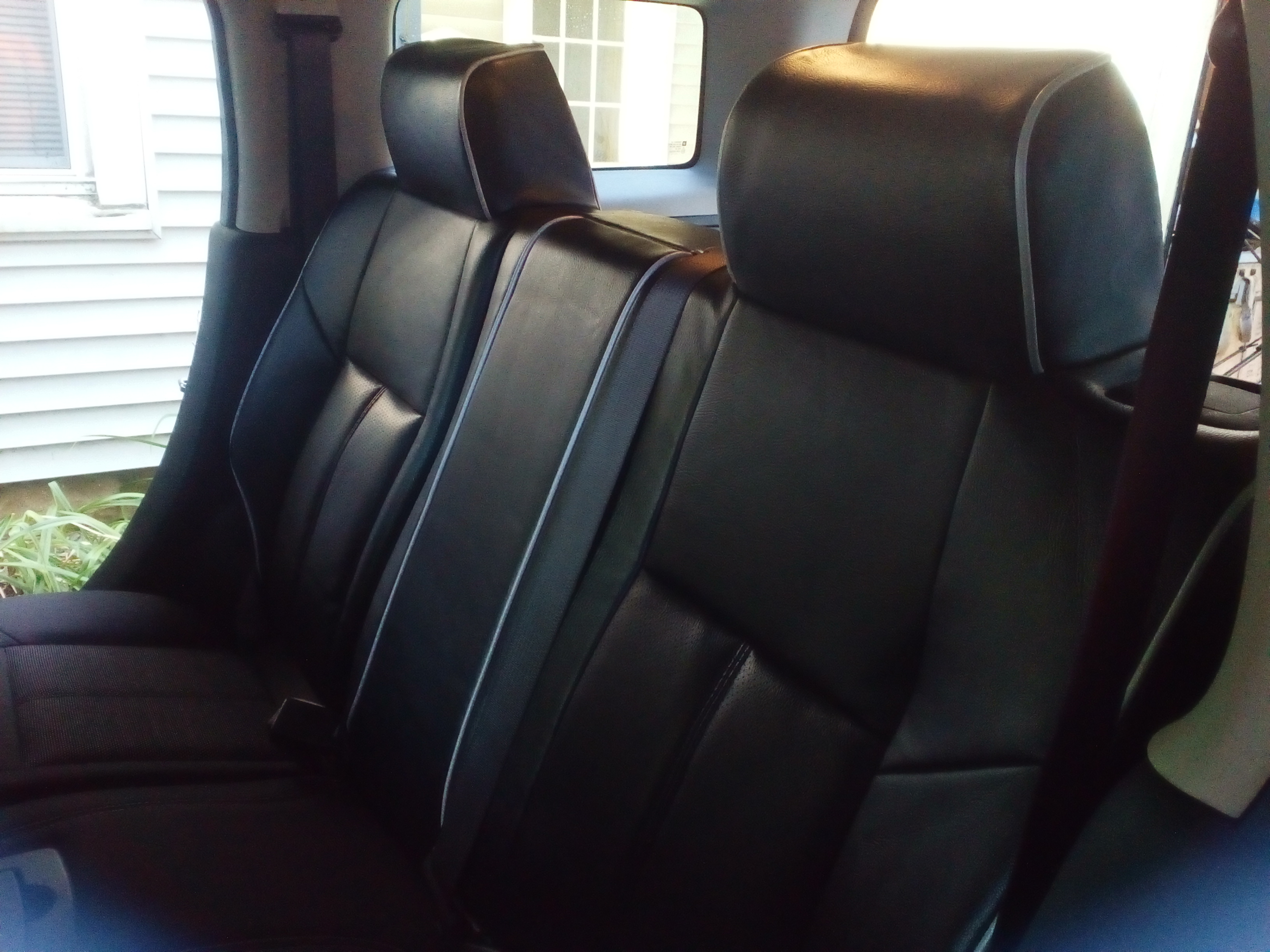

New to me (used) leather upper rears showed up. Nice! In pretty good shape.
Has anyone swapped there rear factory skins/covers??
Happy Hummer
1,462
Wisconsin

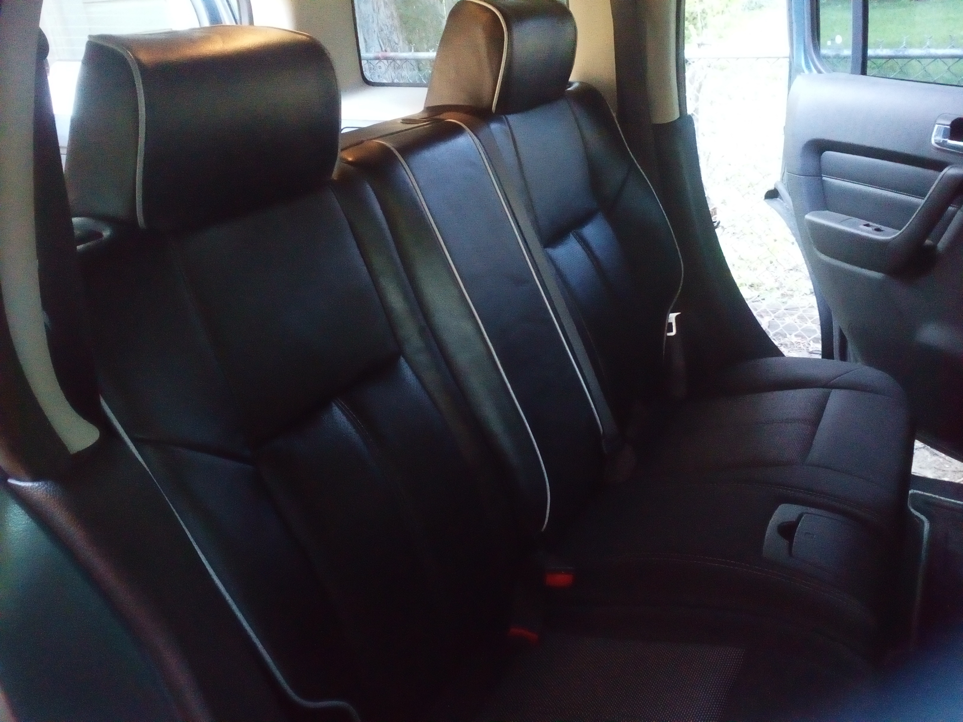

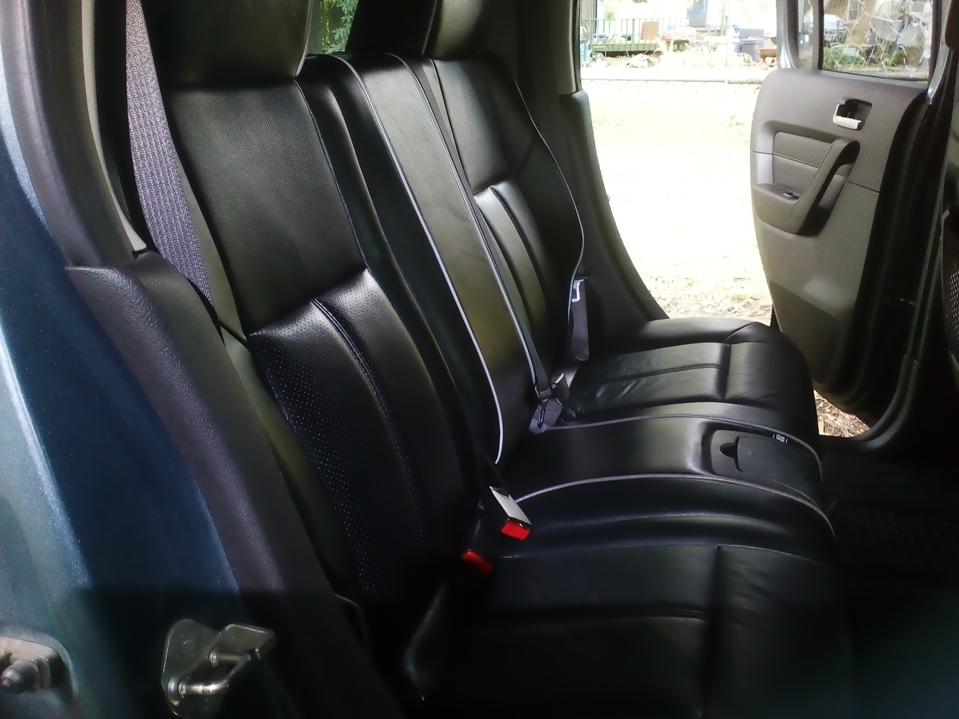

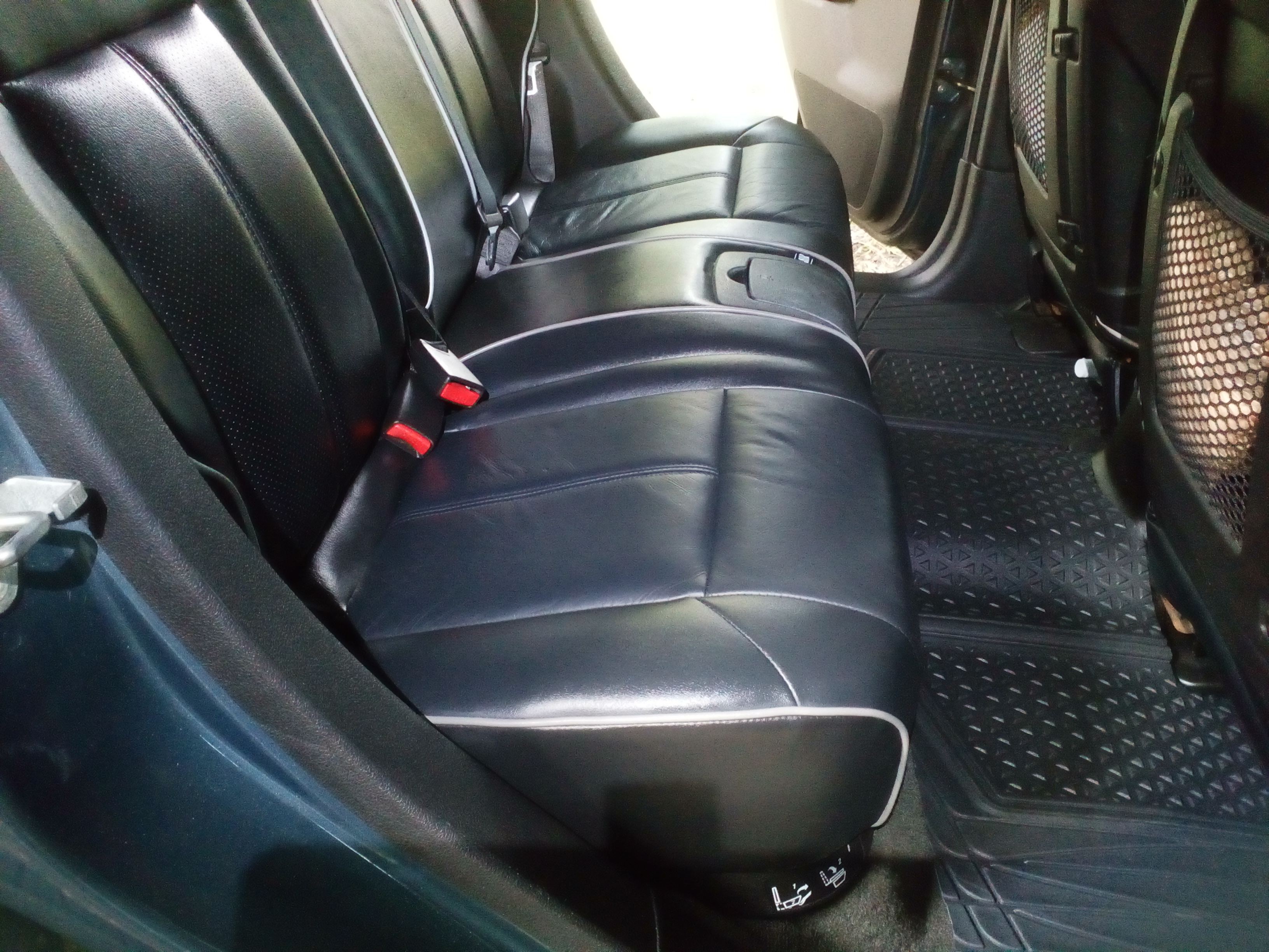

Wanted to update...rear uppers done. Leather is similar but not exact. There was a couple scuffs and a minor blemish (nicely hidden). After installing the uppers realized that the elastic bands were stretched out and resew'n back goofy. Oh well they are really very nice.
Now to get a hold of some bottom rear!?

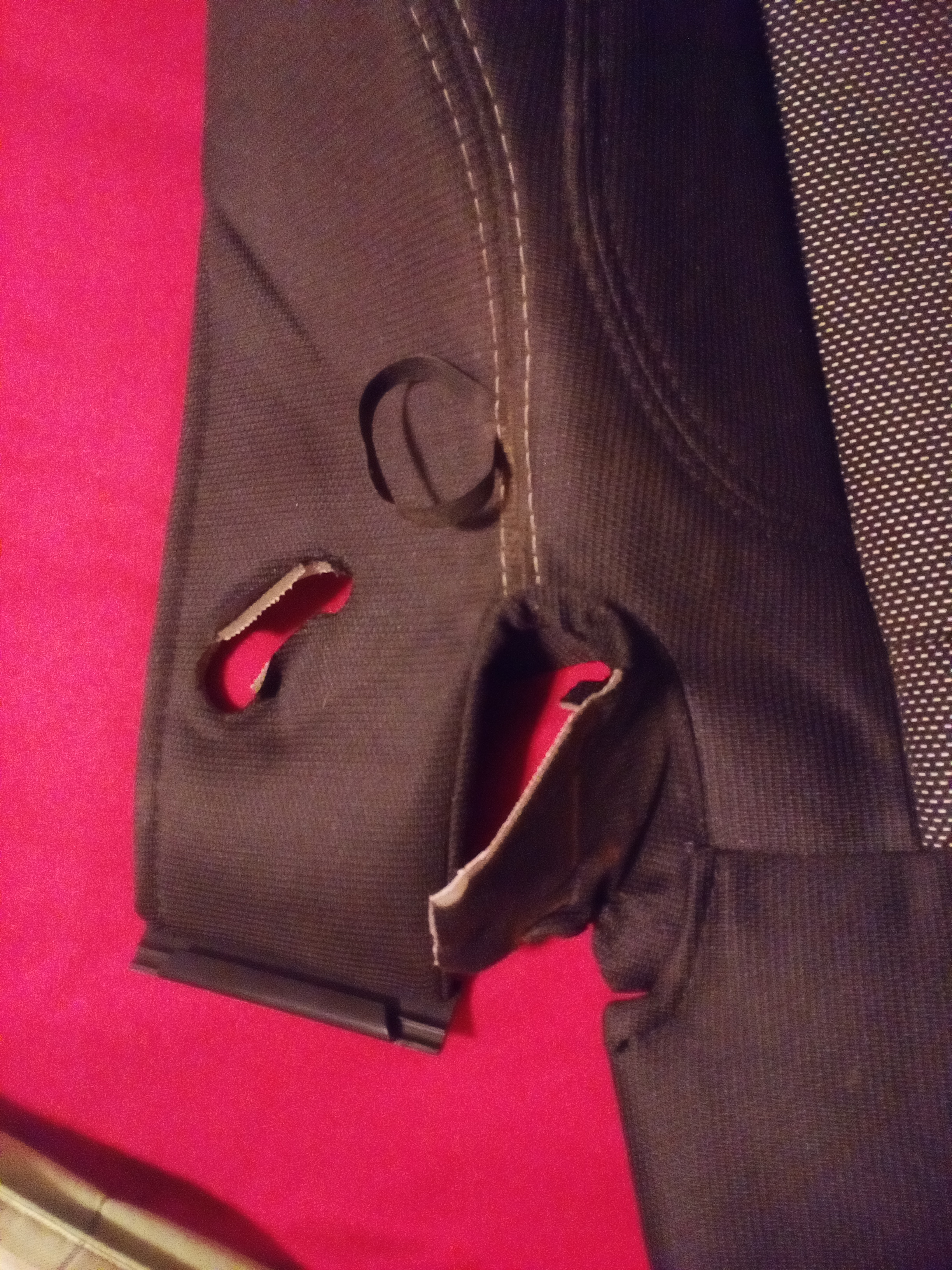

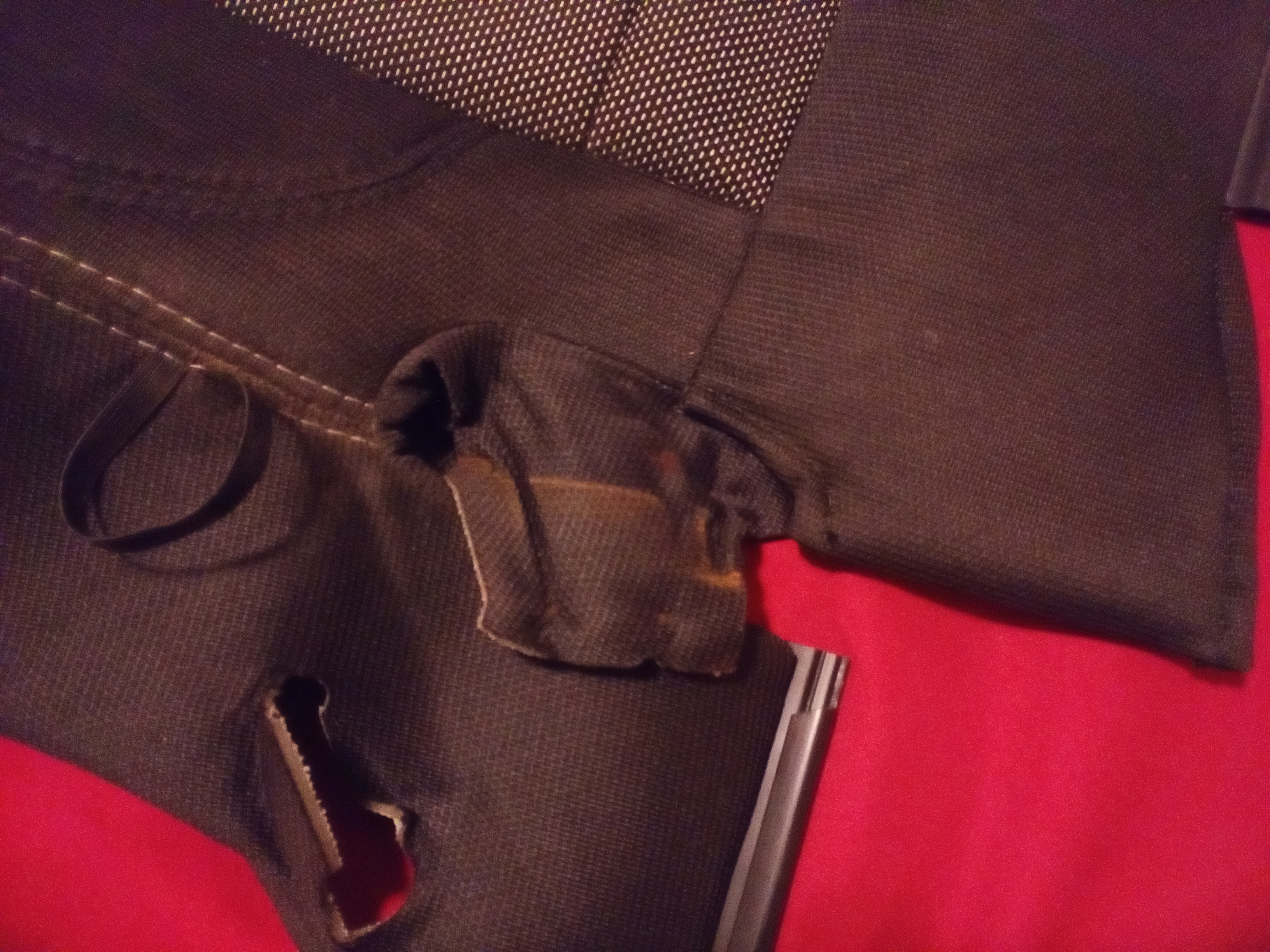

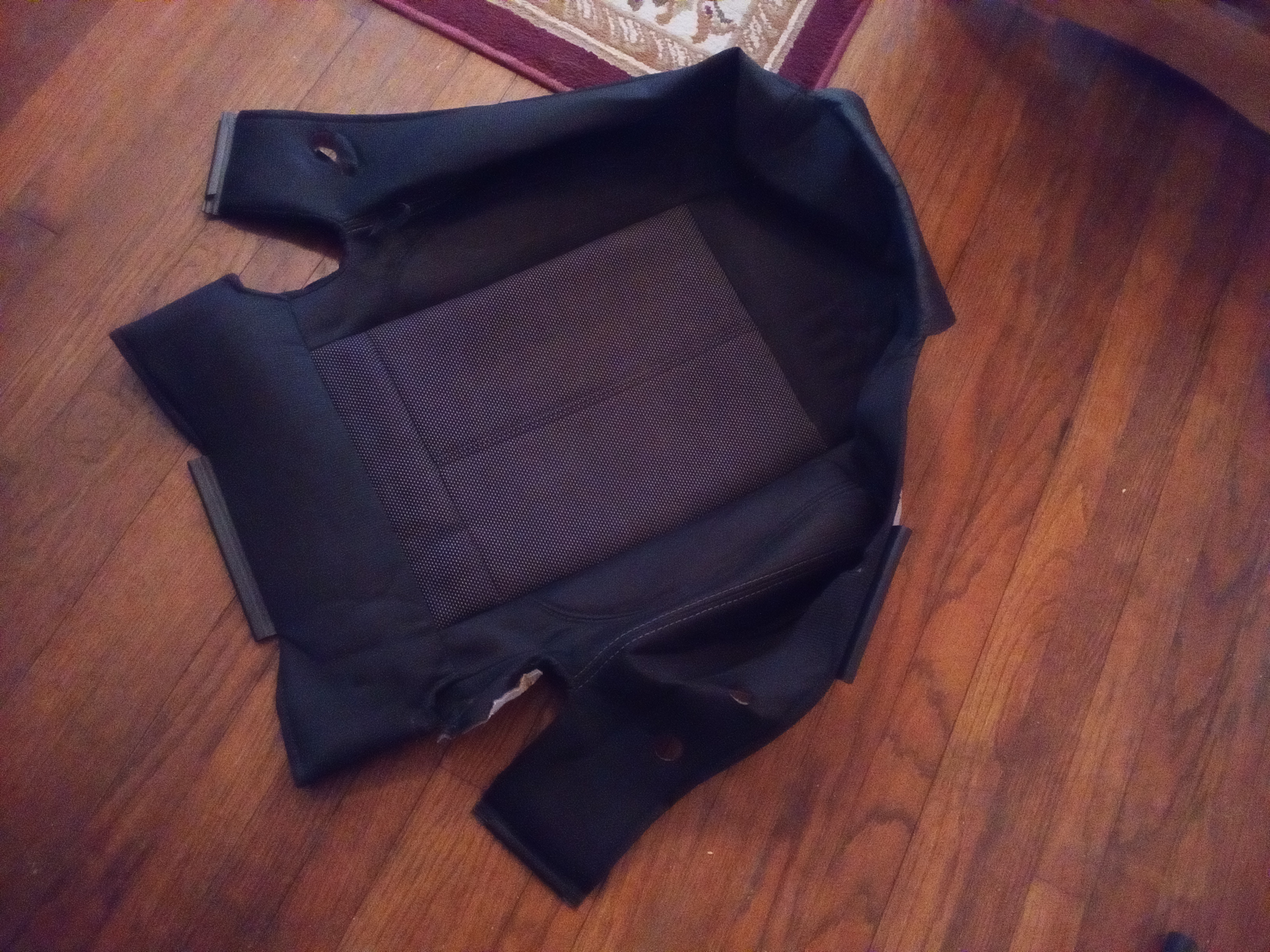

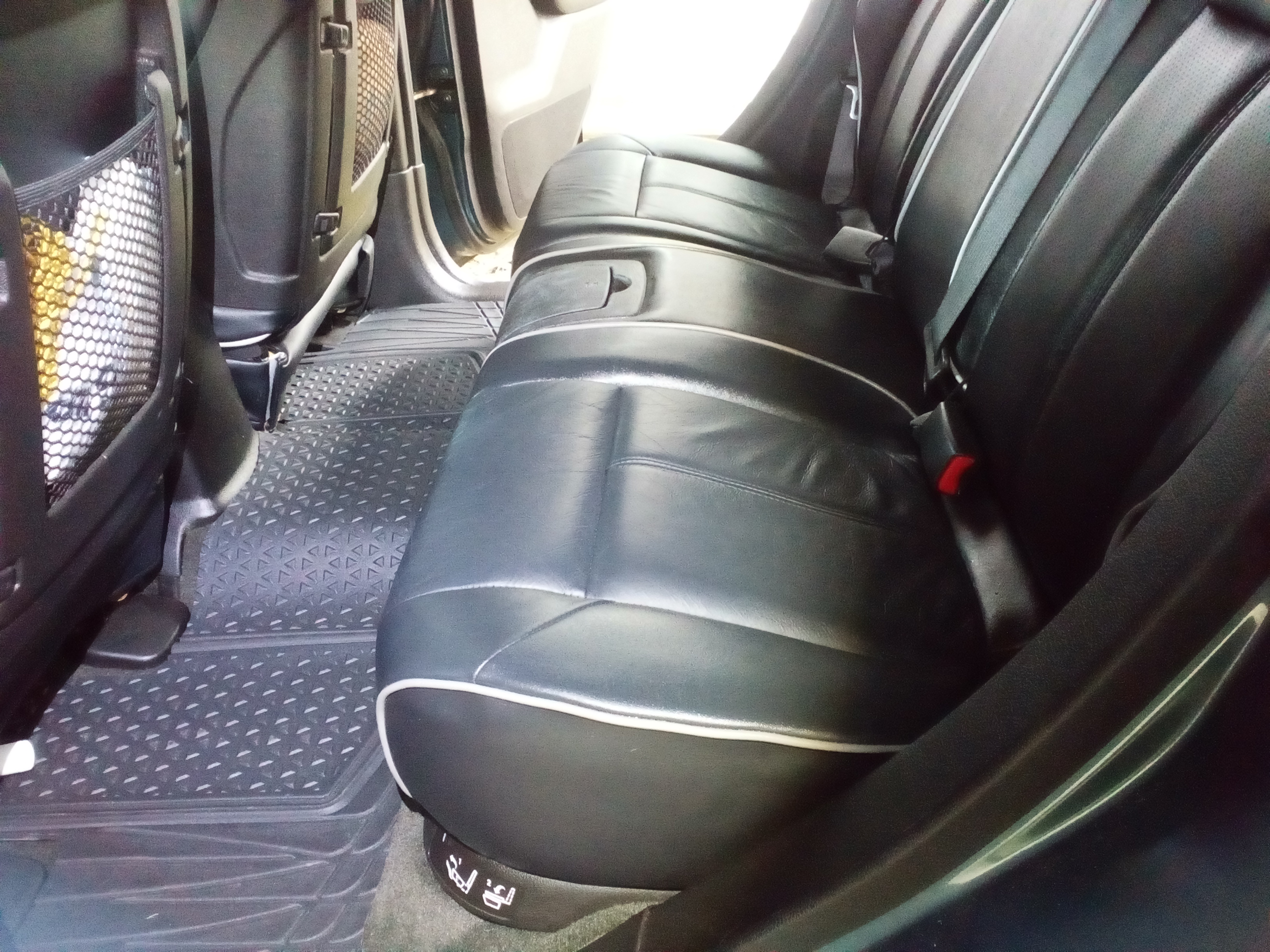

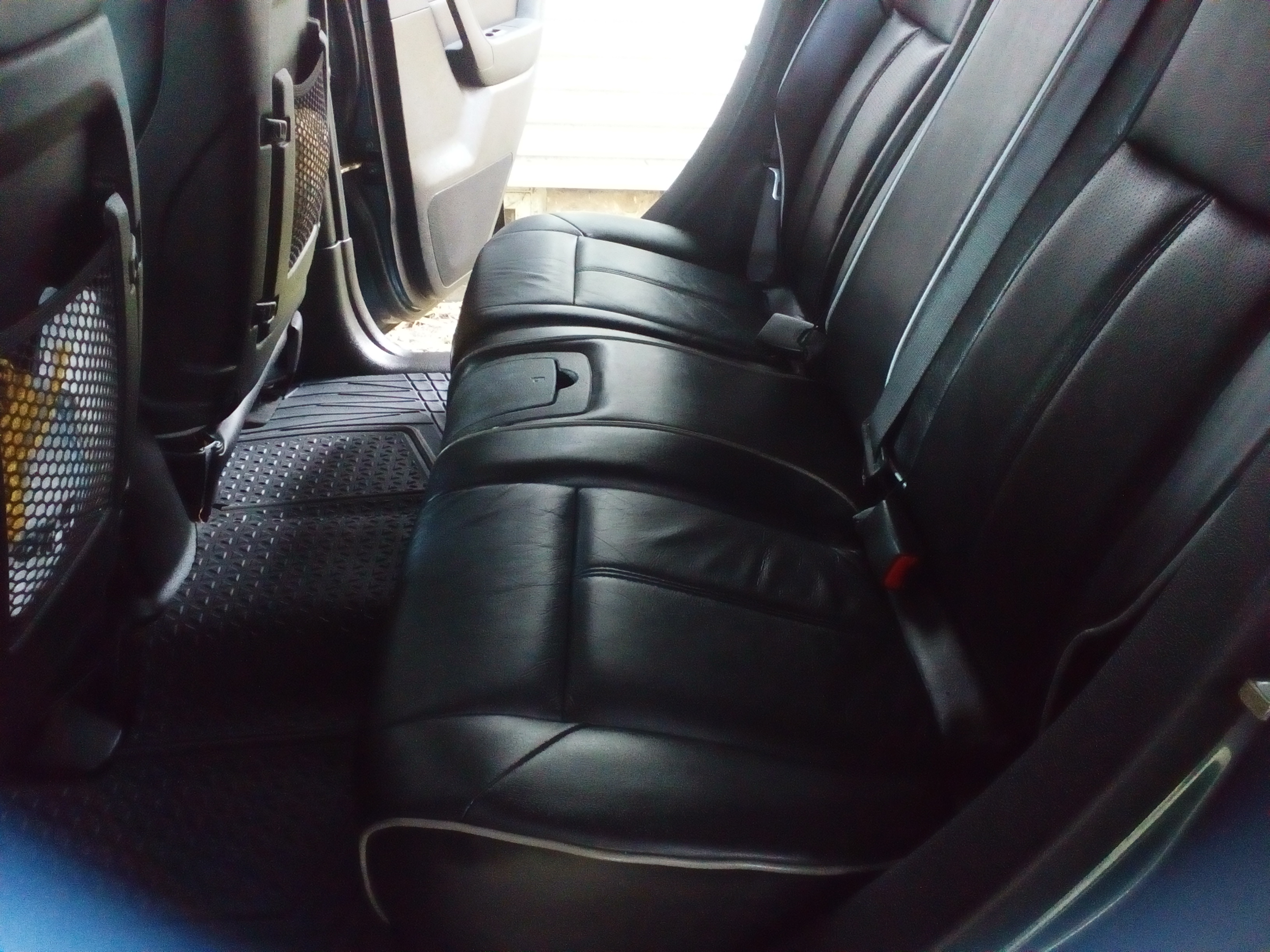

Wanted to update this thread...

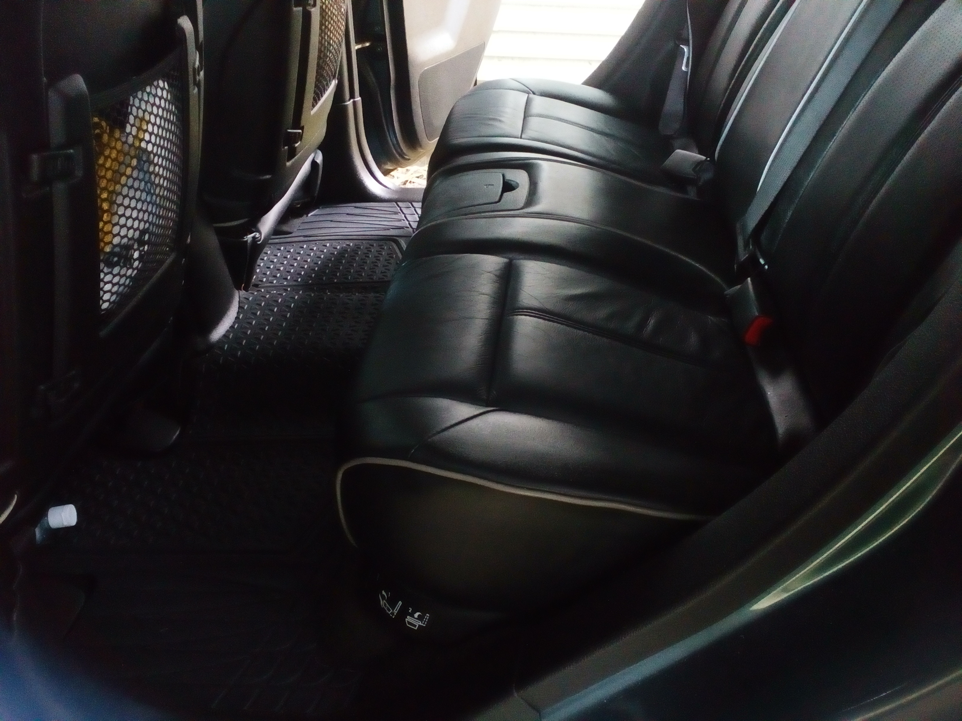

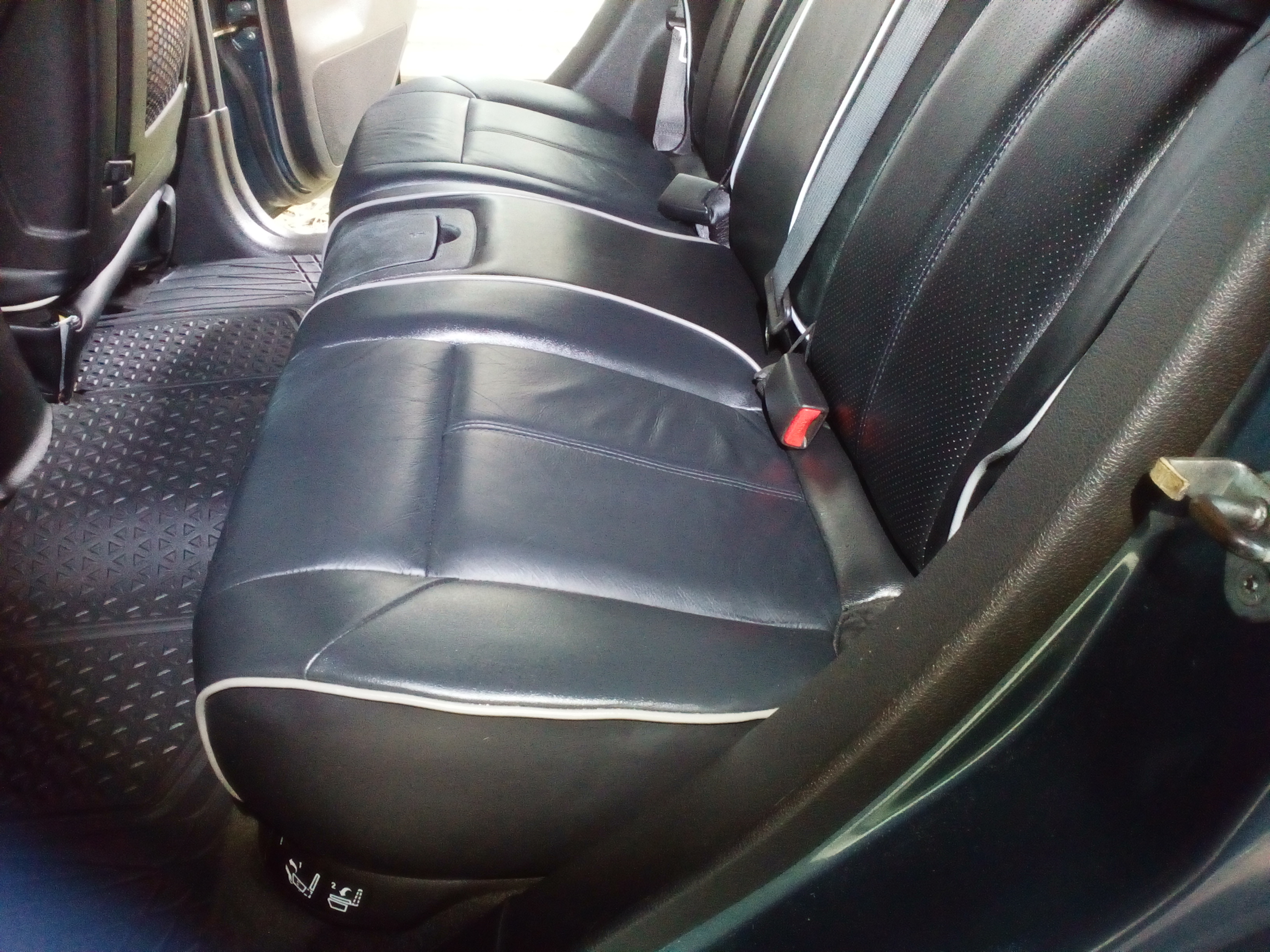

Finally completed the search and purchase of lower back pass, drv seat bases, bottom's.
They were shipped really fast and actually were in OK shape, save for some damage, rips and gouges which I knew about. Well at least for the most part.
Took the seats apart and made multiple repairs. Quite the interesting process.
Here are some pics...
