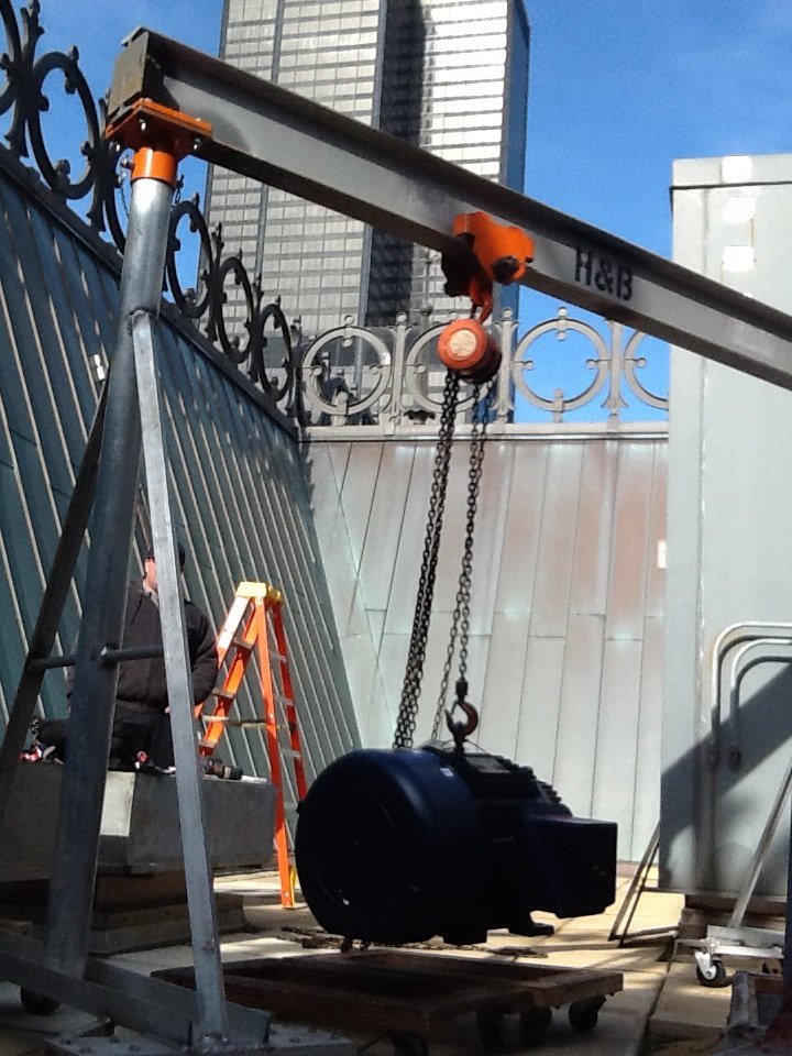

My vote is for the 3.7. Pics of a gantry set up Mr speed speaks of. You can rent them in all sizes. This would be the easiest set up for your lifted rig.

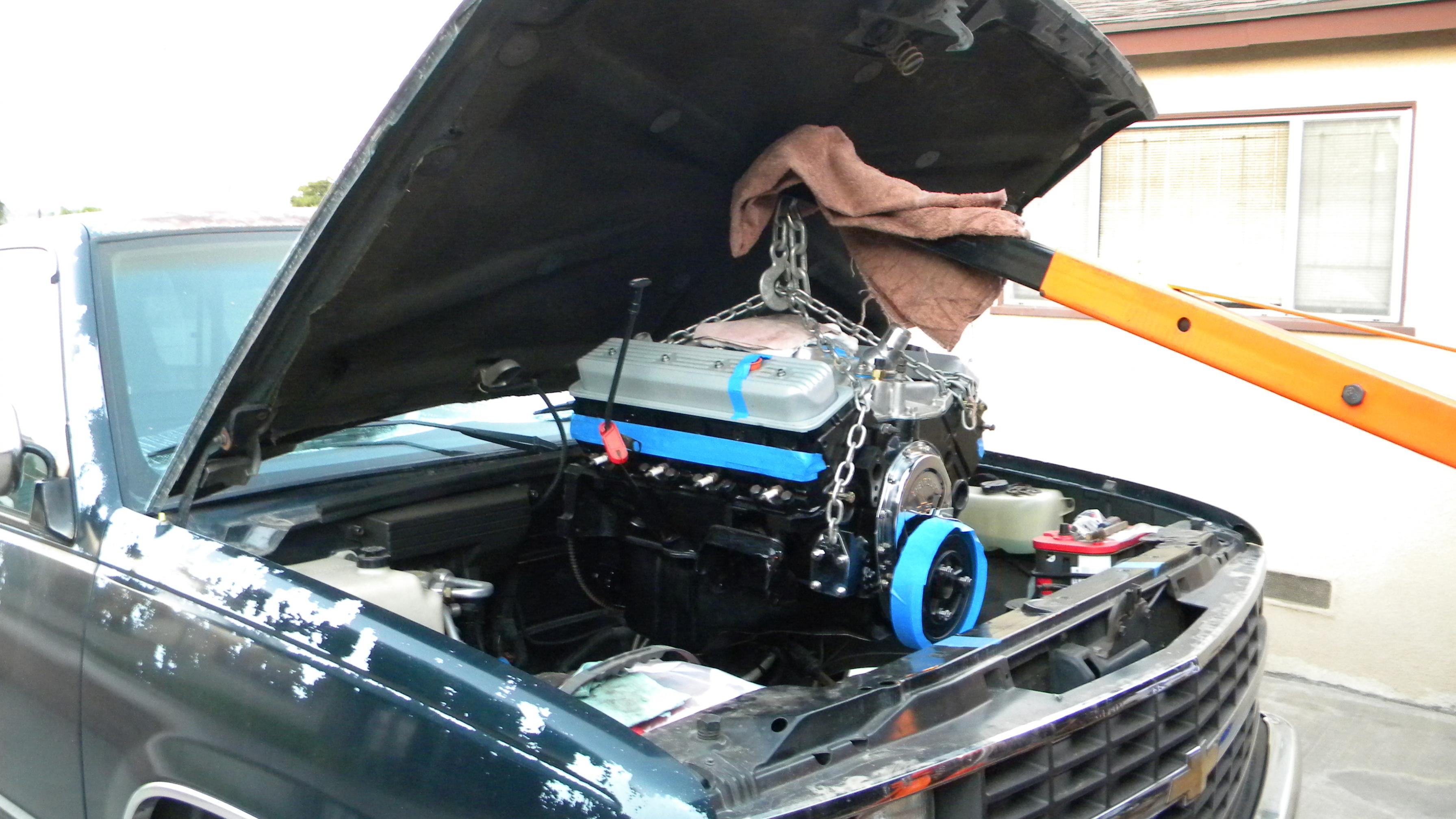

This is my '89 K1500 EC two years ago. My front wheels are on Rhino ramps. My 350 dropped right in and I had plenty of height to clear the radiator support. I left the hood in place as well. I didn't overextend the boom on my hoist since I did want to pay attention to the load limit. I shouldered the hoist and manhandled the block to get it in place myself and I'm twice as old as a lot of you.
A 3.7L in an H3 should be a piece of cake for young guys like most of you. Biggest hassle is the trans and transfer case since it has a tendency to
roll to the heavy side once it's unbolted from the engine.
