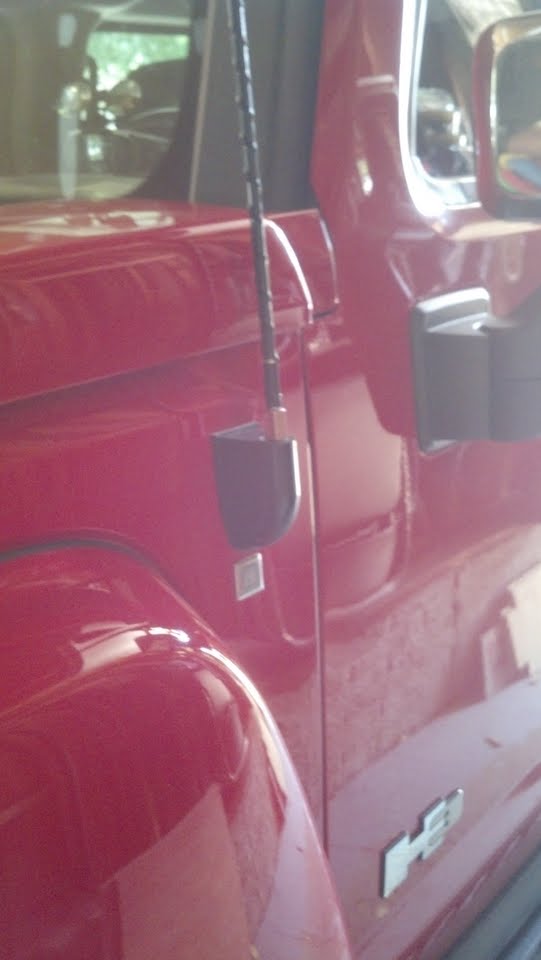

View attachment 6317View attachment 6318 I used the side mount by firestick. It looks like a factory mount
I also copied the Firestick side mount idea from Cbetts. It emulates the stock antenna mount of the passengers side and looks like it belongs there. It is also low enough that I can pull into my garage with banging the top of the garage door.
I wish I saw this option when I was looking different setups! This looks so clear, deff my favorite!
