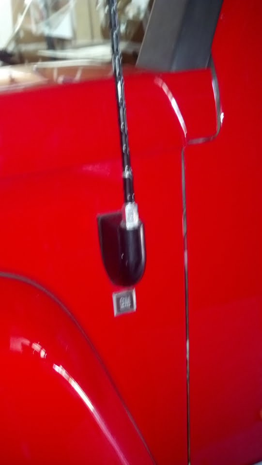

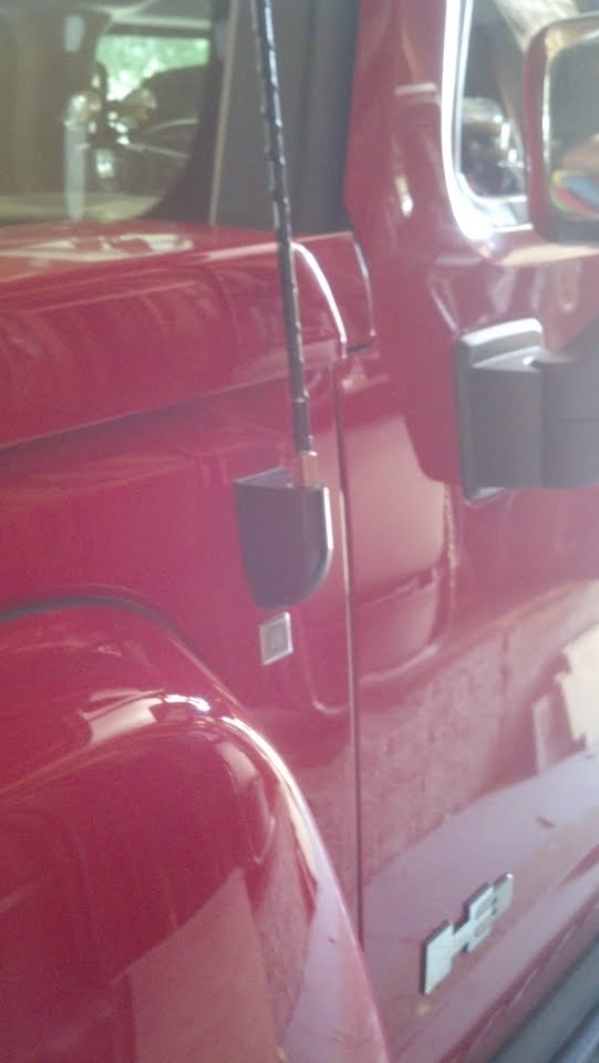

I also copied the Firestick side mount idea from Cbetts. It emulates the stock antenna mount of the passengers side and looks like it belongs there. It is also low enough that I can pull into my garage with banging the top of the garage door.

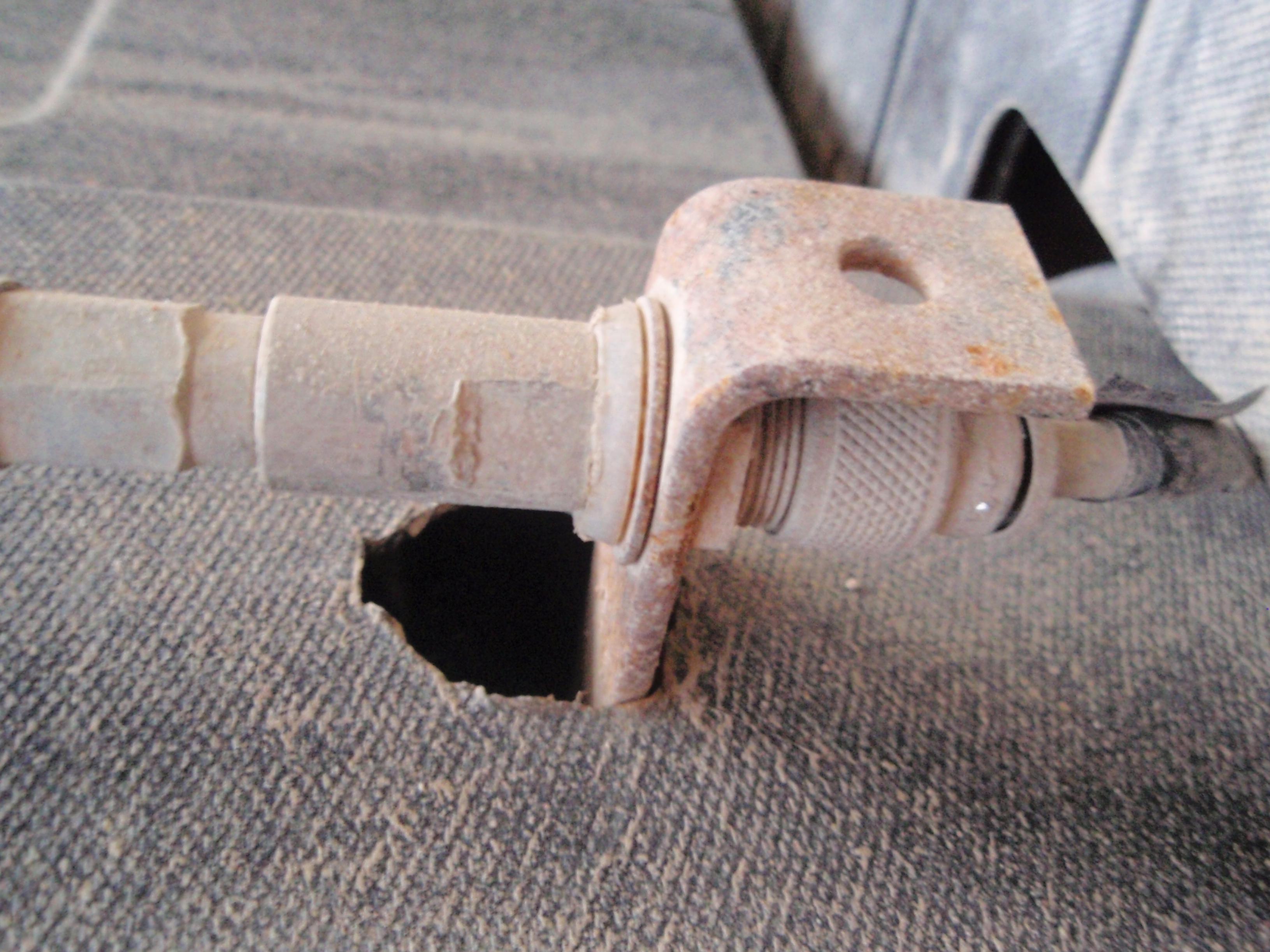

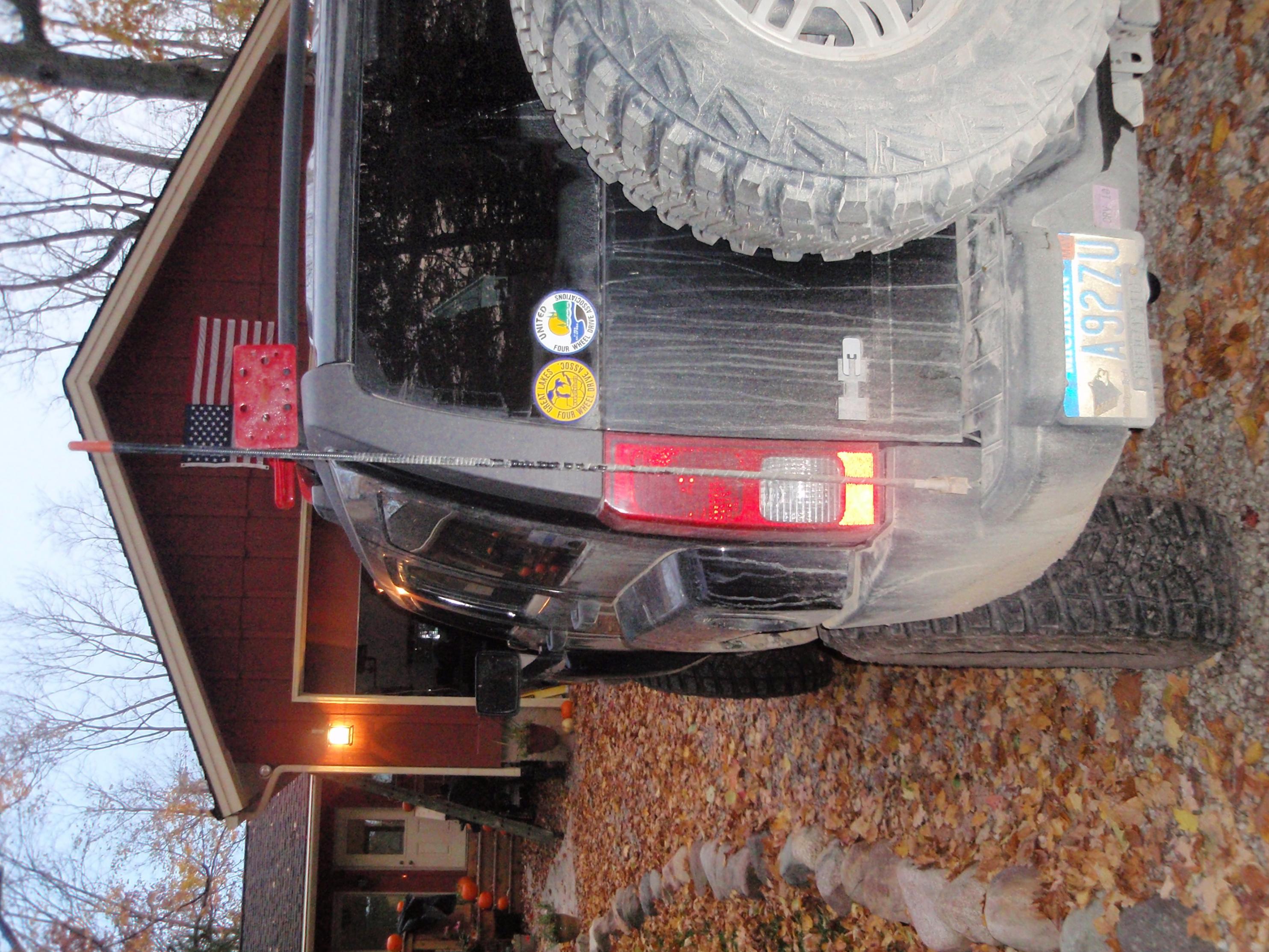

I have mine mounted on the back. Under the tail lights is a small cap you can pop off and a small 10mm screw. Bent up a bracket and ran the wire through the cab. Been there for 5 years straight. Not a problem

I like mine mounted on the fender but as everyone has said, it does cut down on my range. If you want to talk to other people on the highway, I recommend a higher position like a roof rack or spare tire mount. If you park in a garage, you can add a quick-disconnect for easy removal.
