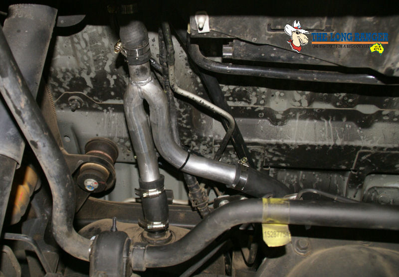

But u can always do "independent" auxiliary tank.
I can confirm the LongRanger for the H3 are independent Aux tanks with a transfer pump to the main tank. (but they have a common filler to ensure all tanks fill evenly)
