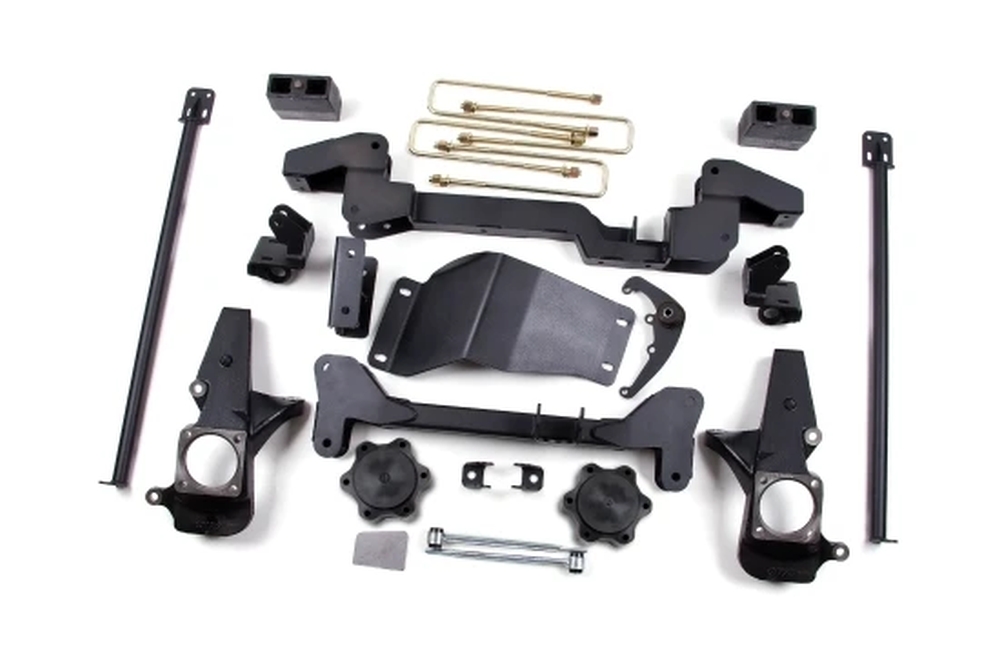

okay, so now I'm curious
here is the compared H3 stock spindle to the H3 lift spindle (from four wheeler magazine)
the 2000-2006 avalanche suspension knuckles and lift
what's interesting to me, is the torsion bar avalanche knuckles look very similar to the H3 and the rub is the whole kit costs $1000.... (this kit is for a coil spring suspension)

That kit wouldn't fit. The knuckle design isn't even close to what the H3's are. As well as the other components, based of that picture.
not sure why you say that - you did notice that the 1st picture, the knuckle is facing down, and the other pictures the knuckle is facing up? As for the other parts, I bet they'd have to be narrowed - but that's easy.
I'm talking about one made for a 4wd colorado, not an avalanche.
I know that - but the Colorado kit's knuckles are not the same as the H3 Hummer, however, it appears the avalanche knuckles are.
Cajun_Tiger_Hummer
428
Lafayette, La
The B.C. patterns on the knuckles don't look the same as the H3, as well as the ID. The geometry and the angles of both knuckles are different as well. Similar in look but very different from a engineering stand point. That's just my opinion :)
