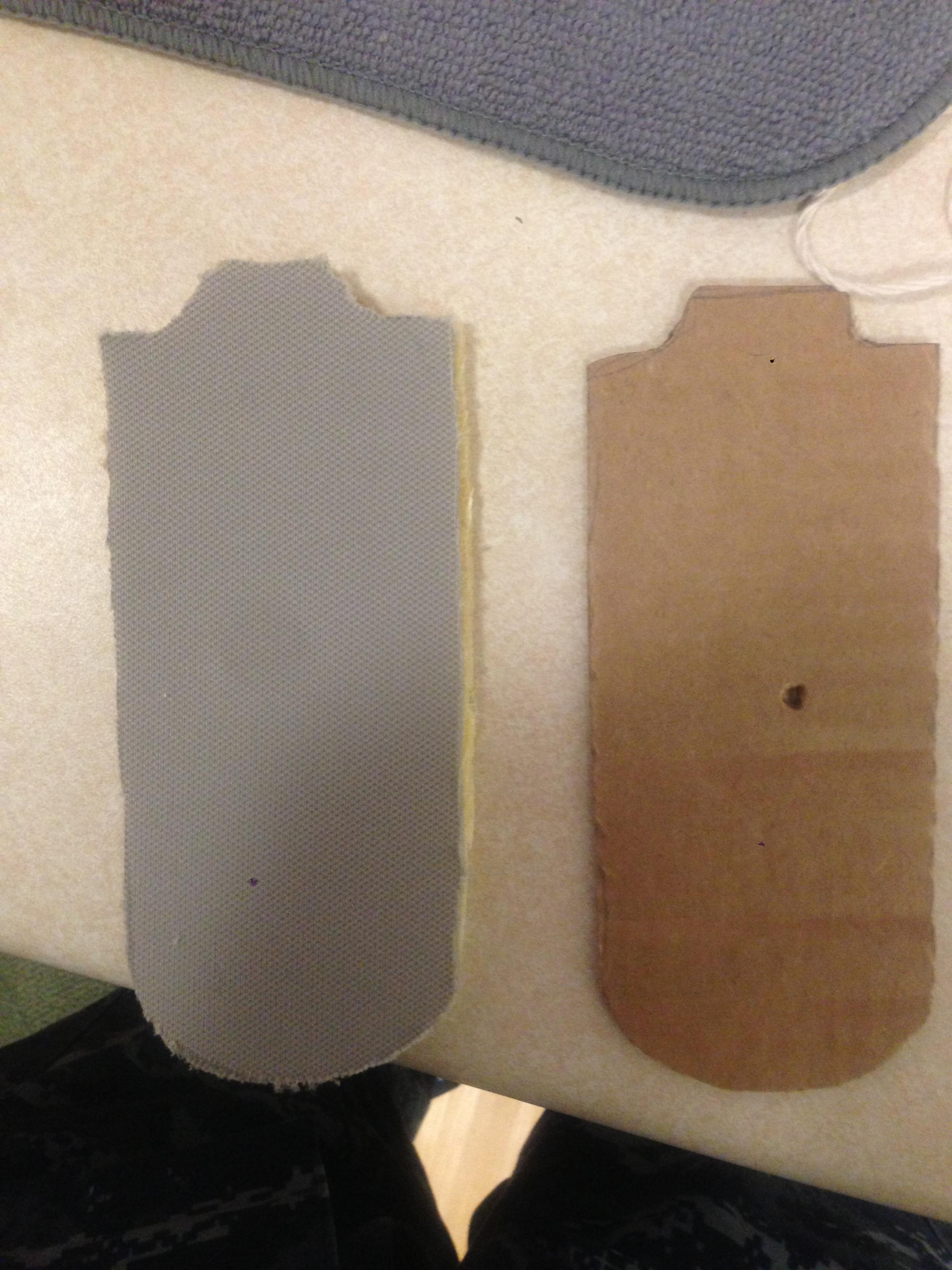

Take your piece of cardboard and punch a hole in the center using the small screwdriver.
Step 3:
Thread the string through the cardboard hole you just made and tie enough knots to keep it from coming back through.
Step 4:
Slide the cardboard into the factory hole in where the center dome light was and center over the hole.
Step 5:
Pull down slightly on the string to keep the cardboard from moving. Trace the outline of the hole on the cardboard using the pencil.
Step 6:
Remove the cardboard and cut out the shape using scissor.

You can use a measuring tape but I just eyeballed it! Center your template just behind the sunroof switch (if you have a sunroof). Use the pencil to trace out the shape on the headliner.

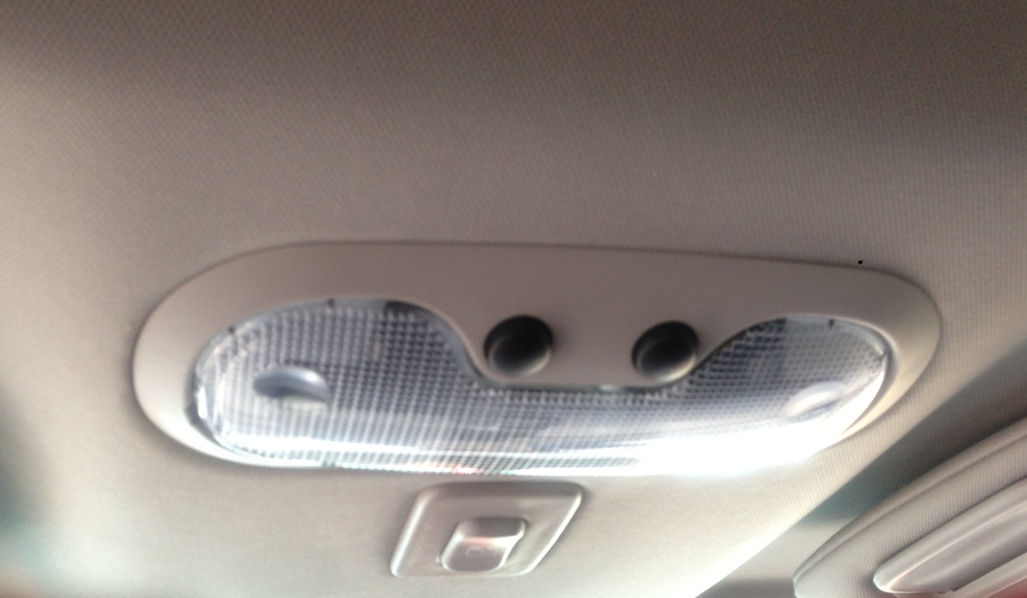

Install dome light in your freshly cut hole. The part comes with 3 bulbs (578) installed but you can use LEDs to make the inside BRIGHT!!
Note: I cut the cardboard just a little smaller than the center dome hole because I wanted it to really fit snuggly in there. You don't have to but that was my preference.
