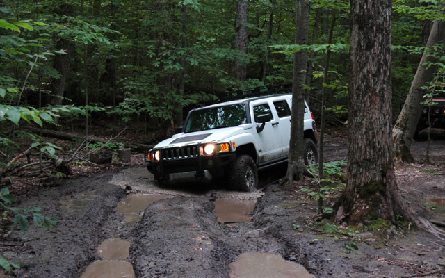

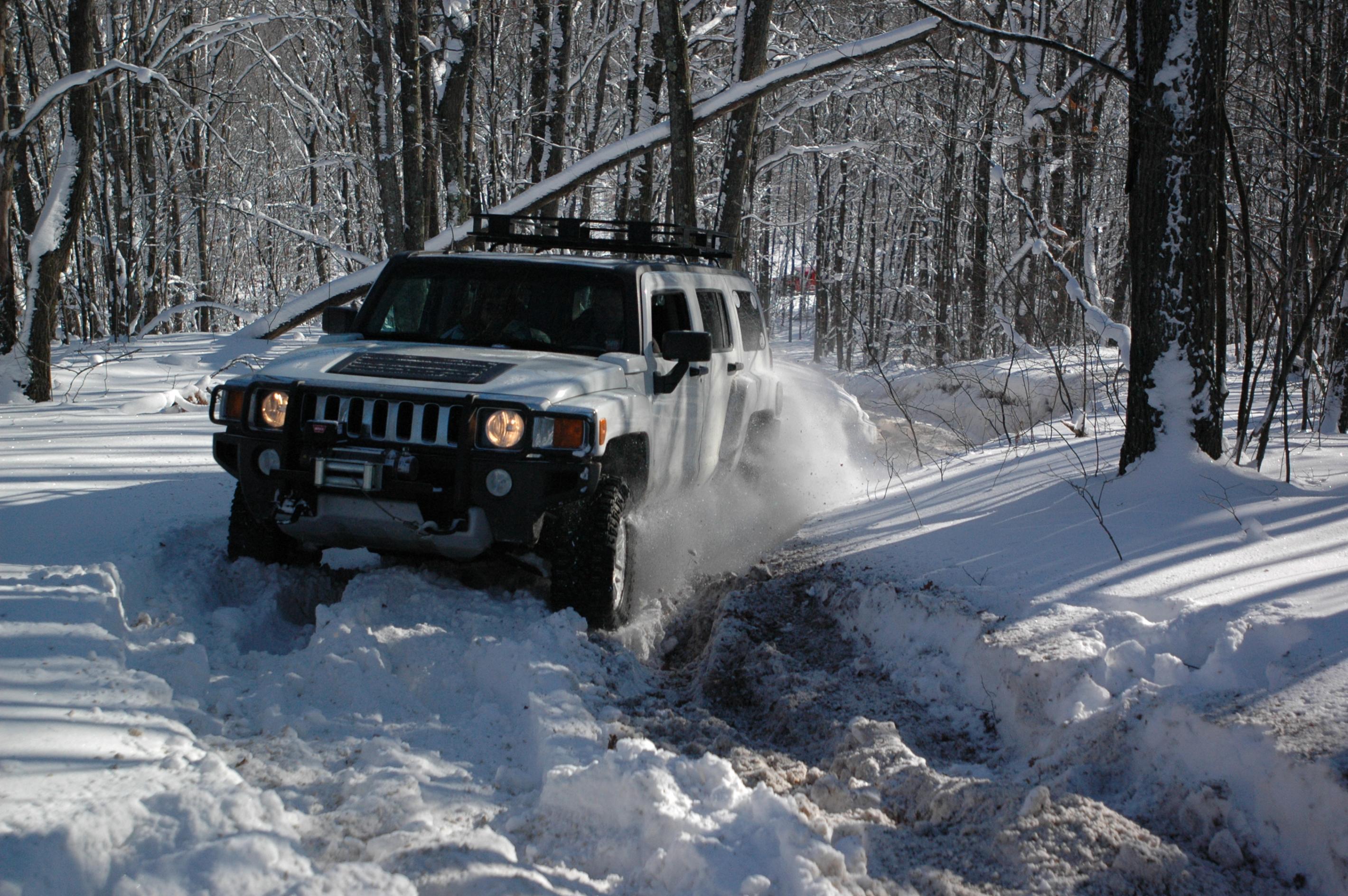

Both of these trucks (white and blue) are running 285x75 33's. Evidence that 33's will get the job done.
