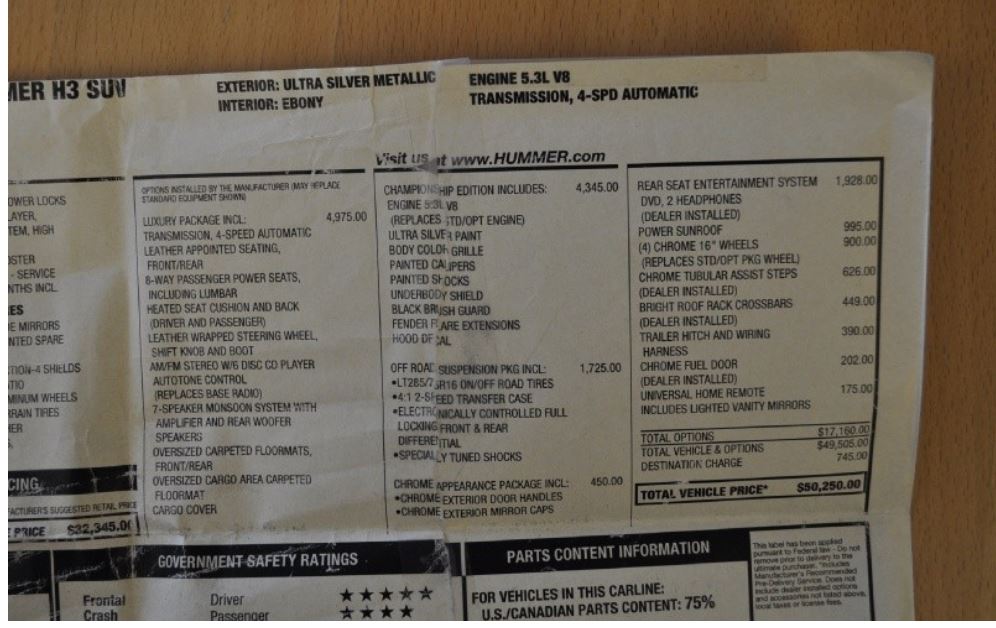

No. That's my point. They're not part of the Offroad (adv) Pak. They are separate add-ons and must be ordered & paid for separately (apparently even on the Champ Edition).
Here's a copy of the invoice from our CE. The UCP was part of the original CE package (not the Offroad (adv.) package) - the sliders were not. They were separate add-ons.

3. I have seen several Champ Editions without rock rails or UCPs...noted in the GM literature as being part of it.

6. "Off Road Pak" and "Adv. Pak" are the same thing...terminology was changed on the V8 models just to confuse everybody. (Off road and Adv are the same options; however, the terminology was around long before the V8 was introduced. The attached copy of my 3.7L 08 H3, shows the Luxury Package and the Off-road Suspension package. From what I can remember, the Adventure package was a package added to a base model and then some called it an Adventure series. Whereas, if you ordered a Luxury package, and you wanted the larger tires/4:1 tcase/locker(s)/tuned shocks you ordered an off-road susp package, not an adventure package.)
H3Label_zps81bac01f.jpg~original
