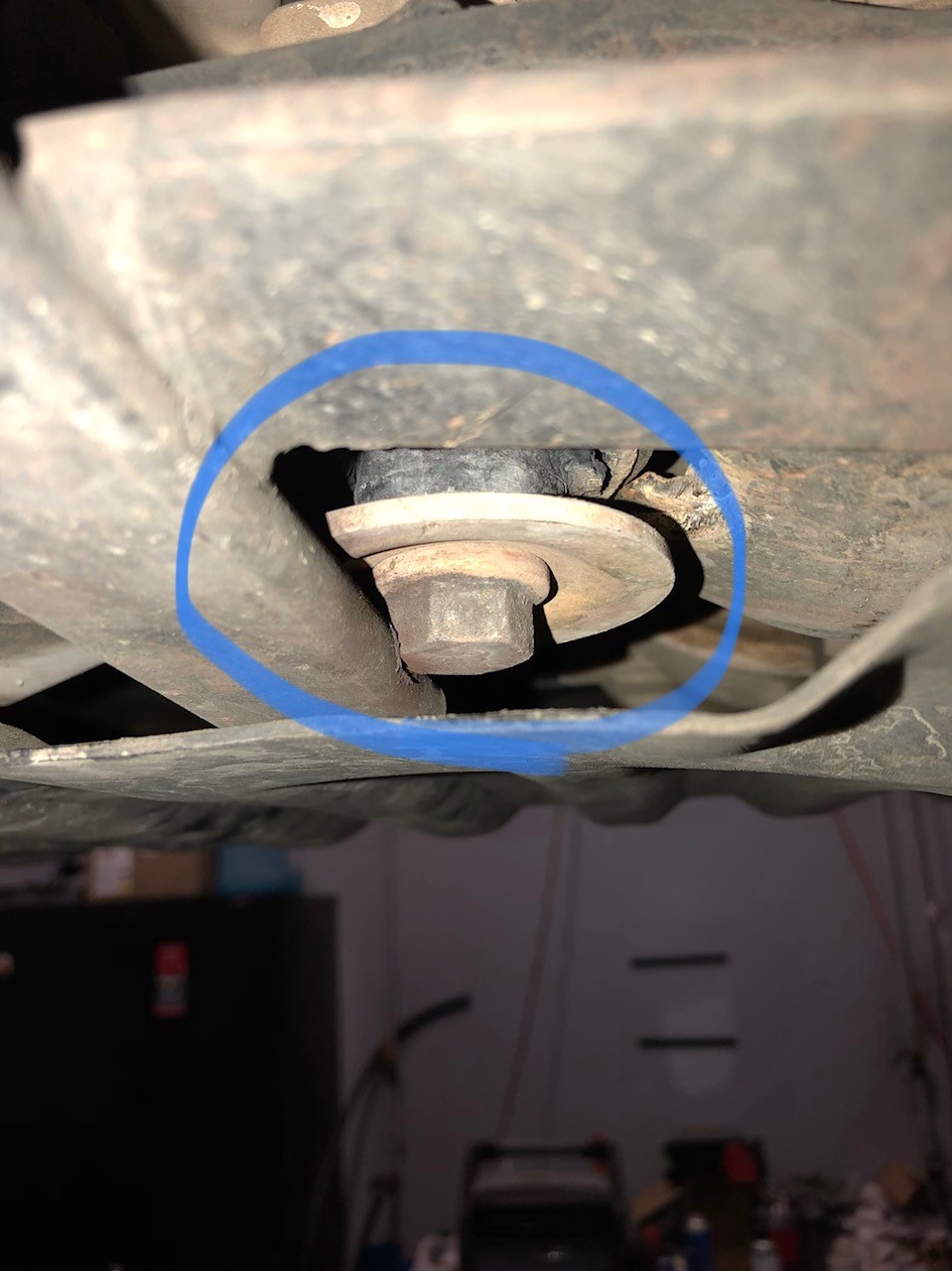

The biggest thing is the rattle in the left front end. They said (please see attached picture) the crossmember is broken, can't be fixed and needs to replace the entire frame for $700. Hope you can see the failure up near the upper right inside the blue circle).
All those years of offroading and Solar has done great. Go figure driving down the road and this happens!
That looks like the front differential bushing, GM sells the entire cross member just to replace that little rubber bushing.
There are 2 vendors here that sell upgraded bushings to fix that issue (without requiring buying the entire cross member) at a fraction of the cost.
I have done the outfitterdesign bushing kit, its a DIY and it has everything you need to do it locally.

Wow, that would be great, but, I'm not mechanical, so I'm not sure how one repairs the bushing without replacing the entire bar (to me it looks like it has broken off)?
You diffenetly need to get a second opinion on it from somewhere else besides the dealer. But usually its the bushing that fails in that area, the cross member is metal while the bushing is rubber. If the cross member was breaking it usually happens at the sides where it mounts to the frame.
From you pic I can clearly see the rubber is broken abit. Do you have a pic with the ucp removed?

$700 is too much for just the crossmember. Find another mechanic or a friend that has tools and knowledge working on vehicles. The crossmember is easy to work on. The front differential bushings are another matter but if it's $700 for a new crossmember and new front differential bushings then that starts to sound more reasonable.
10,660
That crossmember is 300 or so, less than an hour to replace. An independent shop can do it for less than the dealer.
10,660
Just checked. The part is $232 plus shipping on parts.com

You could also take the crossmember out (like 3 or 5 bolts) and have a shop press out the old bushing, press in the new bushing, and put it right back on the truck. Would be cheaper than $700 and last longer than oem.

It could also be an issue where the crossmember bolts to the frame. The crossmember can get small stress fractures around the four mounting bolts. I’ve welded-up one before, but I would rather have replaced it with a new one. Before you hassle with installing a new bushing...check the ends of the crossmember. It might not be worth saving.

Update: After a few more emails repeating my question the dealership replied:
"Yes the bushing/grommet is completely broken from crossmember. We did not see the crossmember cracked." So it's the bushings, not the crossmember, unless when they take it apart the crossmember is cracked (which Will at Outfitters said wouldn't be visible unless the crossmember was removed).

Just a note, on the V8 I was replacing cross members every 25K (all under warranty). Had 3 replaced simply due to a worn bushing and that bushing isnt a serviceable item from GM so you need to buy the entire cross member which comes with the bushing pressed in (similar to the UCA)
With the OD kit I havent had the bushings fail in 45K, double the stock GM

I'm not sure I understand what I'm seeing in your picture. I have the same year, option H3, and this is what that bolt looks like from below
I see a cross bar (ignore the grate behind and its angle - that's 'custom') but I don't get what happened to yours. If that bushing did pull through, simply welding the tube back in place (after removal of the bushing) should resolve the issue. As for $700 - I don't think that's unreasonable if that includes labor....
