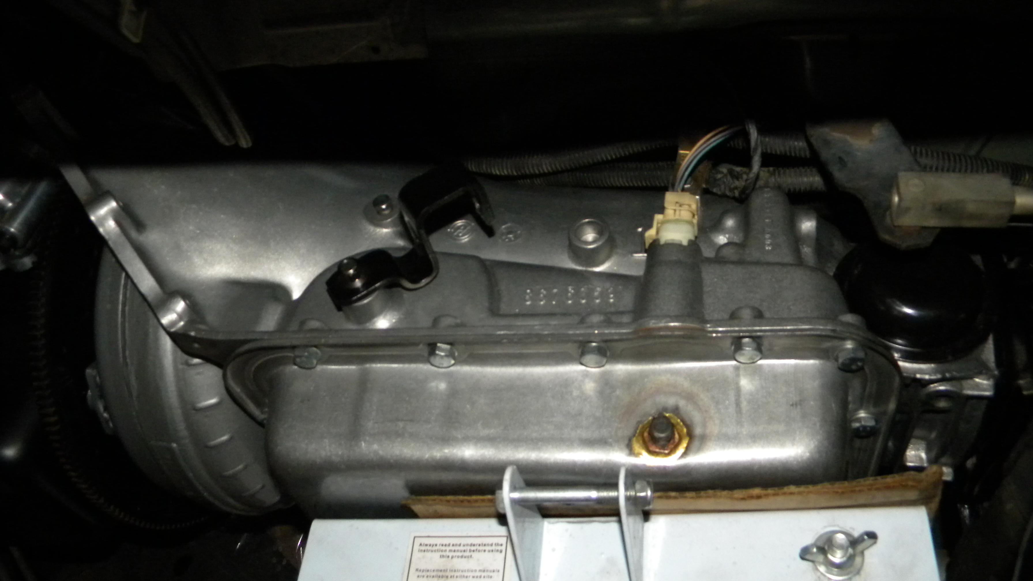

I opted for a cheap rebuild on the 700R4 in my '89 K1500 for ~$800.00 which lasted less than a hundred miles. In the past month I did it right and replaced that trans with a Level 2 BTO 700R4. I saved money by replacing this trans myself, and it wasn't easy considering I'm probably twice as old as most of you. Keep in mind you also have to wrestle with an eighty-five pound transfer case on a trans swap in addition to all the other hook-ups. One of the important tests when getting a vehicle with a new OD trans back on the road is verifying line pressure in all the gears. BTO sold me an install kit which includes a pressure gauge to replace the 1/8" pipe plug on the driver's side of the trans. I verified the line pressure before I road-tested my truck. I now have close to a thousand miles on this trans and I'm very happy with it so far. DSCN1028.jpg

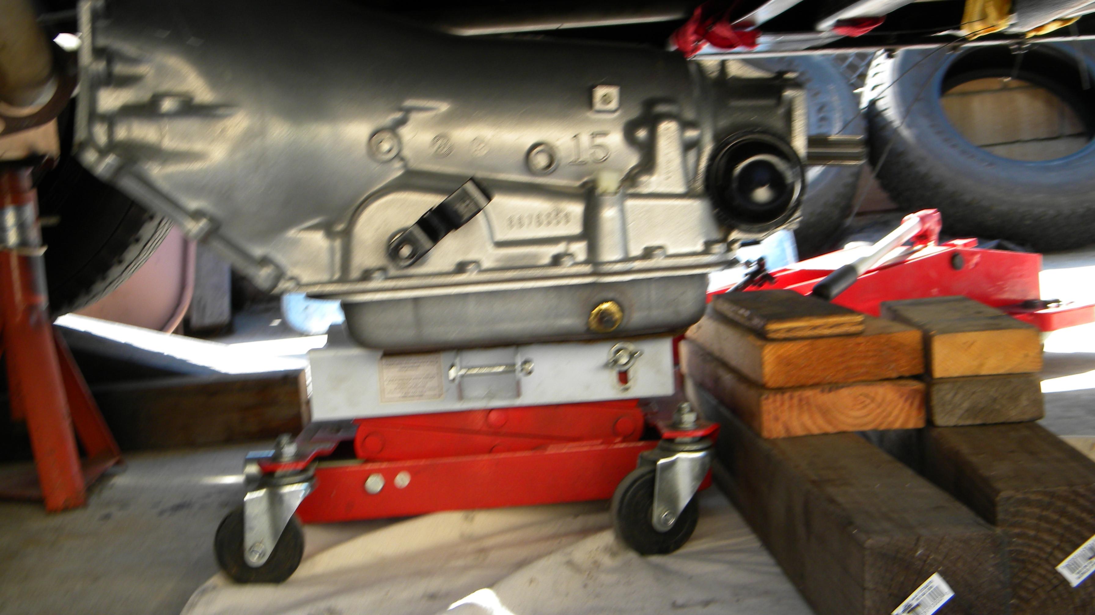

I believe it. When you're working with heavy parts like a trans and a transfer case under the truck it can be REALLY difficult. Having done this job 2X on my K1500 in the last six months I came up with a procedure that worked for me. I used two trans jacks; one for the trans, and one for the trans case. That transfer case is going to screw you up if you don't support the heavy end because it will twist the two together right off the jack if they both aren't supported correctly. I also used 4X4 blocks to elevate the trans so I could slide it onto the trans jack under the truck. Think safety!DSCN1025.jpg
