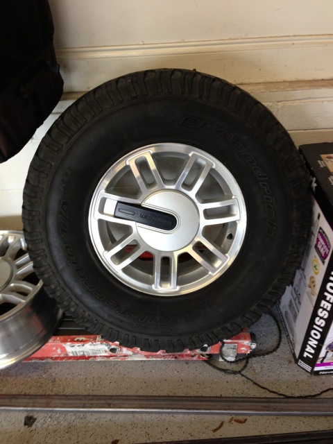

Before I add the saddle bags, ill be into this trailer for about $600. Steel was $150. The axle, springs, hanger kit and ubolts were $175...including the custom length, 6 lug axle. Tires and wheels were $200. Only thing missing is a jack and coupler for a usable trailer.
