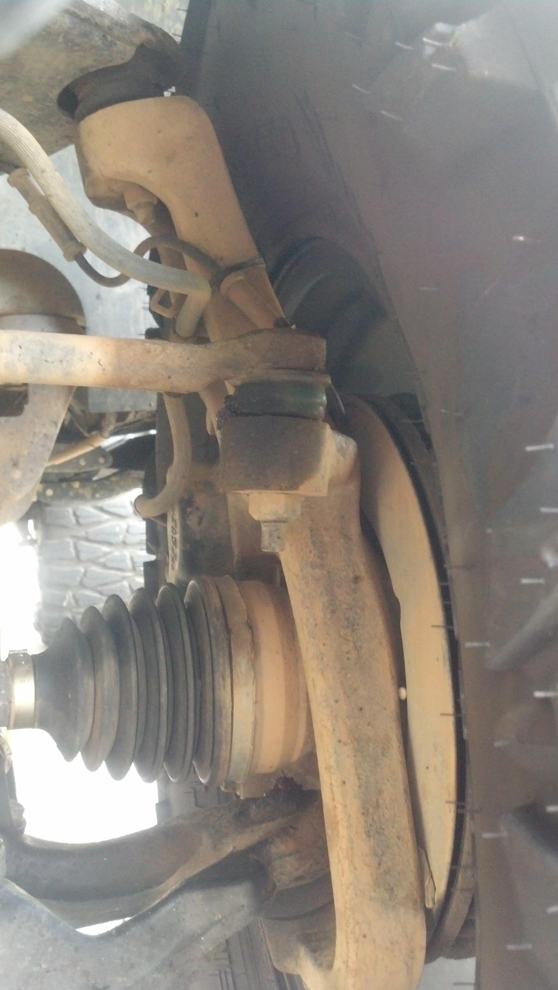

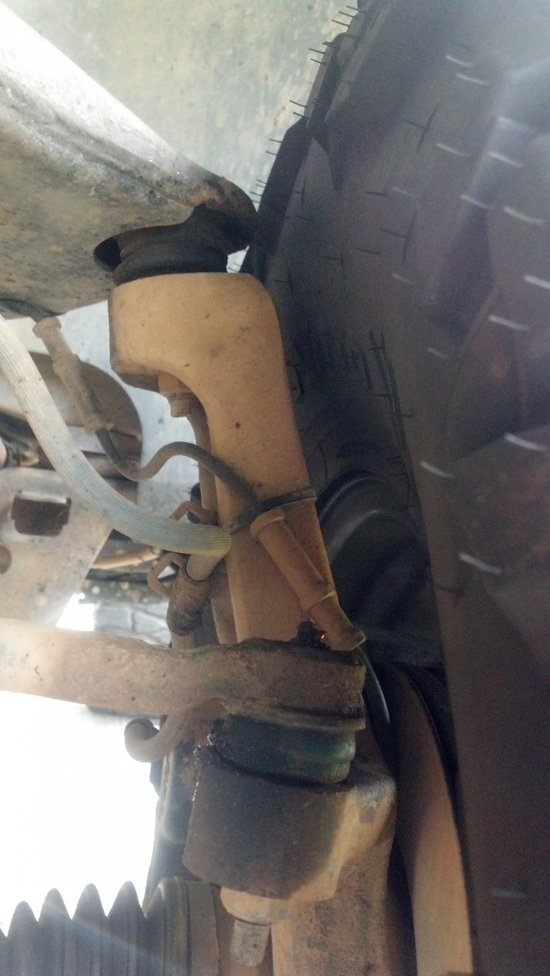

I wanted to lift MessiaH2 and run my tires and rims for a while until I could afford to get all new... The people i was buying the lift from told me that the Fabtech people said the new "swing arms" i think where going to REQUIRE me to have 4.5" BS... When i looked into that deeper they were correct. The TOP arm definitely IMG_20131007_085946_514.jpgIMG_20131007_085936_593.jpg would hit into the back of the rim and without the proper BS on these new rims, i would have been screwed.I would have had a lifted truck and never been able to fit my stock tires and wheels on so i would have been dead in the water.

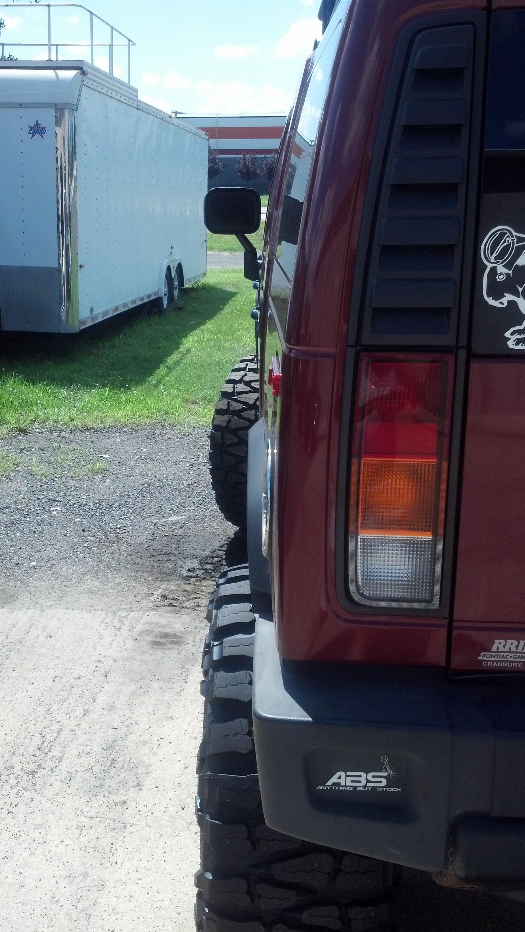

Now with that said you have to remember that BS like 4.5 also pushes IMG_20131007_085957_135.jpgthe wheels and look of the tire OUT...IMG_20130705_151225_769.jpgNow for me that is the look I wanted and I am a mudder not a climber so it all worked out. Also when looking at this picture remember I have 15.5wide Mud Grapplers which could be considered extreme...LOL :horns: I just went out and measured and the back tires are about 3" past the stock fender flare and the front wheels are about 5"... Now here again i choose to run (illegal) this way because i prefer the look but i will say when i hit the mud, I HAVE to have my windows and sunroof closed!!!
