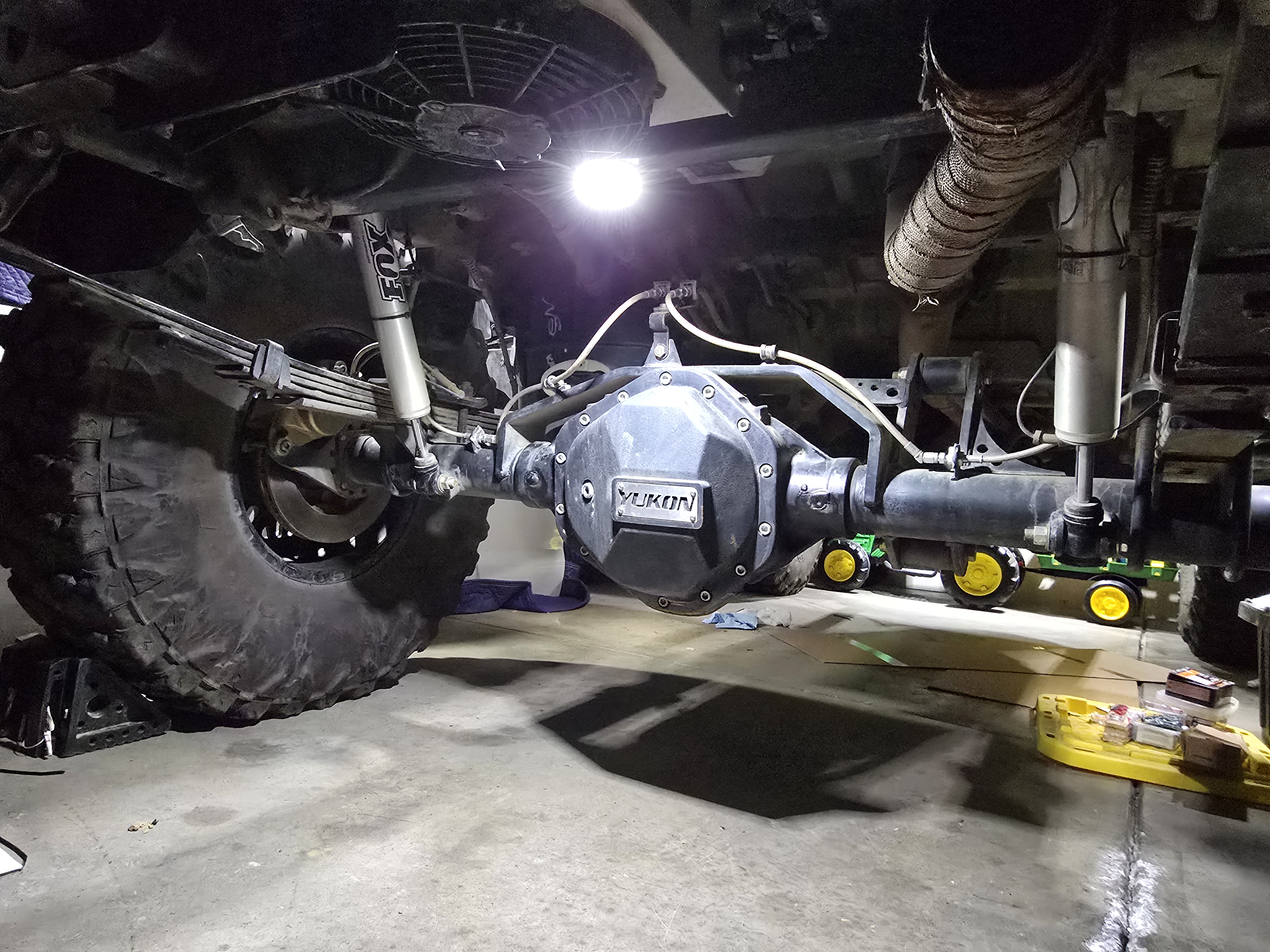

changed all Diff breathers with much longer.... the rear axle was so short from stock , so now it's 40" higher :cool: Prevents from having mayo in the those diffs 😁
