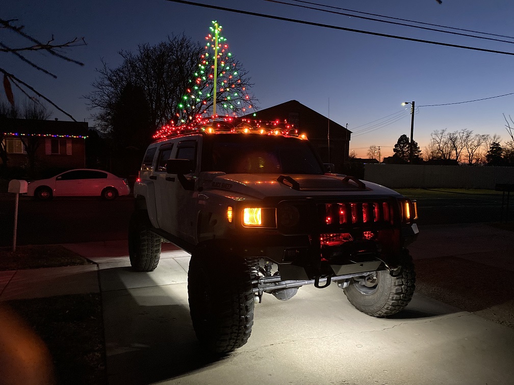

Recently replaced the battery. I drilled out the sunroof grommets last weekend due to crazy amounts of water all of a sudden (passenger side was a bitch) and I replaced my radiator yesterday, 83k. It was cracked on the top front plastic to the right of the rad cap. Seems like I’ve been doing a lot lately but it’s all worth it!
Ordered new shoes for it last week, the 33" Duratracs have lived a full life after 6 years, 2 H3's, and I don't know for sure how many tens of thousands of miles.
Now that I don't have to drive it every day I figure it's time for something a little more aggressive. Ended up going with 35" General Tire Grabber X3's. They're supposed to be pretty decent in the snow for a MT and all the reviews of them I found were mostly good overall so we'll give them a shot.
They're either on backorder or really far away from where I live. I ended up ordering through Discount Tire and they're having to get them sent from Georgia, so they'll be here either late this week or sometime next week.
Also finally started working on getting the ARB lockers hooked up. I ran the hardlines yesterday and had to run around doing errands today, including getting some more fittings and a tap and die for 1/8" NPT to fix the cheap fittings I had ordered earlier this year. Hopefully tomorrow I can finish hooking them up and get the wiring for the compressor hooked up to the SwitchPro. I'd love to be able to go try the new tires out up in the mountains up the street from my house and would like to also have the lockers all hooked up for that.
08H3
1,368
That's awesome! I did something similar years ago. Was quickly surrounded by two city cops and a sheriff's deputy. Got a big lecture about illegal use of colored lights and how I was probably confusing all the other motorists by impersonating a police car. Geez...someone had no Christmas spirit that year.
