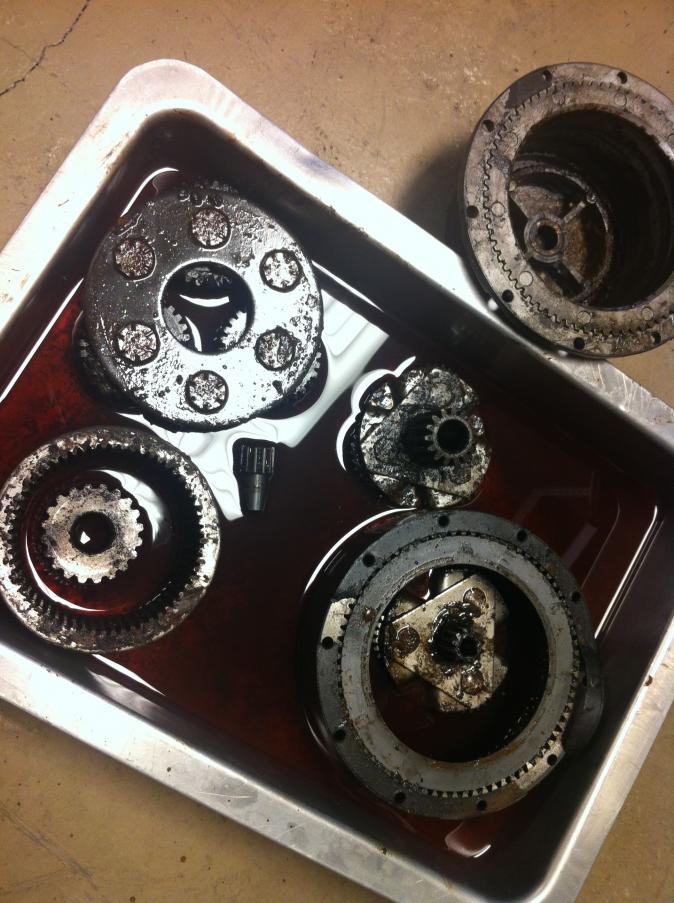

Few months ago, I was stuck and could not free spool my winch. I could power out and in only. So I start taking everything off the front of the truck to remove the winch (down side to the DOI bumper). I found water in the gear set that had caused corrosion, not allowing the handle to turn. What a huge mess to clean up. After removing the old grease and sanding the rust down, its engaging properly. Ill repack with marine grade grease and slap it all together tomorrow.
Warn had great customer service, and offered me advise to take it apart myself or send it back under warranty. They did tell me to run the winch out a few times if it gets submerged. It was obvious I never did that, as the rust line and corrosion was about 1" up the gear set. Its pretty interesting to take one of these apart..... schematics are your best friend.
