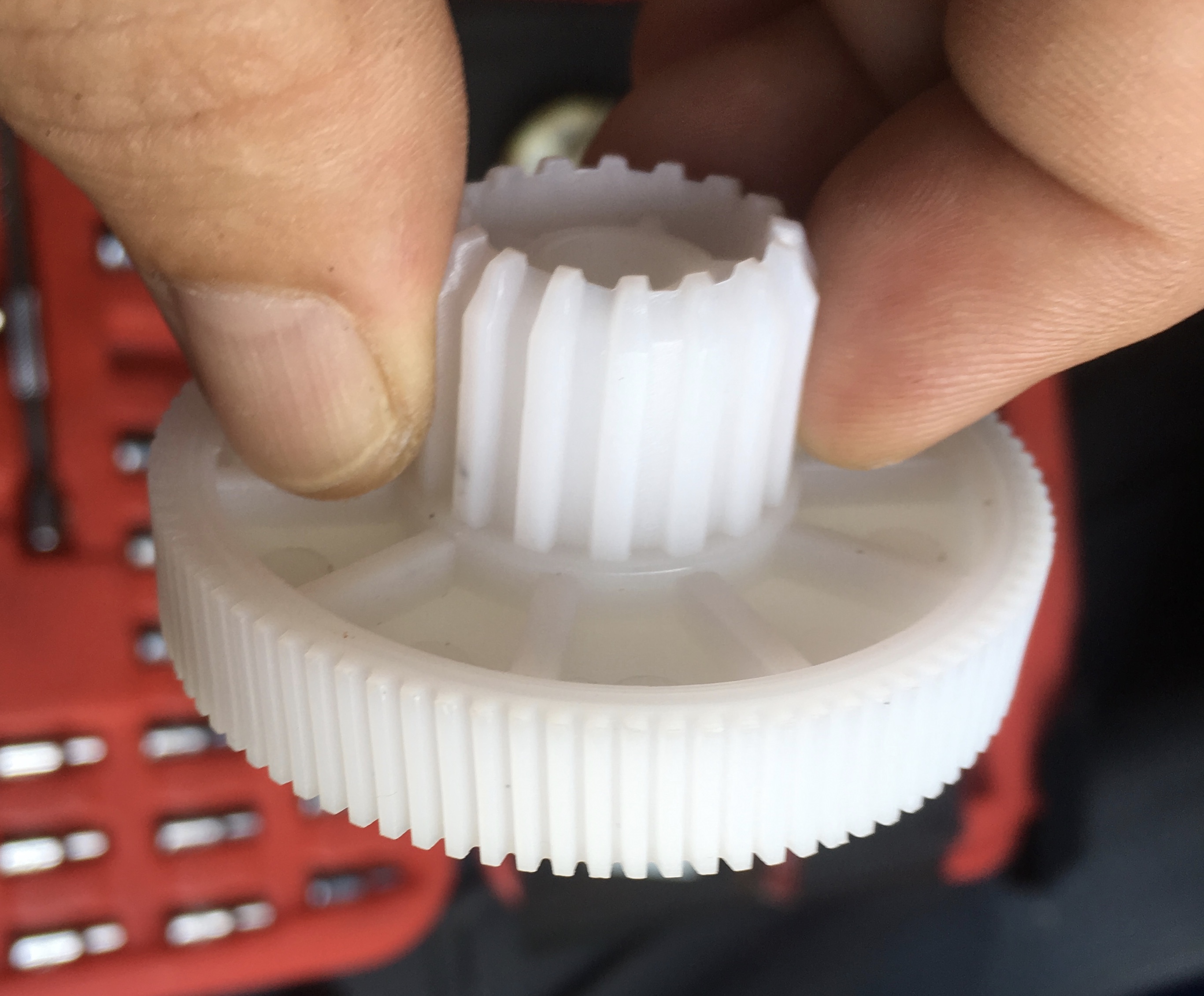

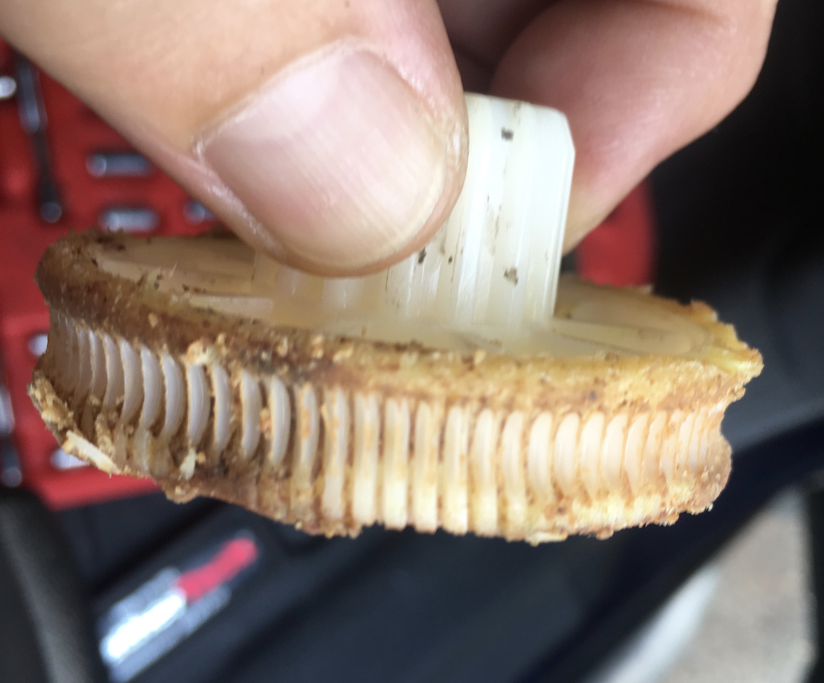

Hello everyone, so my sunroof gear dripped and I came across this one on eBay made in turkey.
(See pic) I ordered it today and I will post the results after I revive and install it.

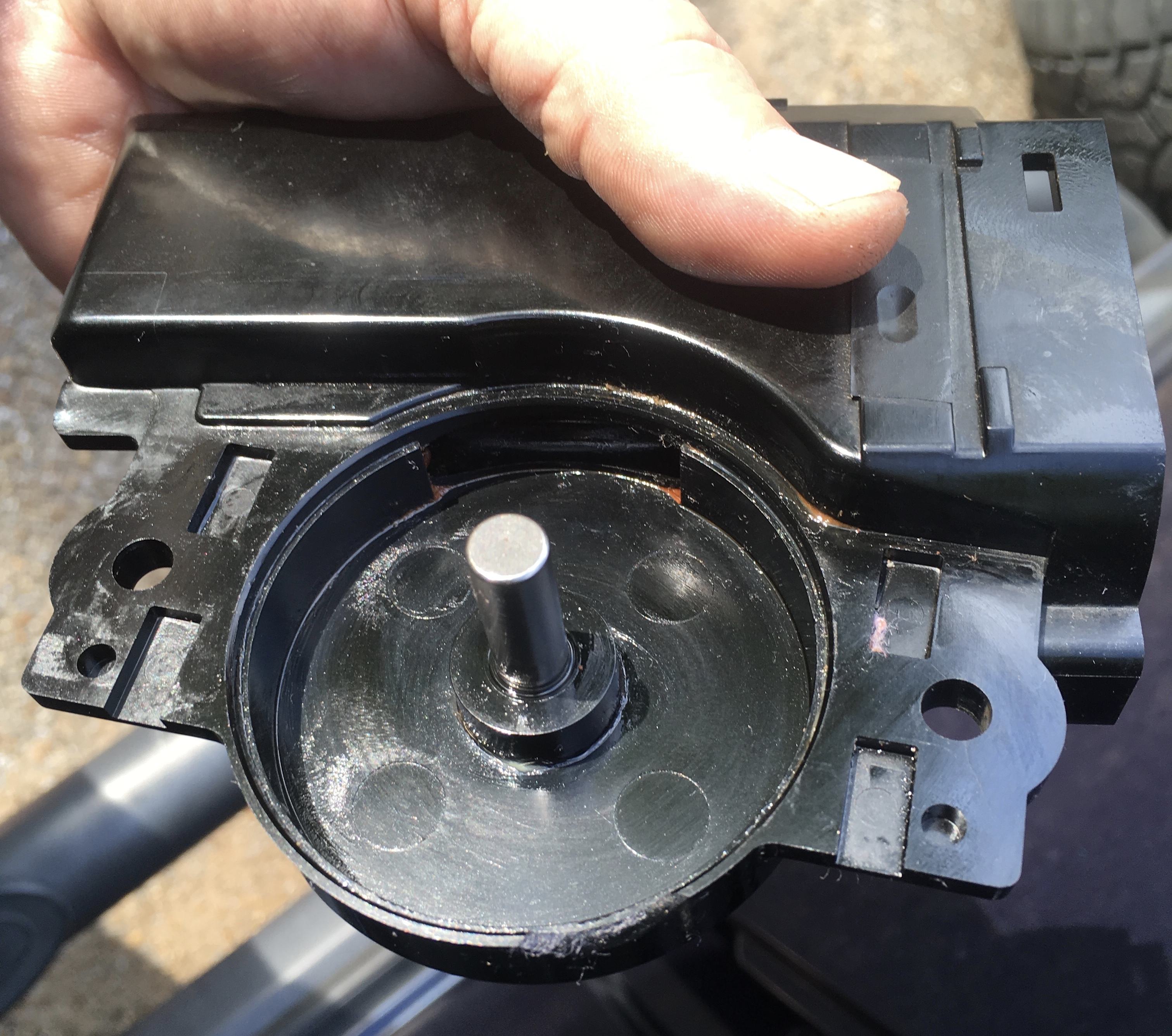

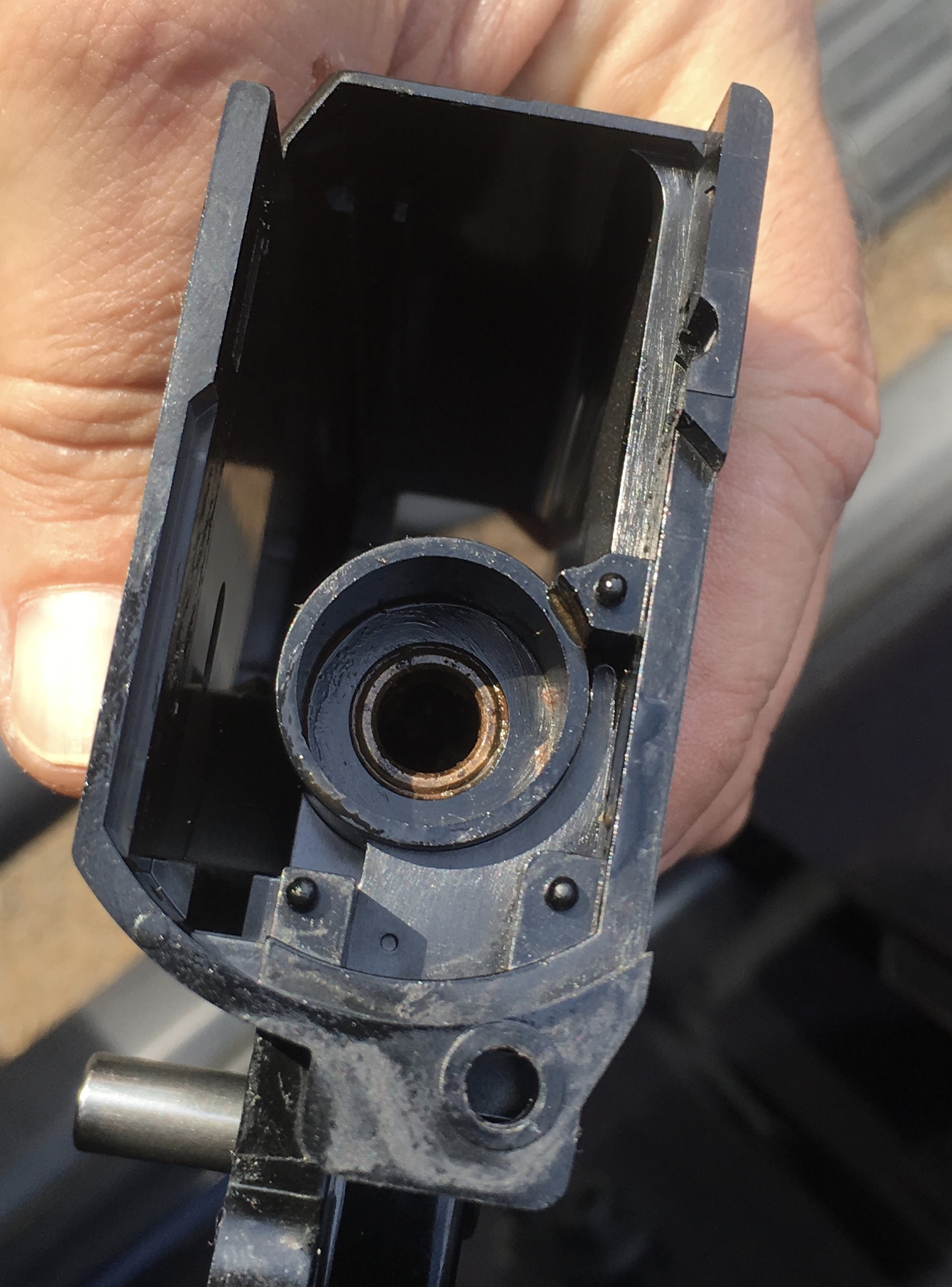

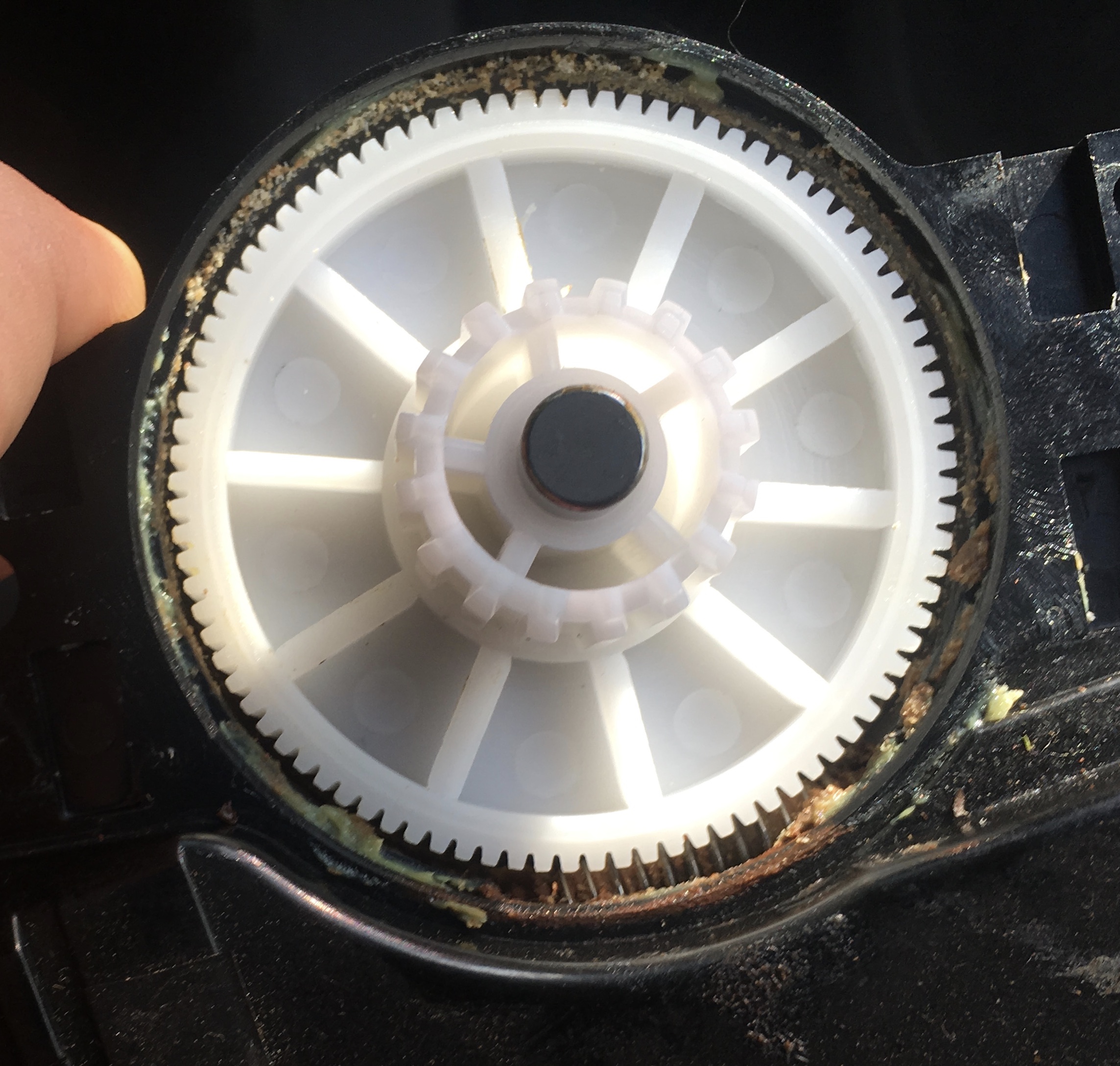

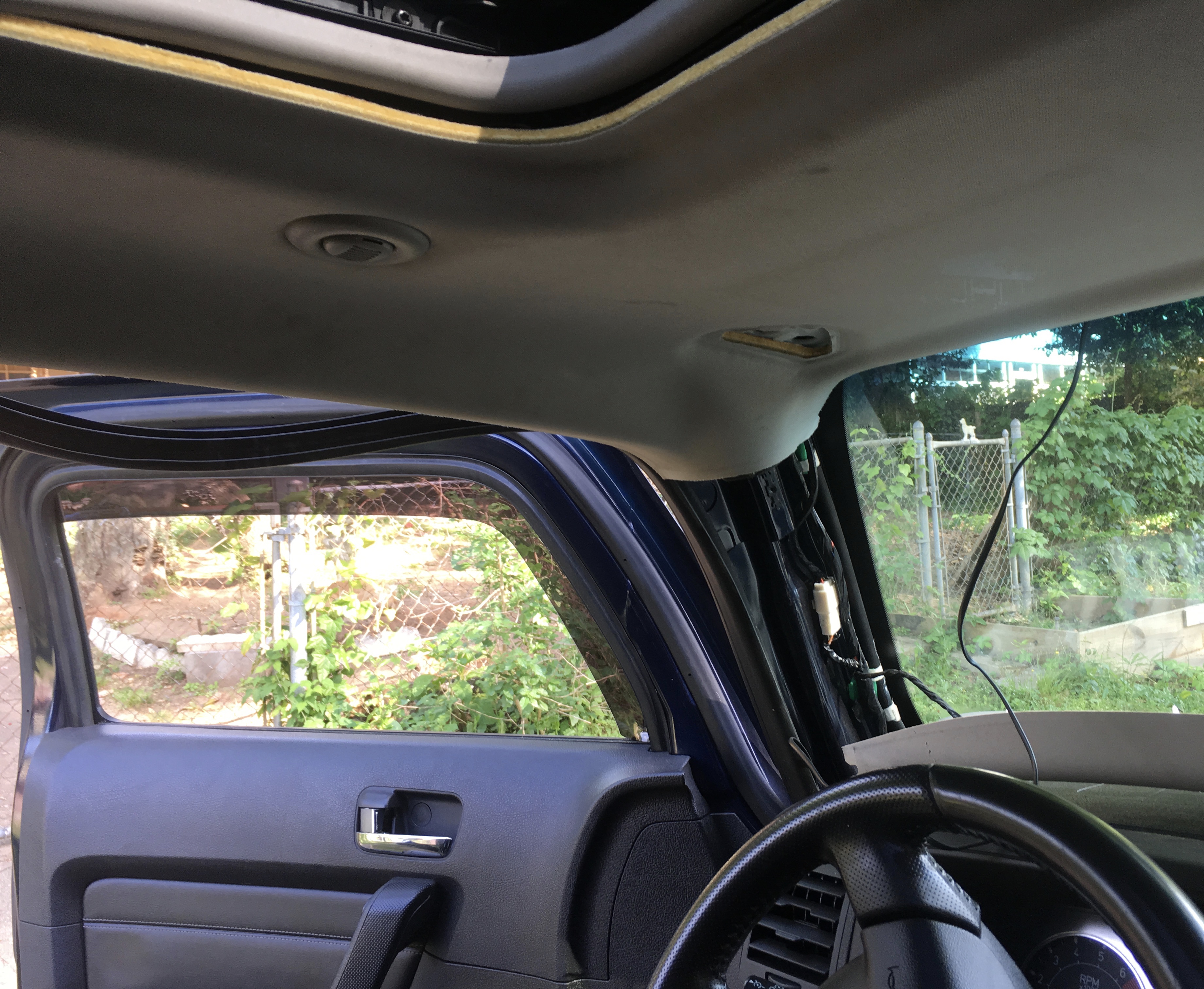

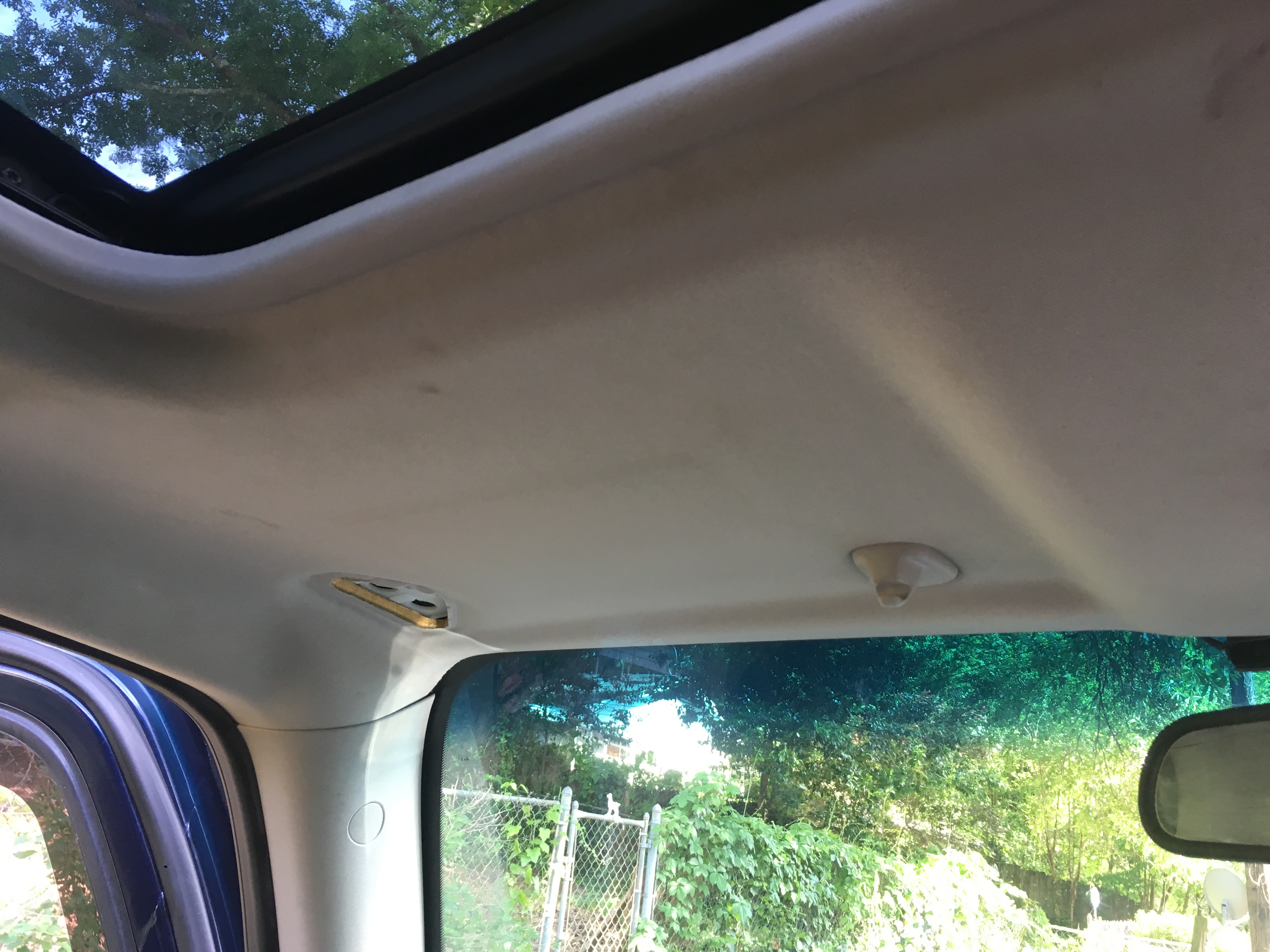

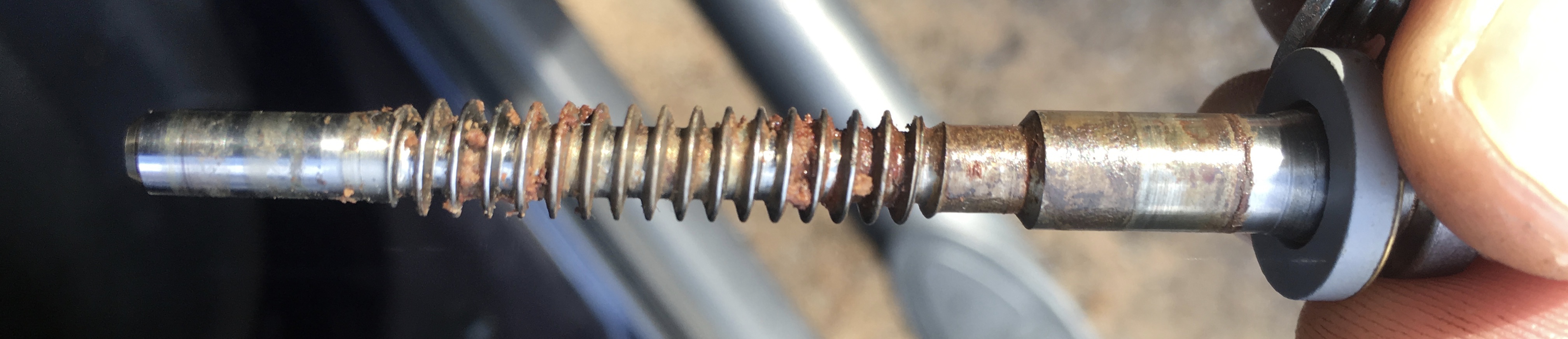

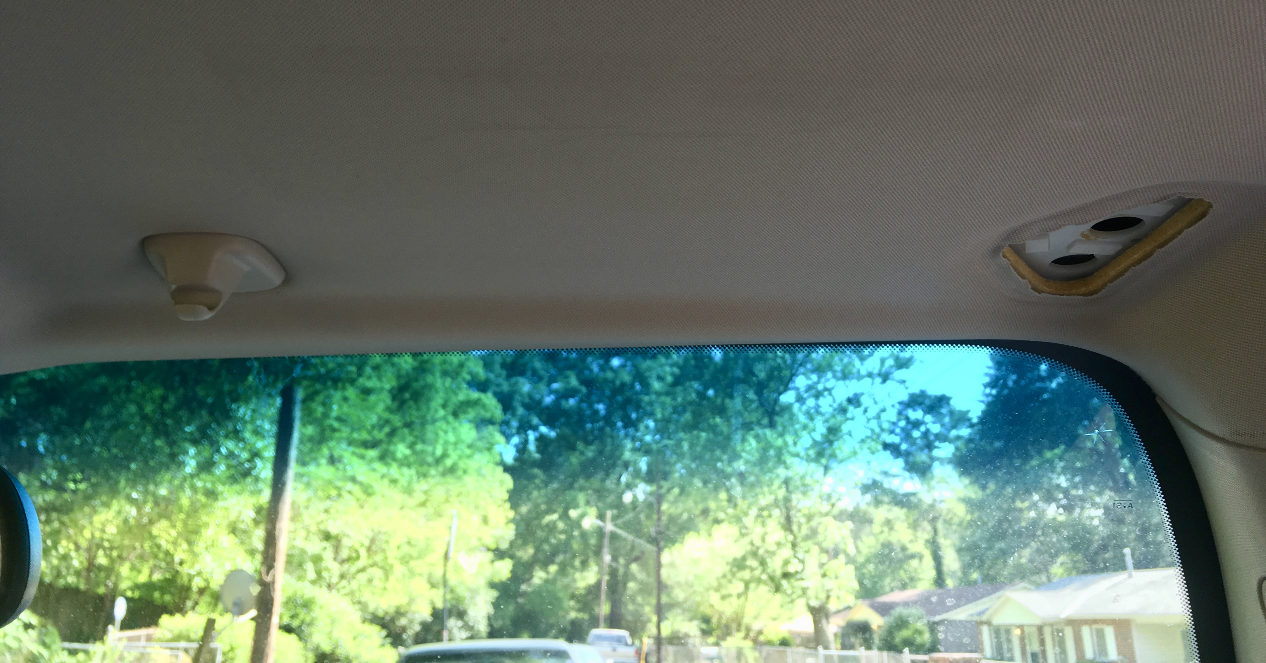

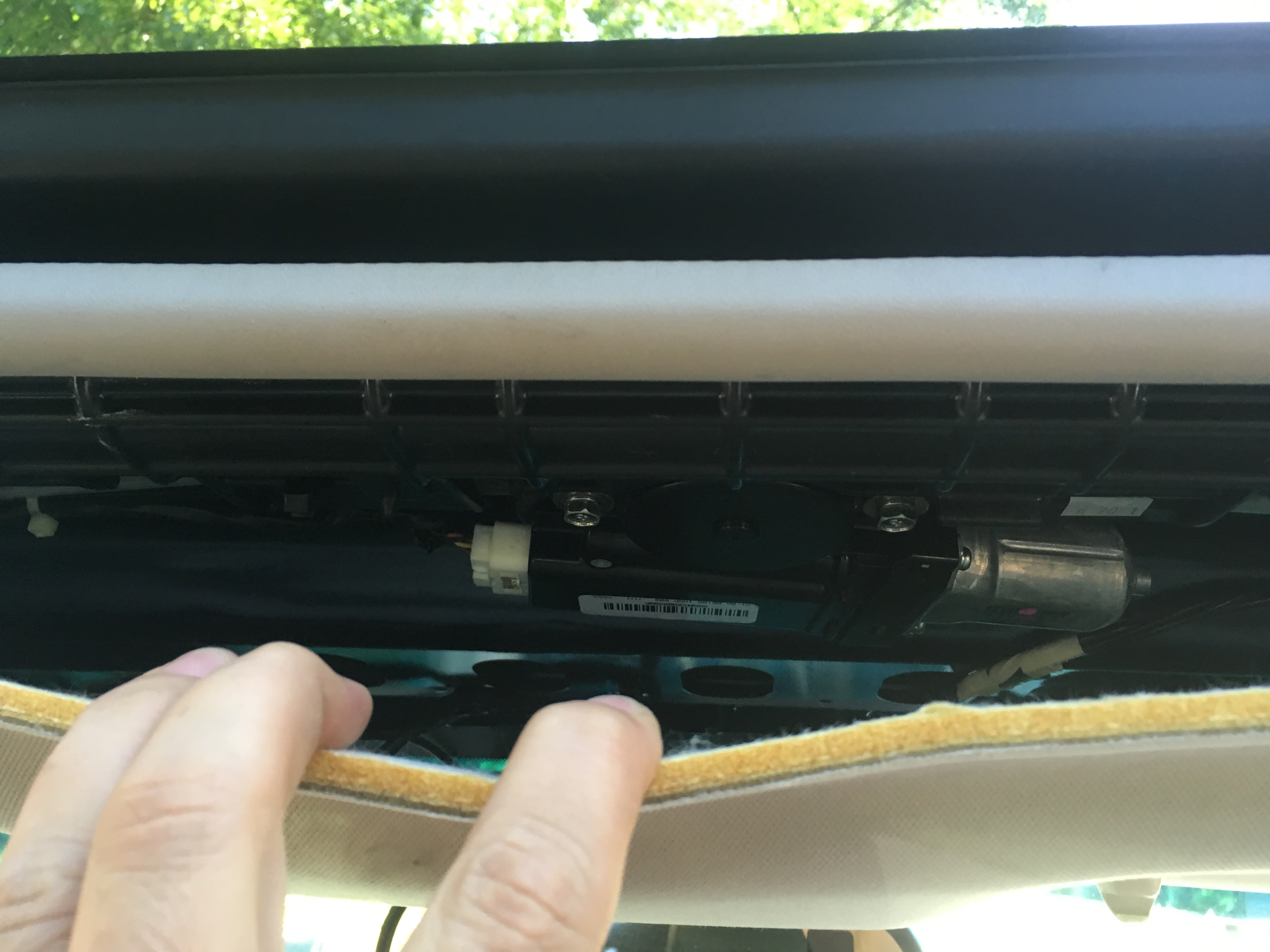

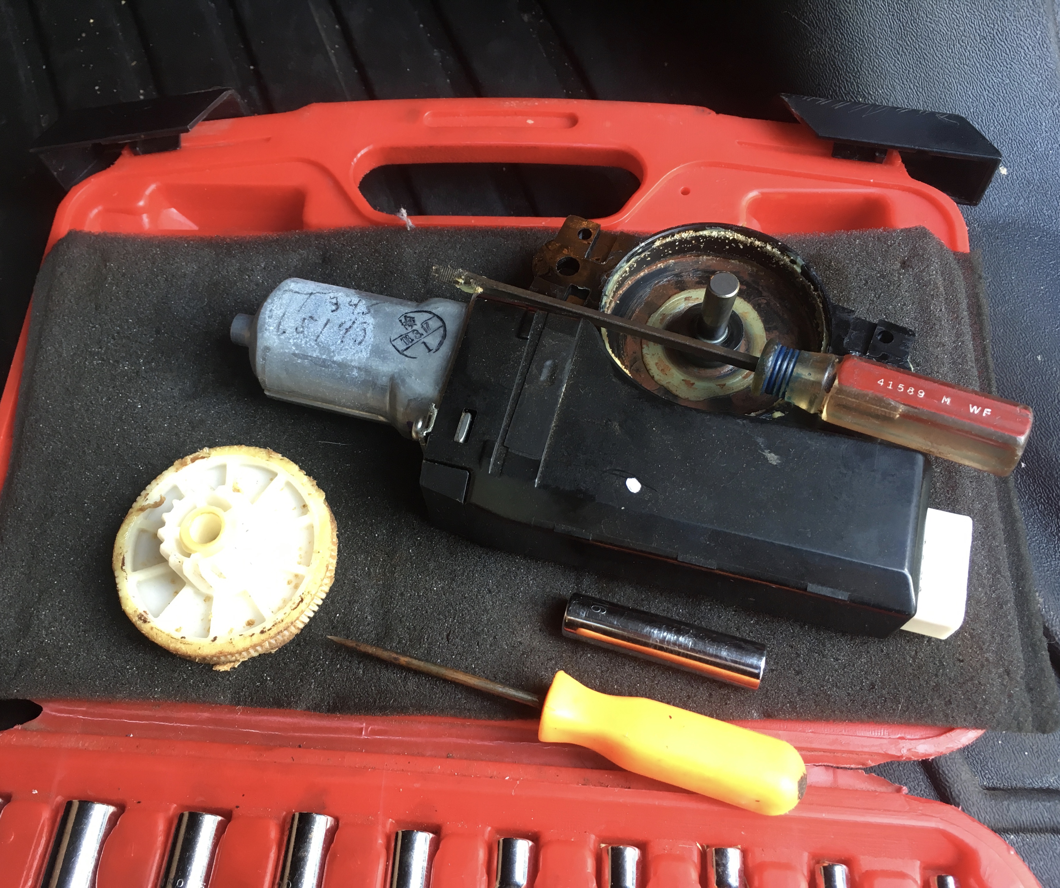

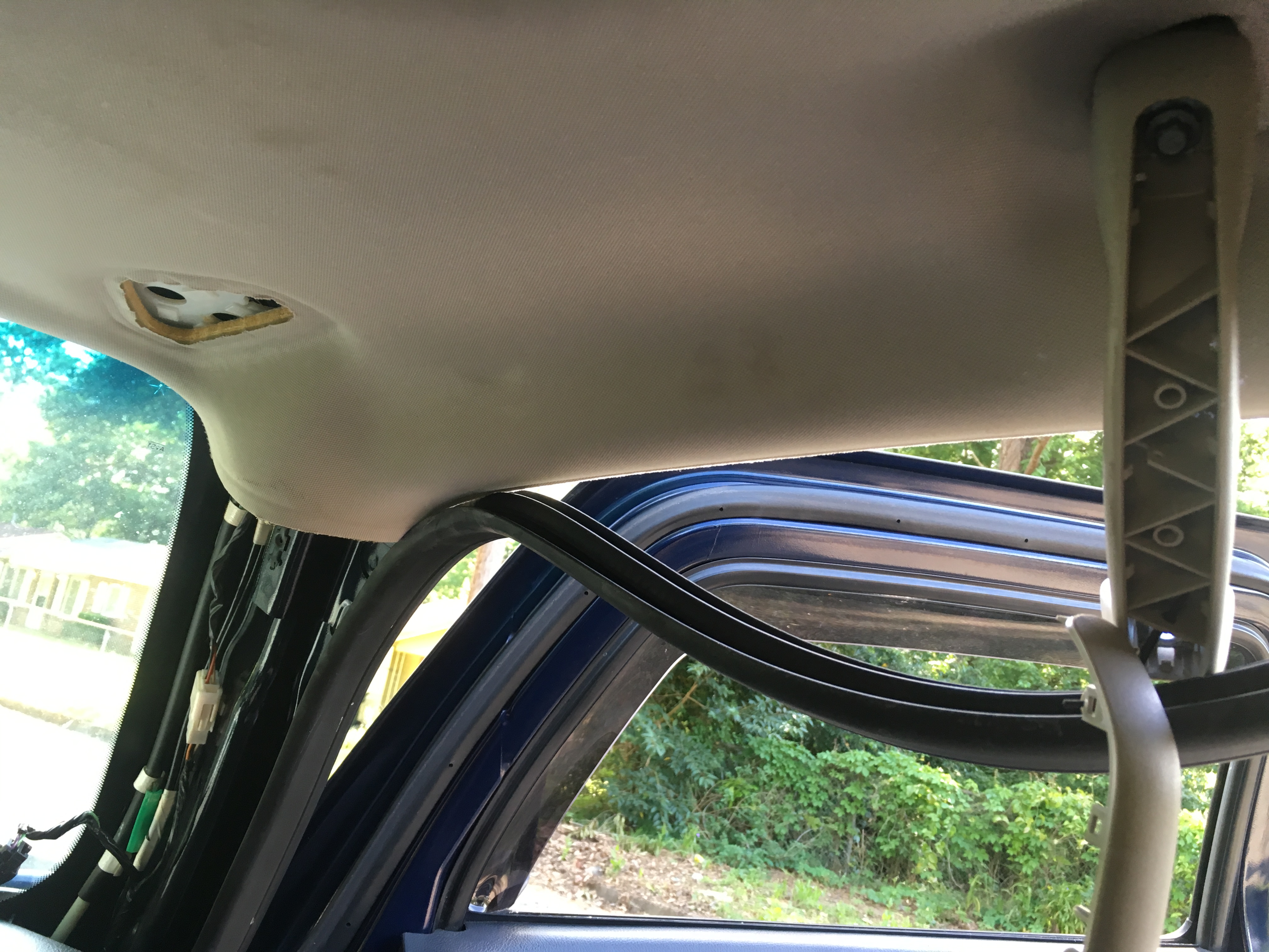

My new motor gear came in today & it took me about 3 hrs to do the job.
I am posting pics of the process.
I didn't have to remove the entire head liner. only the sun visors retainer screws, a-pilars and the hold handle.
I had to disassemble the motor, clean and regrease everything.
I am still having some relearn issues but that's ok. all in all it works again. only cost me $17.80 and 3 hrs of my time.
That to me sure beats the $40 from the sunroof company and $350 for a new motor.
I hope this help anyone in the same situation.

Looks good. Thanks for sharing the nice tutorial and pics! I just ordered a new gear. I just know sooner or later mine's going to crap out, and then a cheap one probably won't be available.
It looks like water might have been getting in on the motor and possibly into the gear, by the looks of some corrosion on the motor. Does that sound right, or am I not seeing things correctly? Do you think water intrusion (leaking sunroof) was/is the root cause? Or could it have been a weak gear, or frozen-down sunroof or some excessive strain event which caused the gear to strip?
Thanks again.
