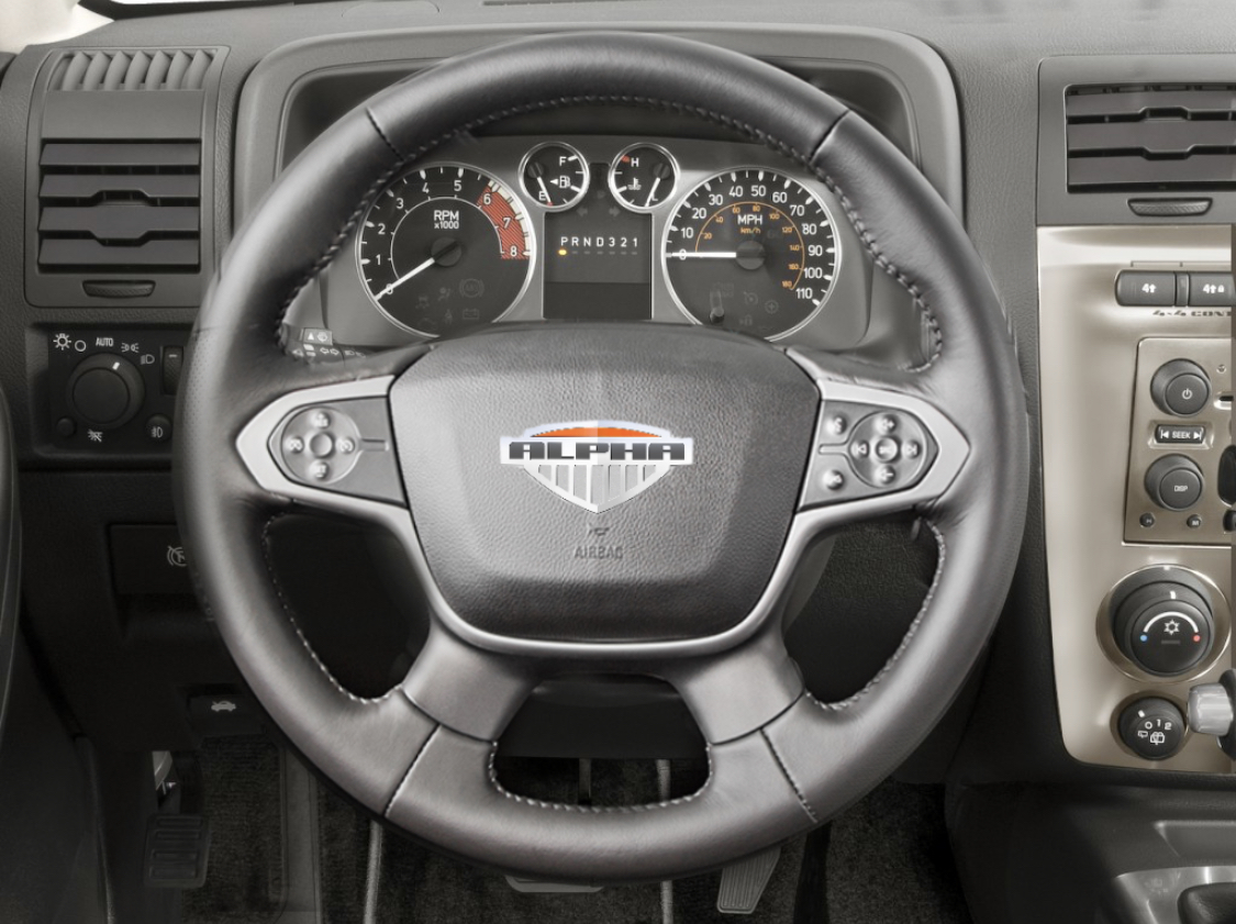

Looking into the possibility of swapping my steering wheel with a newer (~2015) Colorado steering wheel. I’ll post a picture for reference. Just looking for any input from you guys. Like, dislike? Suggestions? Etc....

Besides the airbag issues, you would have a bunch of audio control buttons that do nothing. What would be the point?

No airbag issues. The plan is to disassemble this steering wheel leather and all. Disassemble my current steering wheel (well I’d buy an extra for experimental purposes) and essentially swap their skins. Everything lined up practically identical on the wheels. The buttons would not be useless. They’d be fully functional and I’m in the midst of talking to a couple third party vendors right now about making that happen. The airbag would be removed from the h3 cover and transferred to the Colorado cover. This is the only part of the mod that I foresee extensive modification, only in that a new mounting bracket would likely have to be fabbed up so that the mounting holes match up. The audio controls are not the difficult part.. an oem harness and idatalink maestro will retain these features (with aftermarket head units) the cruise control is what I’m working on right now. There’s a few options out there just seeing what will work best. The deeper I dig into this the more doable it seems to be.

You might run into the possibility that the steering shaft is a different diameter or spline which will defeat you before you can start with any other ideas about the controls. I kind of like the '09-'14 truck steering wheels and thought I would try it on the '97 I'm working on. Didn't happen. Steering shaft is totally different between the two. Some machining and fab work might succeed but I was more into a simple swap.

I won’t have that issue with what I have planned out. I will basically use the guts from the H3 steering wheel. It’ll just get a facelift with the Colorado’s leather, plastics and controls. So everything will mount up the same as far as the splines and the airbag glockspring clips. Because it’s just an H3 wheel with a new set of clothes.
I can tell right away that it's not an H3 wheel or one with compatible parts. I've already swapped out my non-leather wheel for a leather one so I know how they work. There's just enough difference to make things difficult. Give it a try and prove me wrong.
