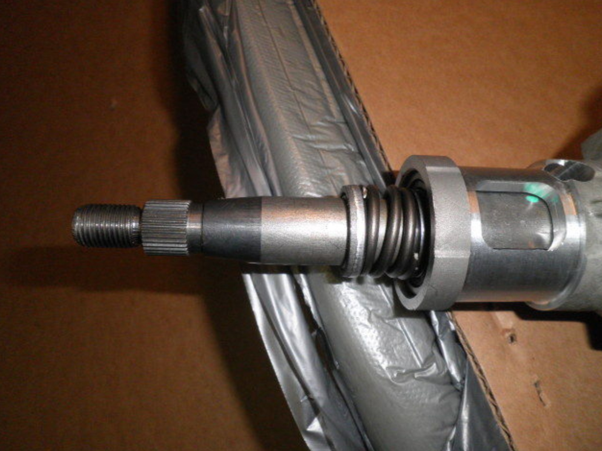

Ok, sorting out some minor issues with the new 09 H3T and you guys have helped sooo much !! Thank you.
Having a VERY FAINT squeek coming from INSIDE vehicle when turning steering wheel immediately after starting. Does not sound like belt, joints, under hood, etc. sounds like it is actually in the steering wheel. Like a spring that needs a dab of grease or something.
so faint, most would not notice, but my OCD is killing me. Needs alignment after torsion lift last week, and new shocks and extended bumpstops today, but want to give it a few more days to settle in and be perfect left to right before having it done. Dont know how a alignment would help, but maybe I'm missing something.
again, it is not loud at all. If I breath normally, could miss it. It is inside the vehicle, and sounds like it is actually the steering wheel itself, just under the plastic trim.
any help appreciated. smart ass suggestions will be met with a voodoo curse. beer donations will make you my new BFF...

Its the steering wheel rubbing on the plastic column cover. Ignore it...turn up the stereo.
Thanks, will check that.
Cant ignore it. OCD has already made me stuff a roll of wadded up paper towels into the headliner to keep the blasted wires up there from "clicking" over every bump.
All out of WD-40 here, think K-Y would work??

As I had thought, it was the Upper Bearing Spring making the noise against the Steering Shaft. Knew it sounded like a spring needing grease. There wasn't any, but there certainly is now. Noise all gone...
looked to see if the suggested steering wheel rubbing the housing cover, but could find no points even close to touching. Those with squeaking wheels may want to consider this, or keep turning your radios up. Me, just wanted it right.

Pic of the Upper Bearing Spring on Steering Shaft.
