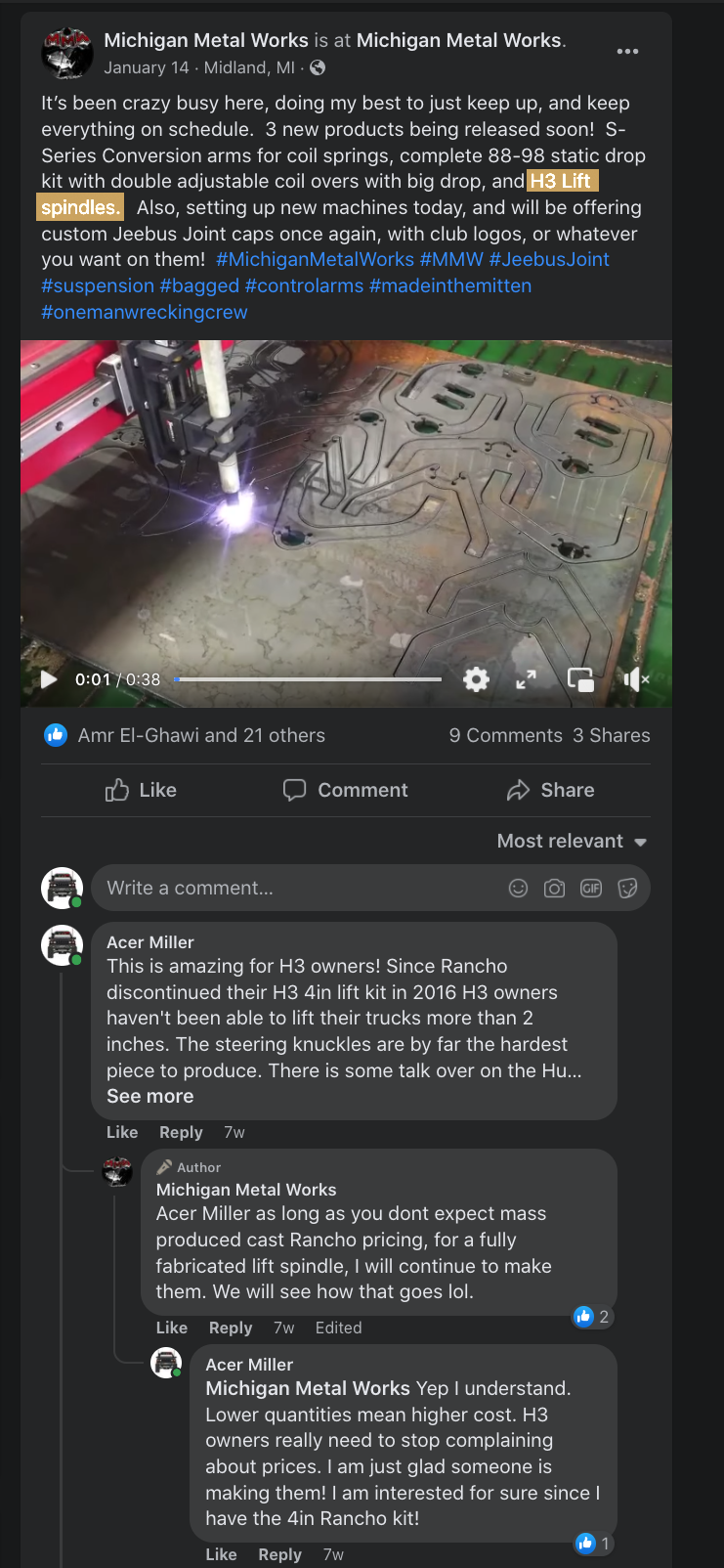

Not just a rumor lol

Well damn, at this point getting the 4 in lift won't be insanely hard to get now on the H3.
Sledder10
12
Mississippi
Wow that is great news from MMW. The only thing missing for a complete 4" lift would then be the LCA drop brackets/crossmembers, correct?
Alpha X
453
The Motor City
I'm splitting hairs here..... Whatever they are making would be considered a lift KNUCKLE, not a lift spindle.
Lift Spindles are for 2WD vehicles. Lift Knuckles are for 4WD vehicles.
The spindle part of a lift spindle is exactly where you want your CV shaft to be.

So out of curiosity, what else would you need to get your hands on to make a lift work beyond what MMW is going to produce? Obviously they aren't building an entire kit, right? Regardless, I'm just waiting to tell them, "shut up and take my money". If anyone from MMW is reading this, you got one guaranteed customer right here
Kuntry
2
Tonopah
PHR is trying to get us a kit together that would be the full lift they r looking at options…. Spoke with them today and they are getting a lot of pushback about price but they r wanting to work with us on making sumthin happen…
atvspeed4
1,211
massachusetts
Curious about what MMW is actually going to produce, is it going to have exact same geometry as the rancho knuckle? What will be done for testing? As Ive mentioned in other threads, we have had the whole kit drawn up in CAD ready to go for years now but when we priced out knuckles it didnt make sense for most people.
