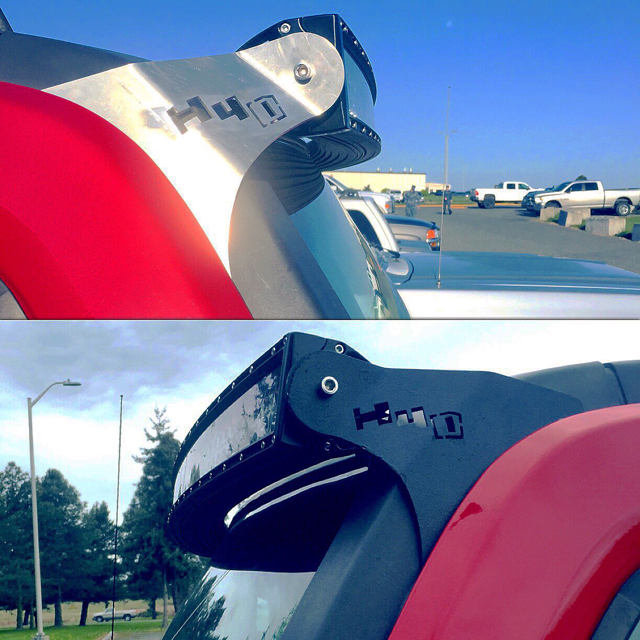

Yea those work but SuperBuickGuy on this forum made a few and they're just as good imo I have a set on my truck ImageUploadedByTapatalk1451891268.196489.jpg
Before and after I painted them I have a 52" curved bar btw

Yea those work but SuperBuickGuy on this forum made a few and they're just as good imo I have a set on my truck View attachment 20301

Does the light bar whistle or add to the wind noise, and how well does the light bar work mounted above the windshield do you get much glare.
And lastly what brand light bar do you have.
Your setup looks super clean.

Yea it whistles but there's videos on YouTube that show you how to stop the vibration/whistle, there hardly any glare that all depends on the pitch of the bar and I forget what brand Cree or something like that
