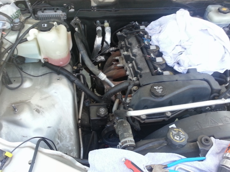

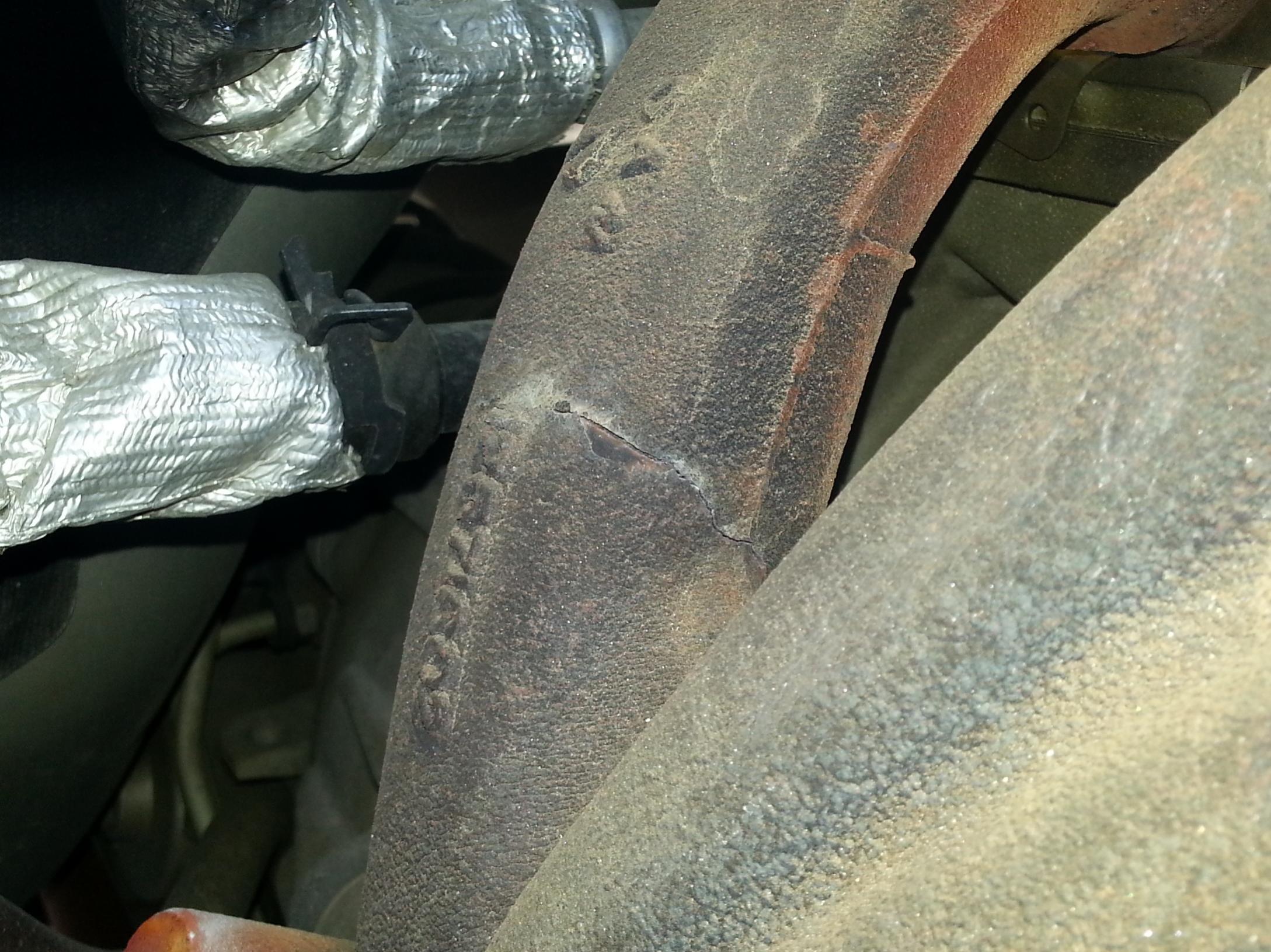

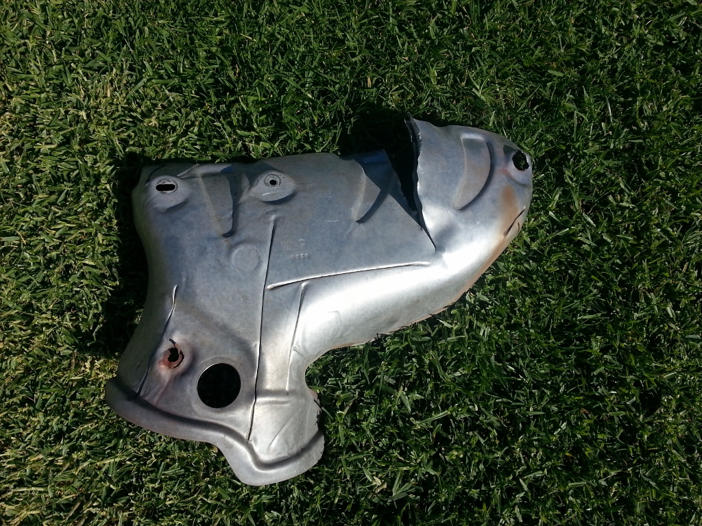

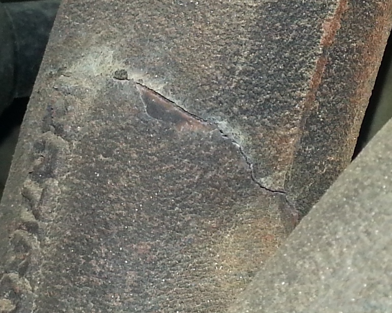

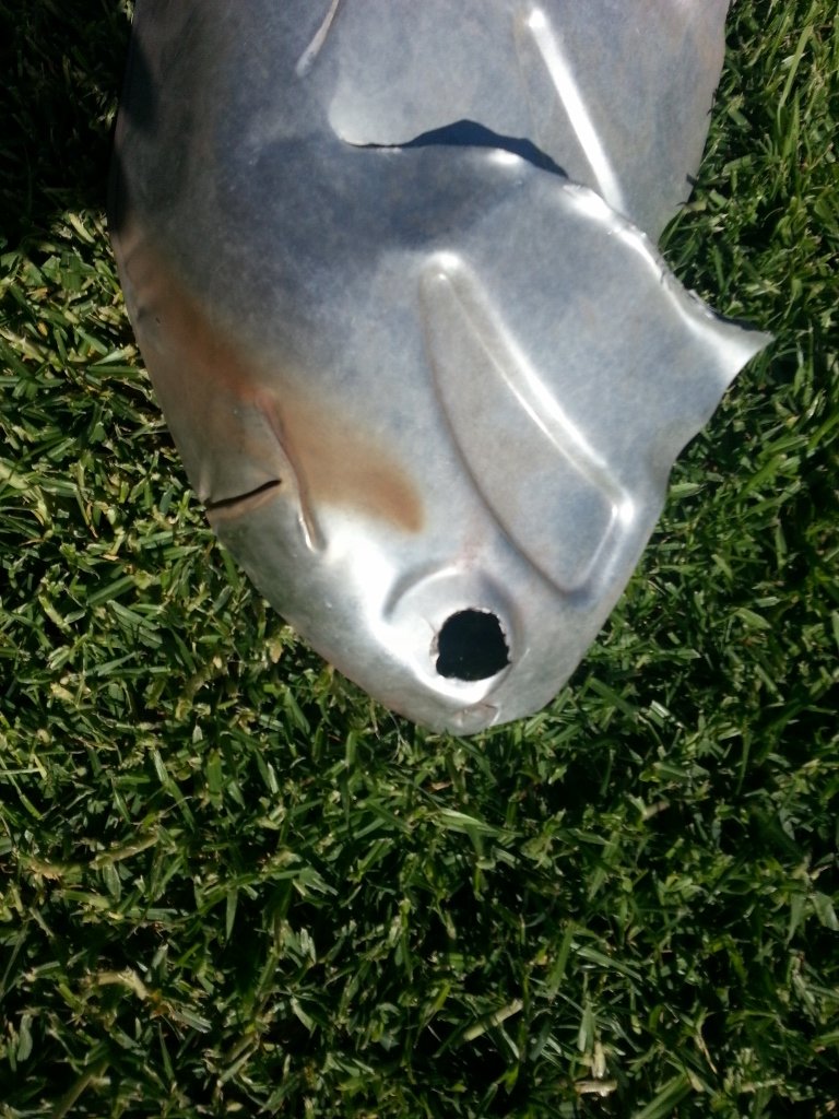

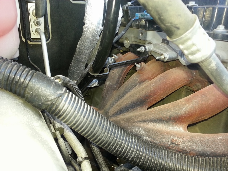

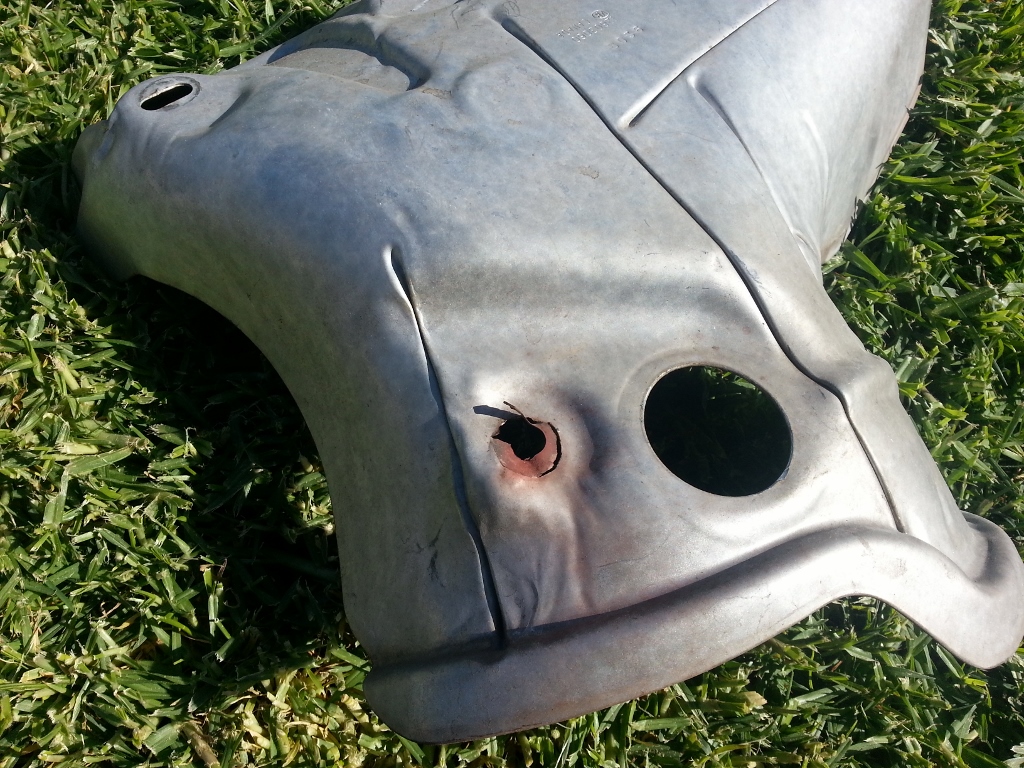

Well pretty sure I found what was throwing my P0171 code today. I followed my troubleshooting steps and have found the problem.....I hope. My next step was to replace the K&N CAI with the factory setup. After everything was re-installed I let it run for awhile and the light came right back. At this point I'm mad as hell so I take a beer and cigar break. While the 3 is idling the constant rattling noise was bugging the crap out of me so I find that it is the aluminum heat shield over the exhaust manifold that has a loose bolt. After closer inspection I find that 2 of the 4 bolts are completely gone, so I decide to just remove the shield and get a new one later. I ended up having to cut the old one with some snips in order to ease the removal. AND WHAT DO WE HAVE HERE....a cracked manifold on #5. So now I am trying to search for a replacement stock or aftermarket header. Don't really care but I would like to get some feedback from those of you that have had this problem or have replaced the stock manifold with a after market one. The next few days will be fun searching. On a side note, I noticed when I was cutting the heat shield ceramic dust was coming out from between the cavity between the aluminum layers. I am very familiar with this stuff and that tells me they put a lot of thought into this layered shield.

I'm staying OEM. I know the CAT will be good quality and the bolts will line up. For me, too much of a PITA to play with an aftermarket one. Do you have an 06? CaseyS had a take-off available.
I'm curious if that crack will be the cause of the code, or if you find another crack further down the line by the cat. Or if it also wasn't sealing well to the head.

alrock it is an 06, I'm thinking OEM as well more because there is so few after market choices out there from what I can see so far. I know price is gonna be up there, supply and demand.

Weird, the 06 OEM one is more $ than 07. 06 has more aftermarket options available, like on eBay. And considering the OEM price, I'd be more easily pushed to aftermarket. It starts being worth the gamble. For me, I'd probably stay closer to OEM style and get another cast iron one, perhaps by Dorman.

Most of what I could find is only 49 state legal. I need on for the tree hugger state of CA. Besides I heard stories from others that some after market cats are made with reused cat that may already be dead.
