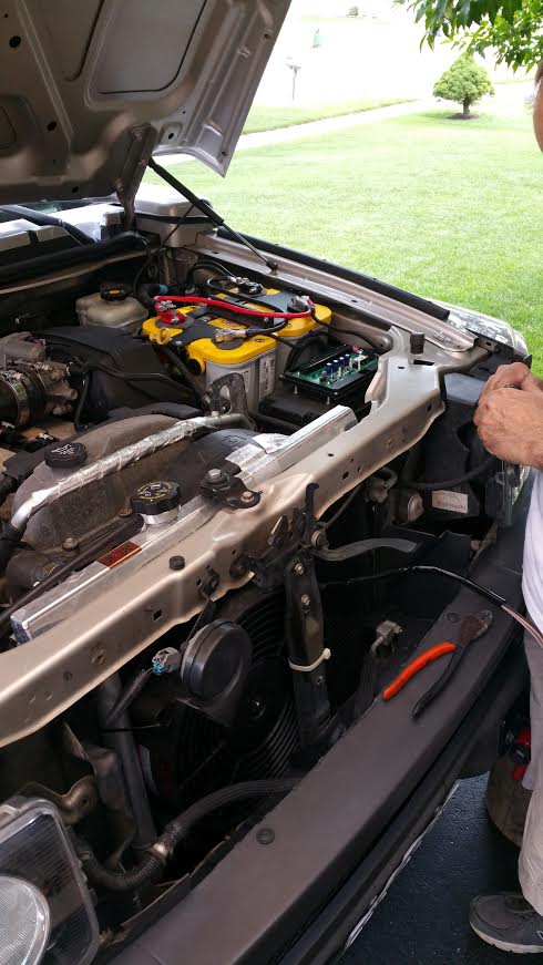

I am running a 12" pusher fan now connected through the SPOD. I turn it on manually when I get in the truck through the touch screen to help with this crazy Chicago heat. With it turned on I have ice cold air even sitting still in traffic and my engine temp gauge has never gone above the half way point. Best $80 ever spent on this truck. Maybe someday I will add a controller of its own but I like the ability to turn it off in deep water crossing.

12" push fan installed photo. It was VERY tight and I used some zip ties and the center bar providing holding pressure.
