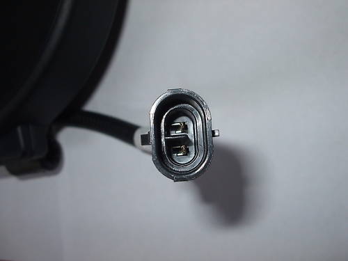

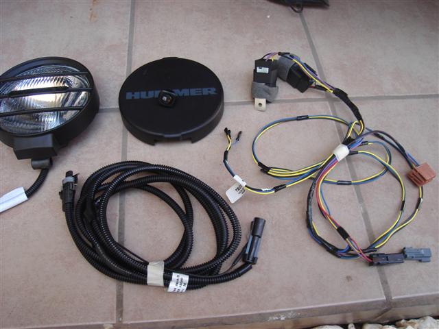

I used to have the part number for this but can't seem to find it :sigh:. I am looking for the part number for the pigtail that plugs into the lights used in the GM Accessories #89006860 and #89006969 kits.
!Bv1!n1w!2k~$(KGrHqN,!i8Ev1+0FFtKBMGNJzdH8!~~_12.JPG2891b8a_20.jpglights 002 (Small).jpg
Thanks in advance,
Corey
Corey,
The male connectors off of the wiring harness for the set of H2 lights that I have mounted on the bg of my T are made by Packard Electrical (PED 25). The female connector off the lights are PED 30. Hope that helps.
The harness part number is 89006863. I bought one of these when I added the second set of lights on my brush guard.
