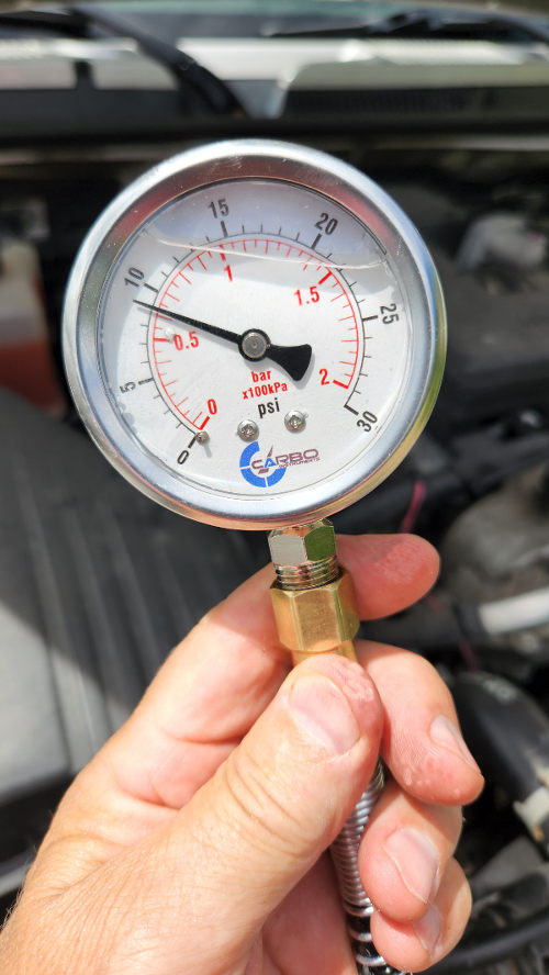

Per the oil pressure: All you're going to get is 'Ok' or 'Not Ok'. The I-5 oil pressure is a simple on/off pre-set "switch", so there's no pressure to 'get'. It's either good, or not good. I'm not sure what spec the switch is set to, but it's pretty low ...pretty sure it's right around 7 or 8 psi (??). The engine in my rig has low oil pressure and I've measured it down below that -- hot idle/foot on brake. Mine's been like that for years. Off idle it goes up to 24-29. So ...bearings are probably bad.
You could put a "T" in the oil pressure line and hook up a dedicated gauge inside your cabin if you wanted. (Use a copper line though). IDK if it's worth it though. If a person's oil pressure is low enough that the oil light is going on and it's *not* a faulty switch, it's time to start thinking about 'next steps' with your engine. Which is what I'm doing with mine.
