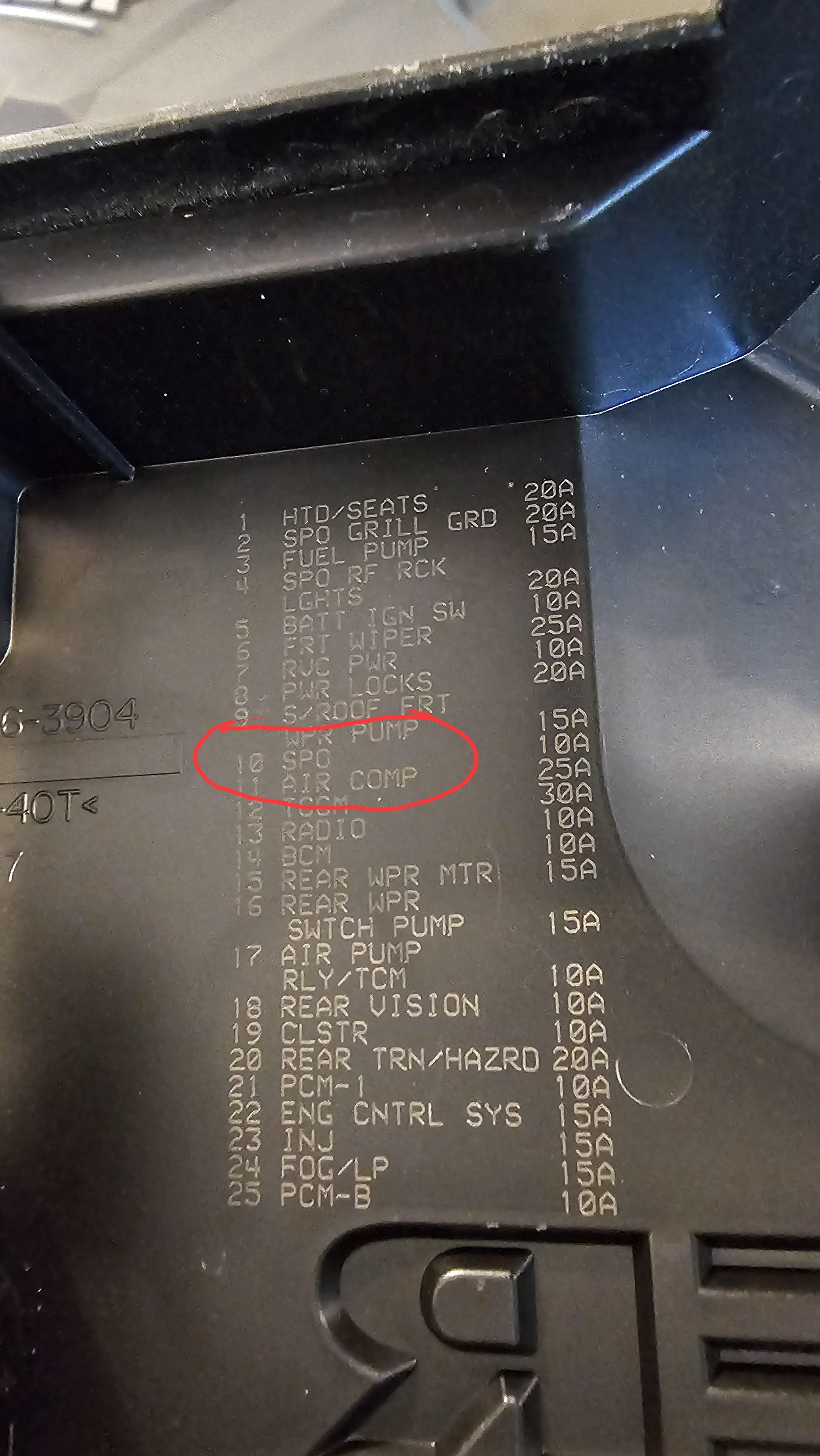

Hello all, haven't needed to post for awhile (other than looking for roof lights) but I'm in the process upgrading my newly obtained '08 Hummer H3 Alpha to LED lighting. I opened up the fuse box to look in to tapping into a free 12v source and noticed that I'm missing a few fuses. Some I know are options I don't have ie. grill lights, roof lights but these two slots 10 (SPO) and 11 (Air Comp) I don't know whatcthey are for. Are these fuses that should be in there or are those options as well? TIA

Ok so I have fully explored this topic before. So in order to use these fuses, what you need to do is find yourself a PT2094 Harness plug (OEM / Interchange Numbers: 88988653). This plug will plug into the buttom of the fuse box. This is a 8 pin GM specific plug that came in the kits of all OEM Roof Lights, Grille Lights, and Offroad Roof Lights. Unfortunately, these plugs have since been discontinued so you are going to have find one used. There could be a few places still online that have this plug for sale. If you happen to go to a junkyard with an H3 in to, you can find these plug connector under the power seats or behind the glove box (part of blower motor harness)
HERE IS THE PIN OUT FOR THE PT2094 for use in the OEM fusebox
Pin 1 = Fuse 43 - Running Lights - Side Marker/Front Running Lights - 10 amp
Pin 2 = Fuse 10 - SPO Ignition (Accessory Shared) OEM Lower Grille Lights (Relay Pin 86) Relay Trigger Only - 10 amp
Pin 3 = Fuse 4 - OEM Offroad Lights Relay Harness (Relay Pin 30 and Pin 86) Relay Trigger and Roof Light Power - 20 amp
Pin 4 = Fuse 11 - Air Compressor (Not used for anything) - 25A
Pin 5 = Fuse 2 - OEM Lower Grille Lights Relay Harness (Relay Pin 30) Relay Grille Power Only - 20 amp
Pin 6 = Fuse 10 - SPO Ignition (Accessory Shared) - 10 amp
Pin 7 = Fuse 10 - SPO Ignition (Accessory Shared) - 10 amp
Pin 8 = Nothing Here - No Pin Present
SPO FUSE 10 connects to Retained Accessory Power (RAP) RELAY
Retained accessory power (RAP) is a power mode that permits the operation of some accessories for up to 10 minutes after the ignition switch is turned OFF. The RAP power mode is enabled by the body control module (BCM). Take your stock or aftermarket radio for example. Even though you have taken the key out of the ignition the radio still remains on until you open your door.
PIN number #2, #6, #7 all share the same SPO Ignition 10 amp fuse which is Fuse #10
FUSE #11 Was never used for anything. I think GM was planning to add a little dealer installed air compressor at some point but that idea never came to be soe you have a free 25amp fuse
