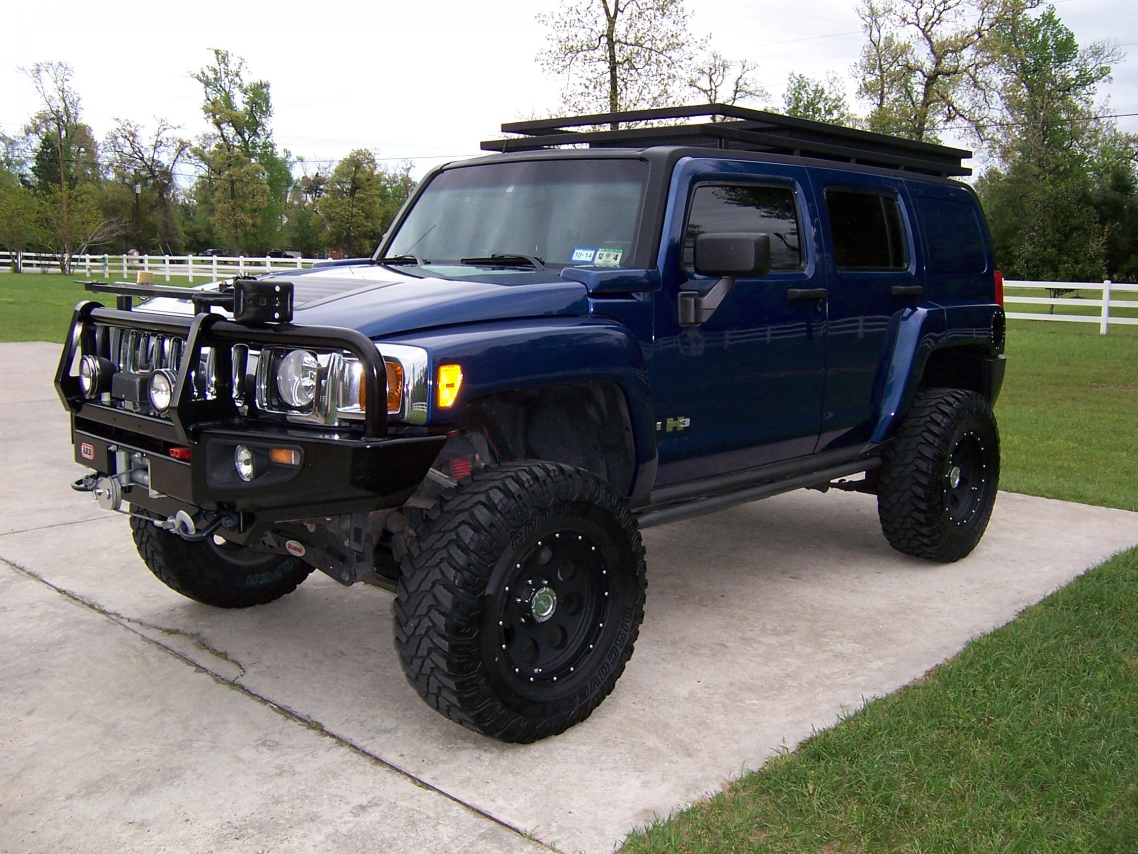

I had chrome wheels, mirrors and door handles, cleaned with alcohol and sprayed with Rustoleum bed liner.
Also used it on the roof trim and rack we built, it's stainless and aluminum. I will be spraying my rock rails lower and rear lower corner trim also.
Holds up to a 3000 psi power washer.

I noticed today, after the truck was parked in direct sunlight for half the day, that I've got some bubbles forming too. I used adhesion promoter on everything. But it was only on the mirrors and a handle or two.
I've never seen your rig before but it is super nice!
