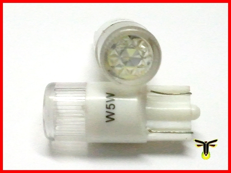

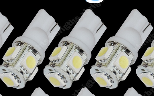

I've been planning for some time now to replace my instrument gauge bulbs with a brighter LED. Most of them are 194 bulbs. I've replaced the voltmeter, oil pressure, water temp, and fuel. Nice and bright! The clock was next but the LED bulb is too long. 28mm. It was about 2mm too long. I have another I'm going to install later. That one is 20mm. Plenty short enough. I haven't replaced the speedo or CTIS bulb yet. My biggest problem is the RPM gauge. That has a small grain of wheat bulb that's built into the gauge face. I don't think I can replace that. Or... Can I? Reading around the forum, I haven't found anything about that yet.
