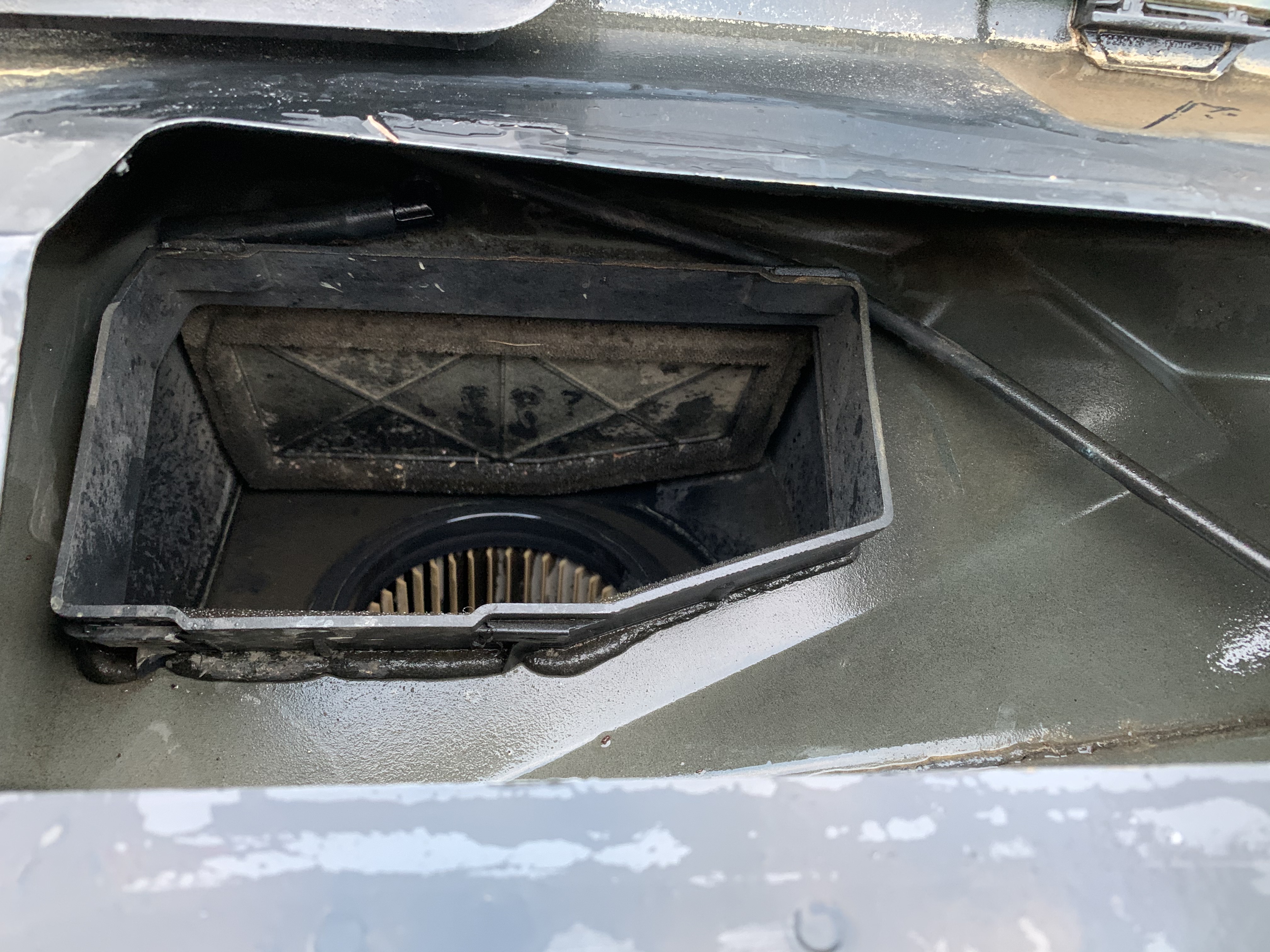

So let me not jump to conclusions as I have the last 3 times I made this announcement.
But I found a major source of water intake into the cabin, hopefully it is THE source.
The pictures below show the cowl removed with the removable cover for the A/C system up, and then moved. I looked in this spot for the water troubles in case the sunroof drain was exiting into the air box some how, instead I found that it was routed seemingly appropriate away from the air intake box. I also hosed the area around the box to check for leaks and it remained dry on the interior
What I did notice is that the lid for the intake, shown in the lifted up position - had a very weak rubber seal that has begun degrading. Reattaching this cover I hosed down the area and started watching the interior, lo and behold the water started coming into the interior
Once I stopped the hose flow I again removed the lid and the water box was filled with water.
I believe the lid is not sealed and allowing water to drip down into the air box. I will be RTVing the air box shut to prevent future leaks
Good find I’m gonna check it
