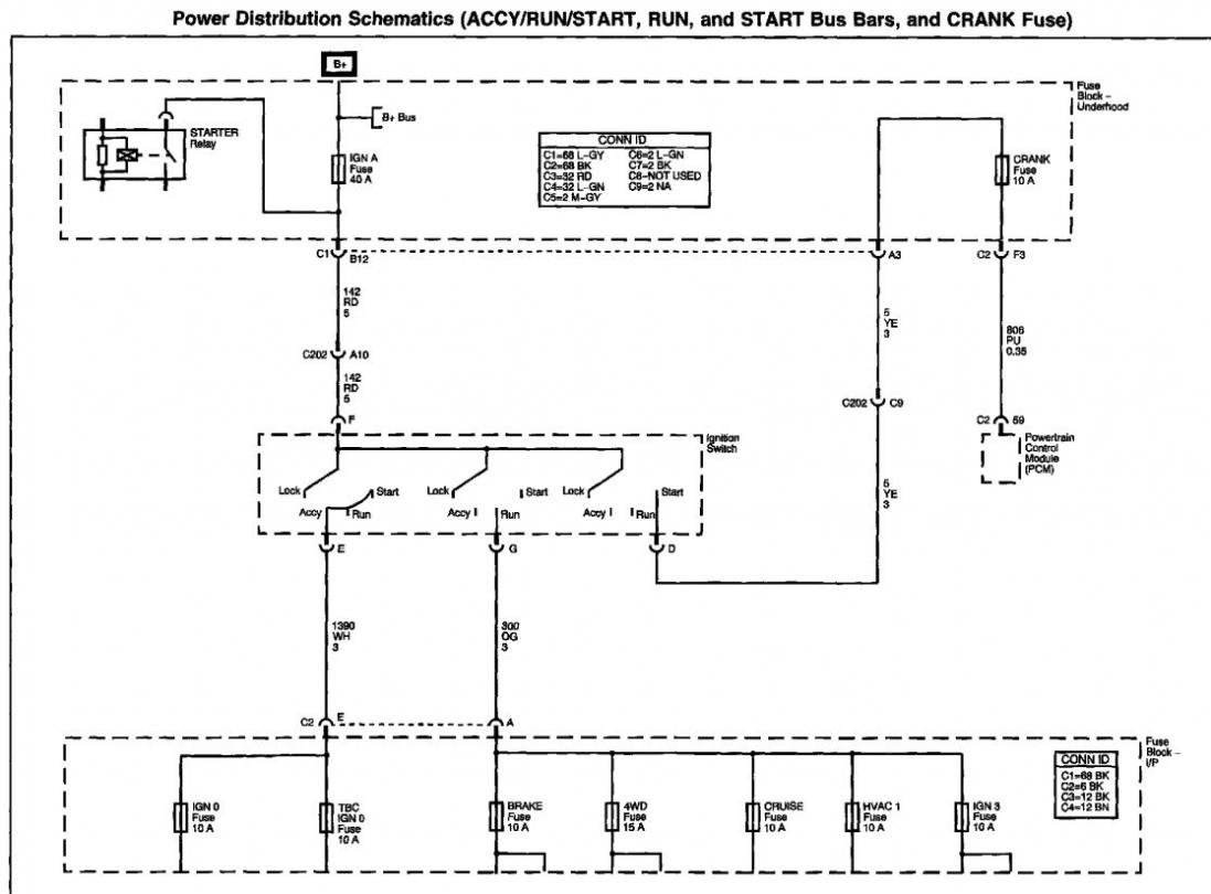

So you did replace the entire switch like I said on the other forum? If you did and its still doing the same **** then something else besides the stock truck is taking over.
That ignition switch physically seperates those functions. Even if you had some smashed/pinched wires in the steering column...It wouldn't cycle through like that video.
Like I said in the other thread, I bet you have a remote start or alarm on it. What the hell is on that keychain in the video??
You never did explain anywhere- Did you just get this truck? Whats was done on it last before this started??
You need to get under the steering wheel, and look way up in the dash for a box spliced in. The box could be as small as a deck of cards- look for wire splices, heat shrink tubing or electrical tape. Its a big area, maybe get a couple people looking, sometimes its right in front of your face. Maybe there is a toggle switch under the dash or general area or a indicator light...follow those wires. Gotta be in there.
