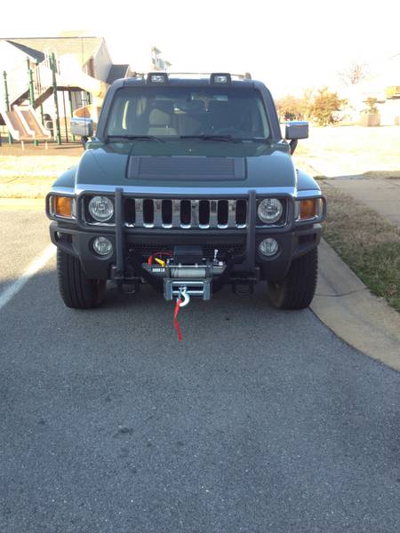

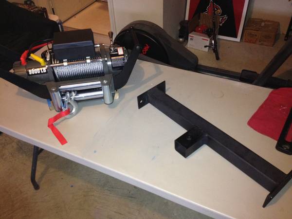

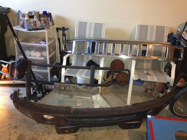

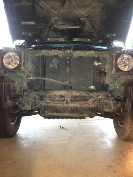

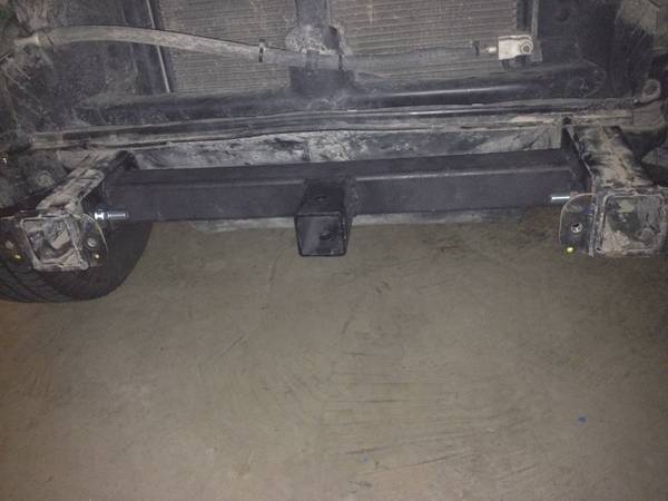

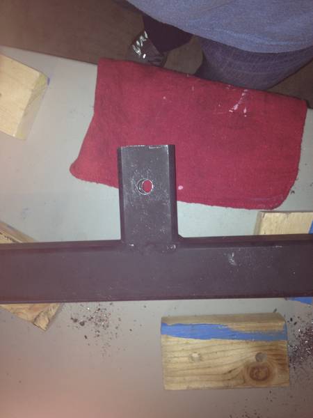

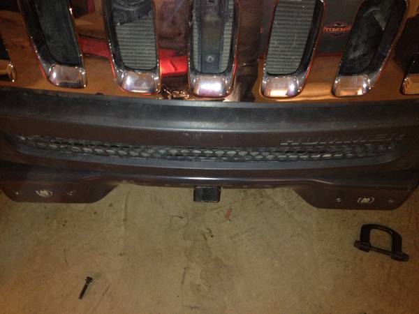

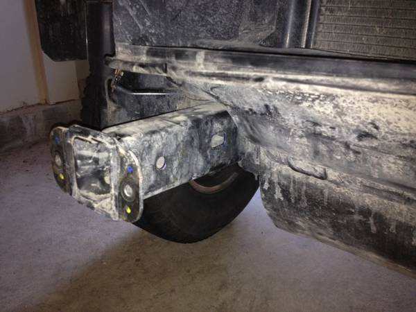

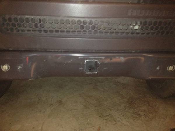

Hi everyone i know i am new here but i thought i would share what i have been doing recently in case someone else would want to do this too. I wanted a way i could attach my winch so i could take it on and off and also wouldnt mess with the approach angle, so this is what i came up with. ive only seen one other one on an H3 and that was the white MOAB H3 the only problem was it stuck out pretty far and i didnt like the looks of it so i Fabed my own! it wasnt as hard as i expexted, i did it in a tiny military garage. I used 1/4in plates and 2 1/2 Square steel tubing and welded it to what you see here, i also used 4 1/2in bolts to attach it to the frame. I hope this helps!

If I ever pull the trigger on getting a winch, this is how I want to do it. I do not like the idea of hauling all the weight around unless I am wheeling. It also gives you an easier opportunity to relocate the winch to the rear provided you put a power plug back there.
Thanks for sharing!
9,505
I also like how it braces the frame and gives it some added strength
