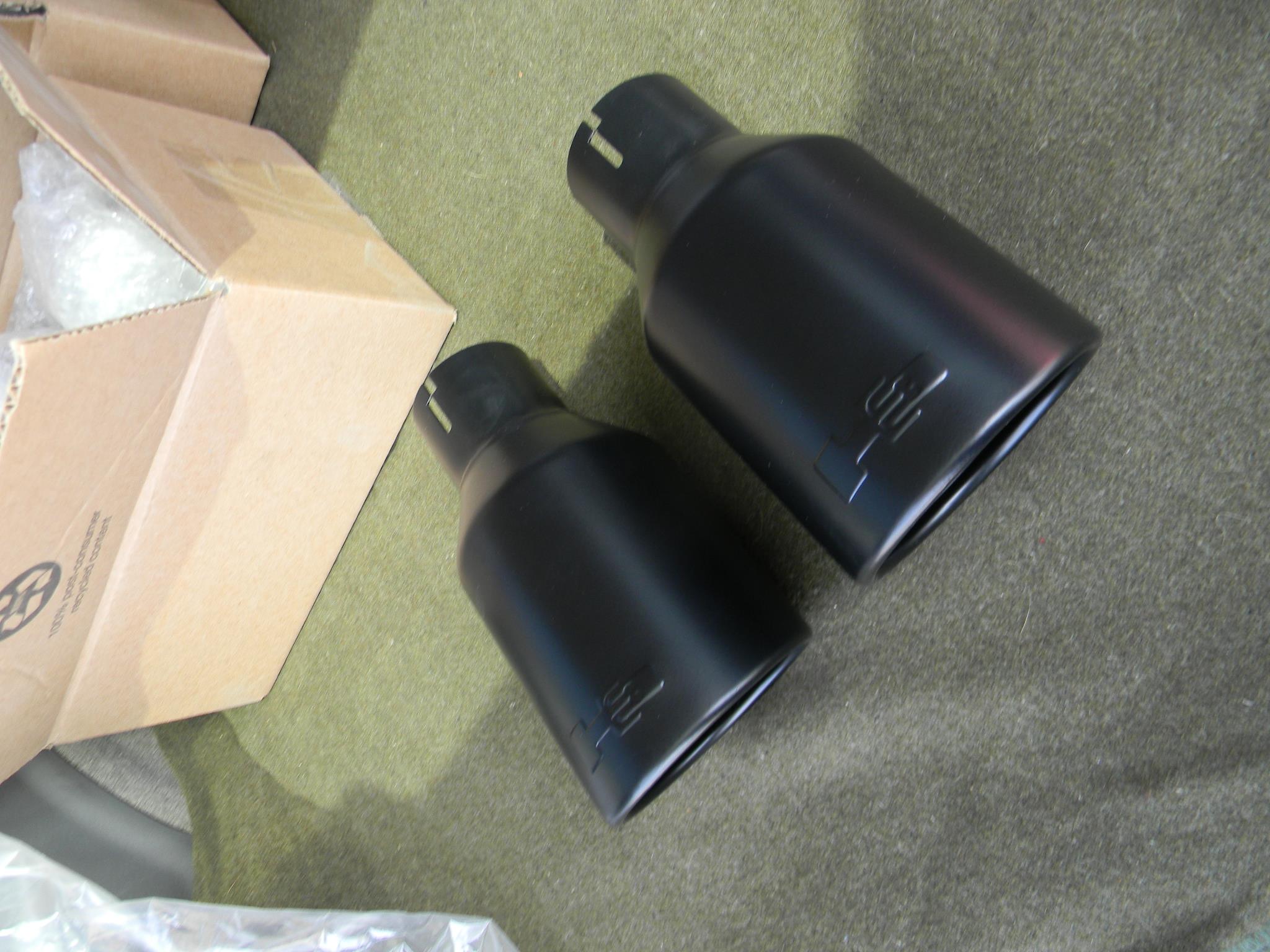

The GM Performance exhaust has removable tips (actually sold without tips) and is made by Borla. The touring system would give you the mellow sound you are after. The system (without tips) list for $1002. I actually got mine off eBay a while back and paid 85% off list.
The GM Performance exhaust has been discontinued and Borla is having a clearance sale on them right now for $368.55. You can also buy the tips separate (3 styles available and there all embossed with the H3 logo) and can remove them before offroading (this is what I plan on doing).

Pictures
I had my tips powder coated matte black

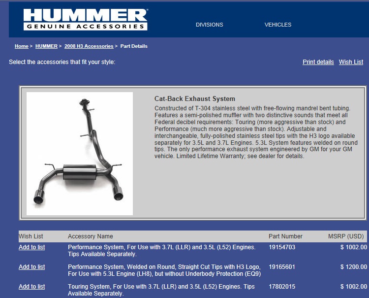

Yes, that is the Touring system (has resonator and larger muffler) and it will fit all 3.5L and 3.7L H3's. The GM Acessories page for Hummer has been taken down but here is a screen shot form the page I have saved on my computer.
The GM Performance Touring system with tips is $460.13 shipped to your door and the cheapest Magnaflow I found on eBay was $474.52 shipped. So the touring exhaust is $15 cheaper and wouldn't require an modification to have removable tips. I am not telling you to buy the Borla/GM Performance system, just stating the pluses as I see them.

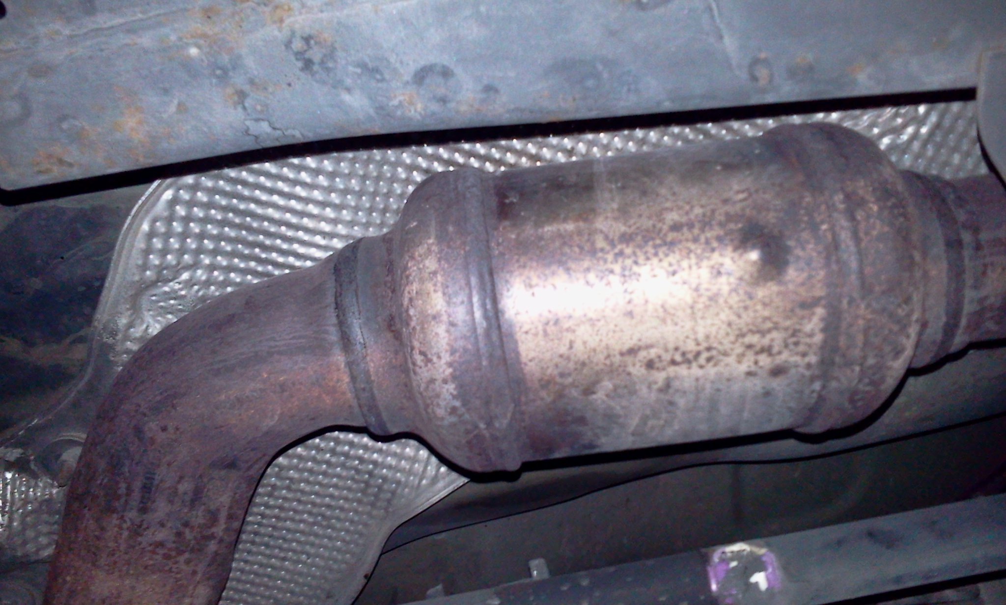

I am using a Billy Boat exhaust 3.5 double wall tips ( http://www.bbexhaust.com/suv/h3/ ) and the product is very good but I would like to add a powerful deep tone. My friend suggested to remove the resonator (kind of oval thing, see photo and photo part 1) and put a straight pipe. What do you think? Thanks

The picture that you put is of the catalytic convertor, the resonator is bigger and more oval. If you go from the back of your truck, it is the oval muffler looking thing after the muffler. Removing it will make it louder, but I think the billy boat cat back doesn't have a resonator, I don't know though

Ron are 100% sure? Probably when the mechanic installed the B&B he removed the factory resonator. The thing is that the oval thing that I posted before doesn't have any O2 sensors around it... Thats' why I was thinking it was the resonator. The Billy Boat doesn't have a resonator. The parts of the B&B are the following
10,669
Ron46 is correct - that is a catalytic converter. There are two cats in the H3 exhaust - one that is a part of the exhaust manifold and another further downstream towards the rear of the truck.
