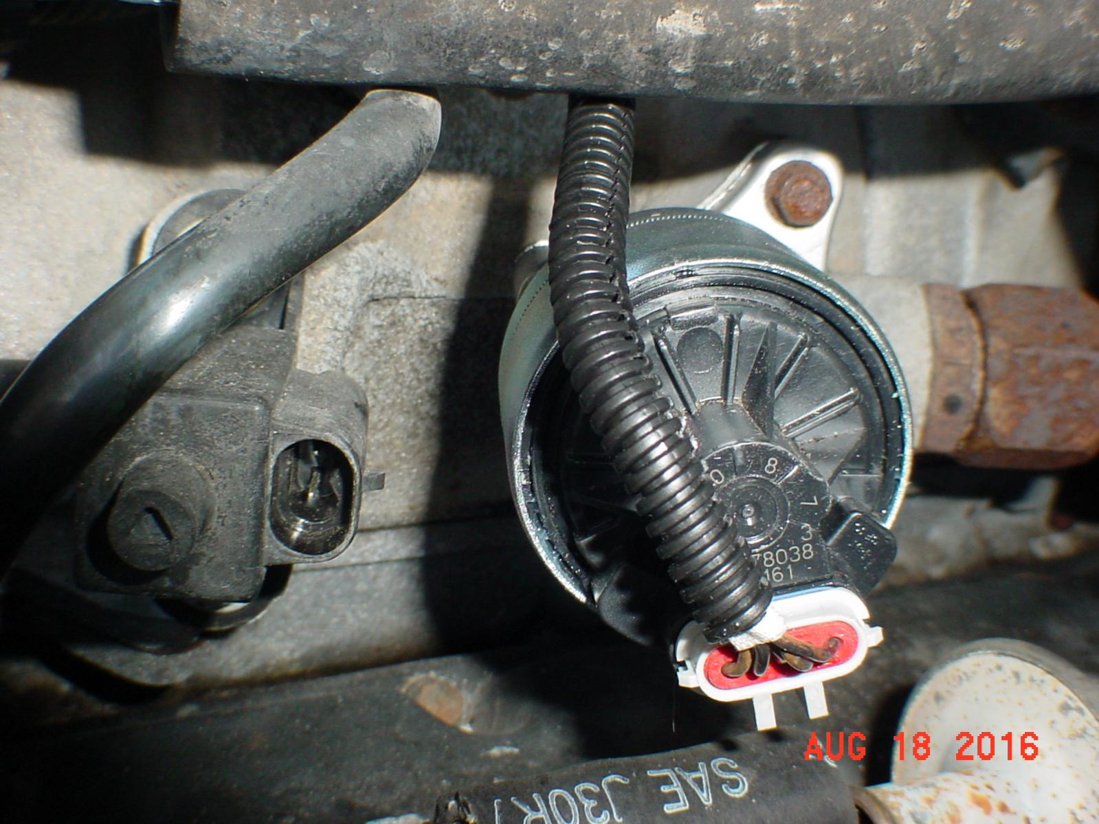

I found a truck that was sitting non-op for two years. It has all the HD parts; 7.4L, 4L80E trans, and full floater rear diff. The PO claimed it had a GM replacement engine 35K ago so I thought that would make this project truck worthwhile. So far I've replaced the brake booster and MC. I'm cleaning years of grime and dirt and it seems I'm making progress cutting through the layers. I've used up two bottles of Castrol Super Clean so far. I normally don't like to use a cleaner this strong but in this case it's definitely needed.
The wiring was damaged and I was able to find GM Metripack connector kits online so I purchased one. The added plus is that the business that sells these kits is based in Grover Beach and so not only are they close to me but they have been extremely helpful with some of the wiring issues I'm dealing with so far. The EGR valve plug was destroyed and I was able to replace it without having to start splicing wires.
One of the problems I noticed was that the AC condenser was packed with oiled dirt that I was able to cut through with the Super Clean. This truck must've had some cooling issues before it was parked. I've got the grill and bumper pulled to repaint the front of the radiator panel and associated parts at this stage of the rehab.
