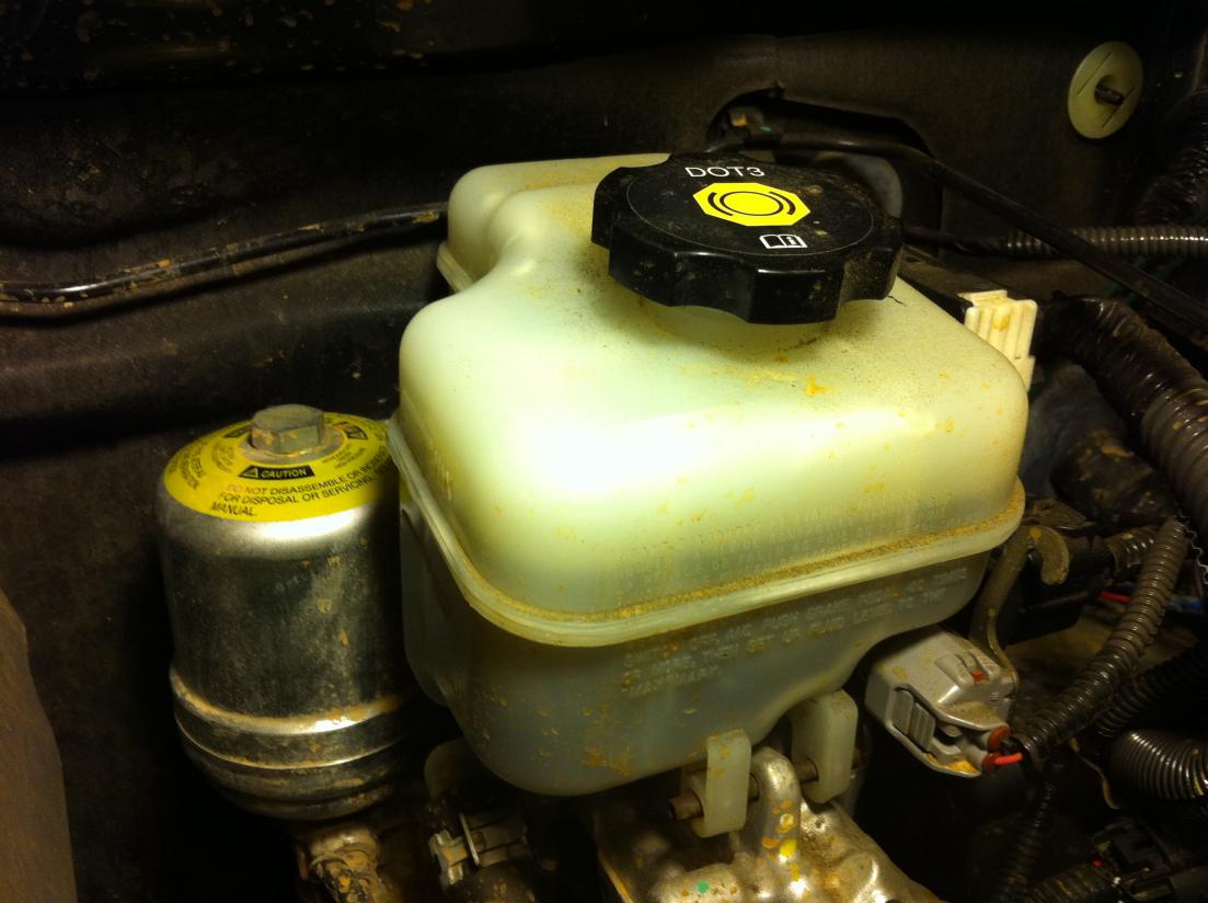

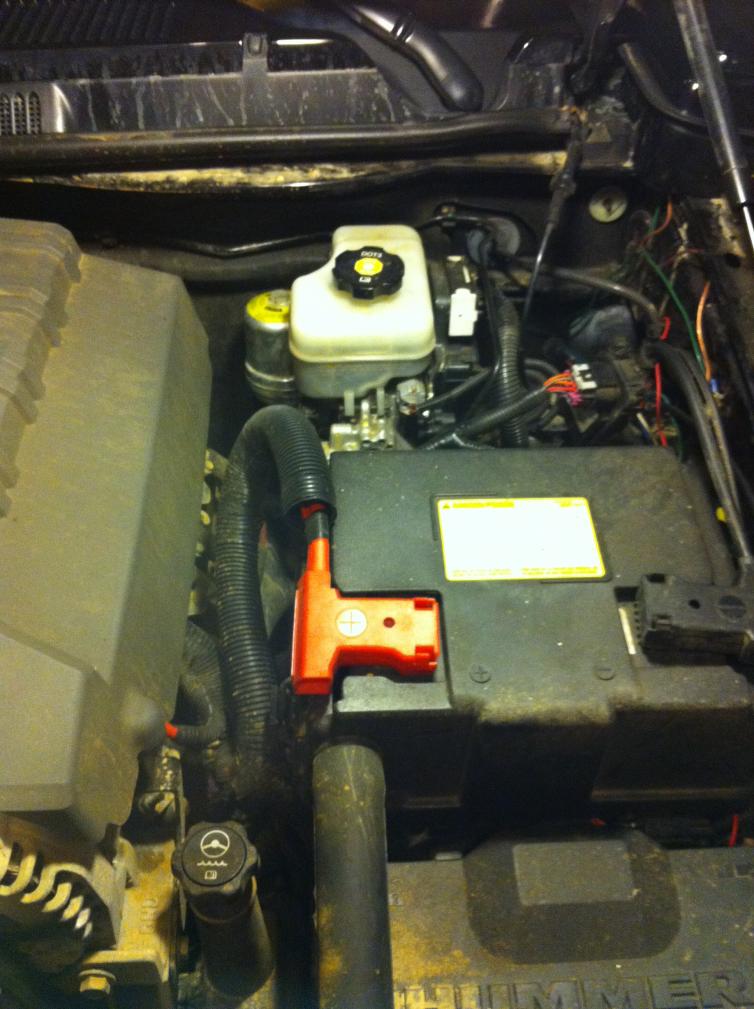

I own a 2008 Hummer H3 Alpha and have recently noticed a strange noise, almost like a humming sound, coming from the engine compartment when I apply the brakes. Not sure if this is a normal noise that I have just picked out, or if this is a new problem that needs to be repaired / replaced. The item is located next to the power brakes reservoir...a "canister." Can anyone help me out in identifying the mysterious canister, and let me know if it is supposed to be making a noise when the brakes are applied. Thanks in advance!

Instead of vacuum boost, the H3's have an electric motor to boost hydraulic pressure. I hear mine sometimes upon startup if it has been sitting for a while. It is also used to boost pressure in emergency braking. With the ignition on and the engine off, pump your brakes several times to to see if the same noise you are hearing when driving. I normally can't hear mine with the engine running. I have a 10 Alpha. The cannister in your photo is the Power Brake Booster Pump Fluid Accumulator.

that canister is an accumulator that stores pressurized fluid for the braking system. The humming is probably the electric motor use to boost the brake pressure. Most vehicles in this class use a vacuum boost system, the H3 uses electric boost system. (Nice for when you are towed back, all you need is the ignition on to keep braking.)
