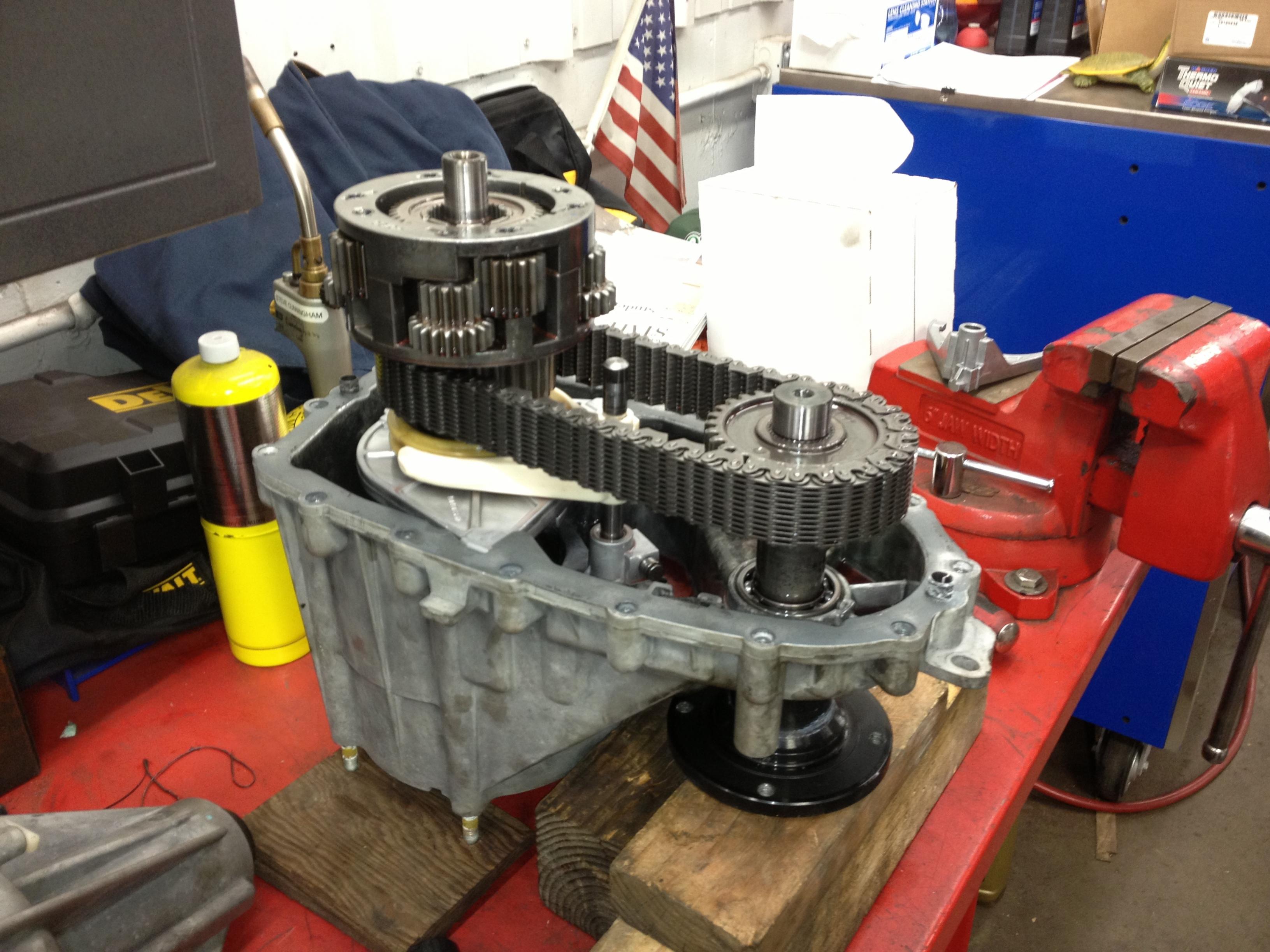

I have some pics to post if I can get the I-pad away from Mrs reloader who is hooked on that damned candy crush game.

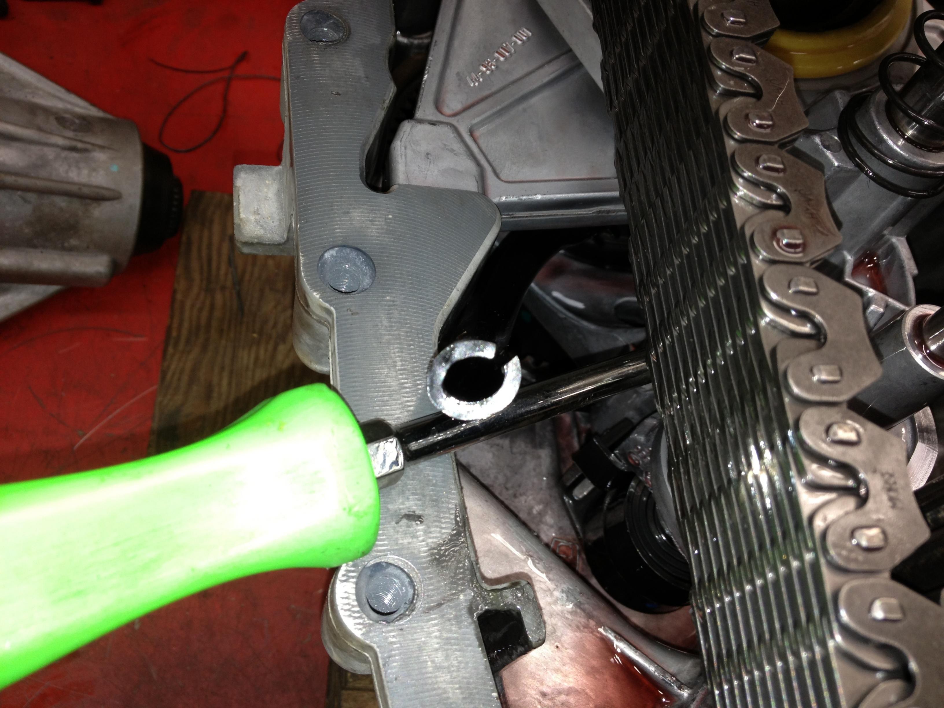

image.jpgimage.jpgView attachment 12895Some pics from one of my H3 transfer case overhaulsView attachment 12885
