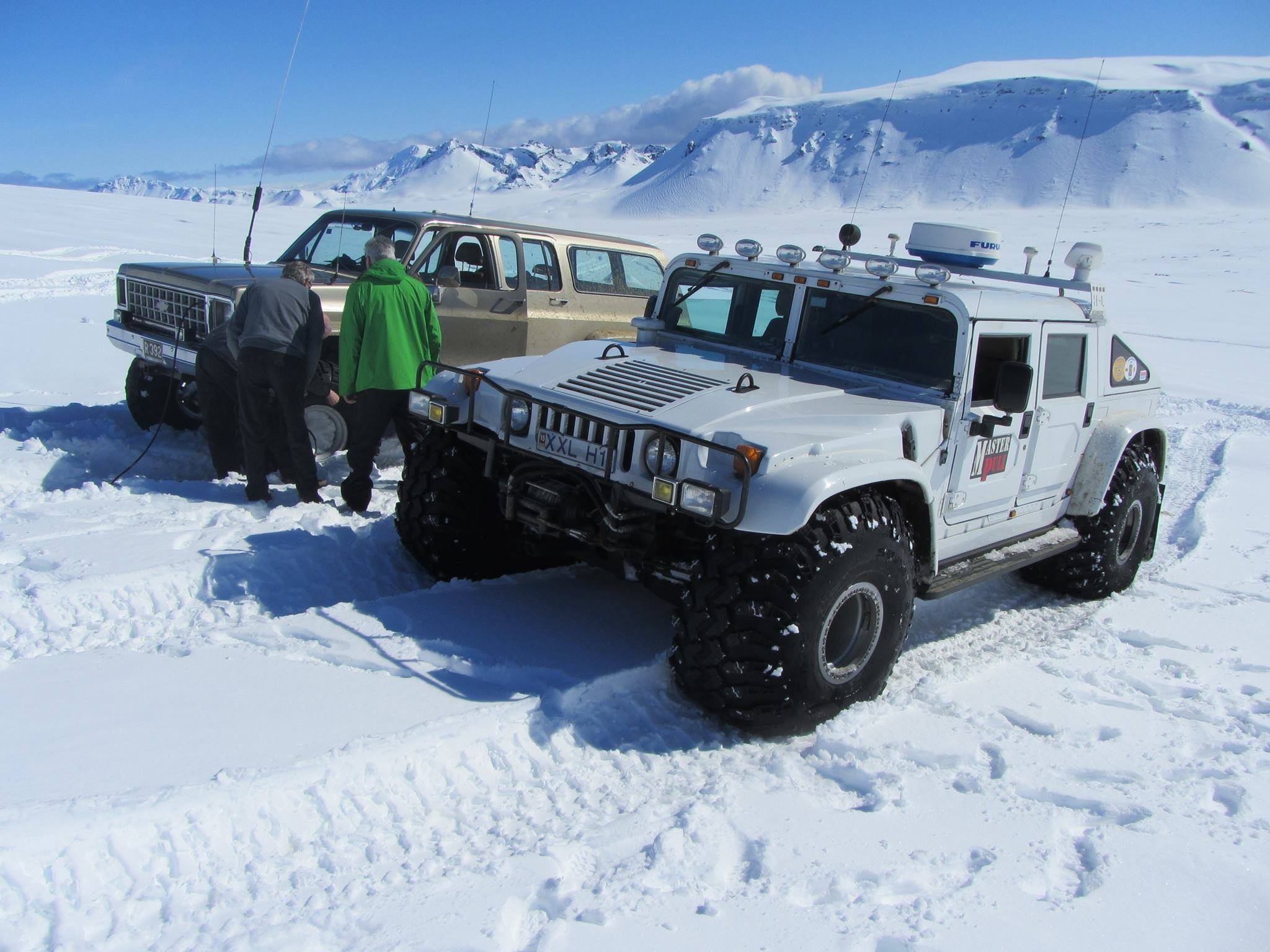

Here's an H1 converted like you want! It belongs to Master Pull and they use PullPals for snow anchors Hunner. :D
"Ex Umbris Venimus"

Love the Arctic H1. Ground or snow clearance is very important in snow. When you start plowing snow with the undercarriage is when you usually come to a stop. The H1 has great ground clearance and it is diesel so it would make a great snow vehicle. I also love the Navigation radar on the roof.
I'd like to know what Master Pull did to it besides the obvious tires and fender flares.
