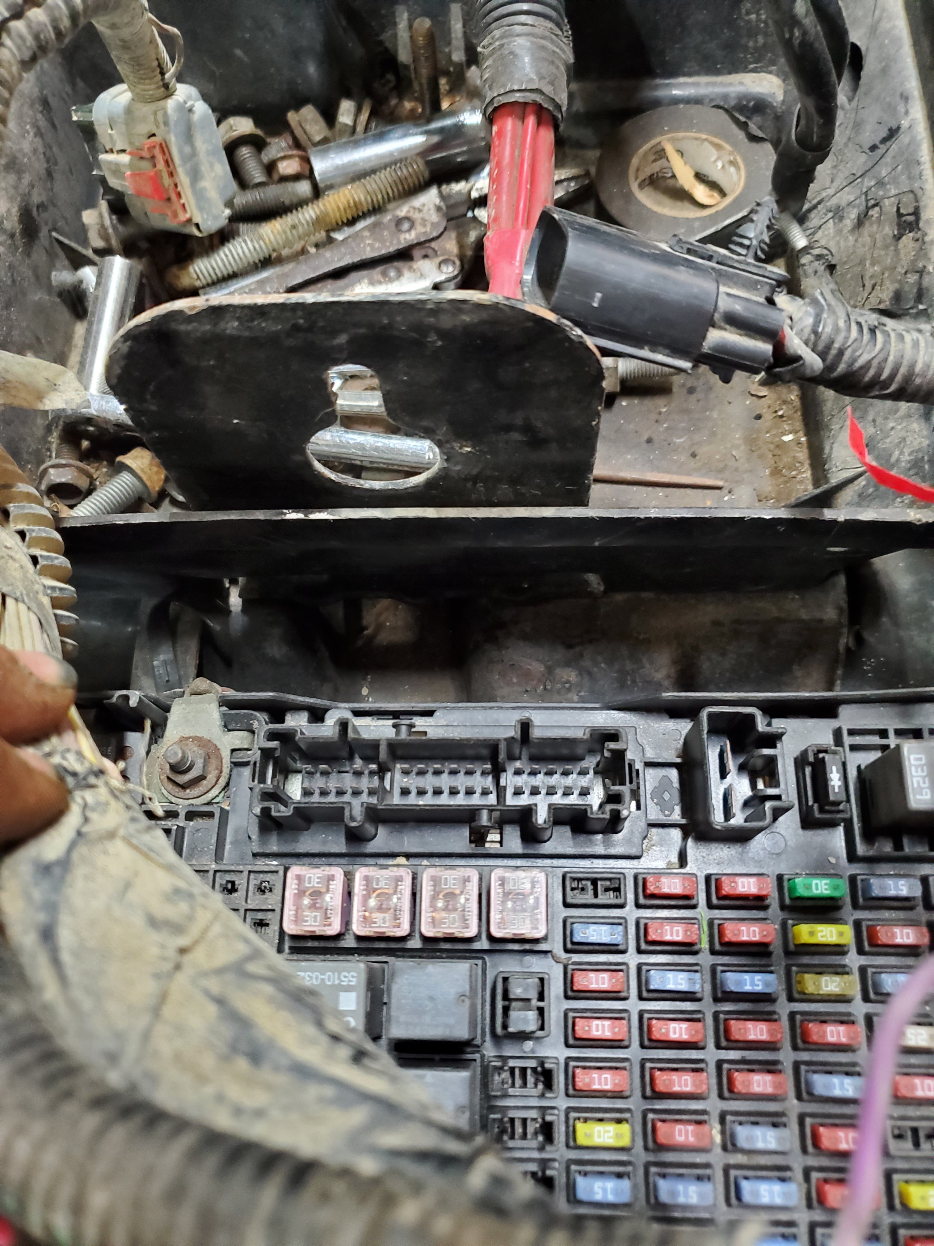

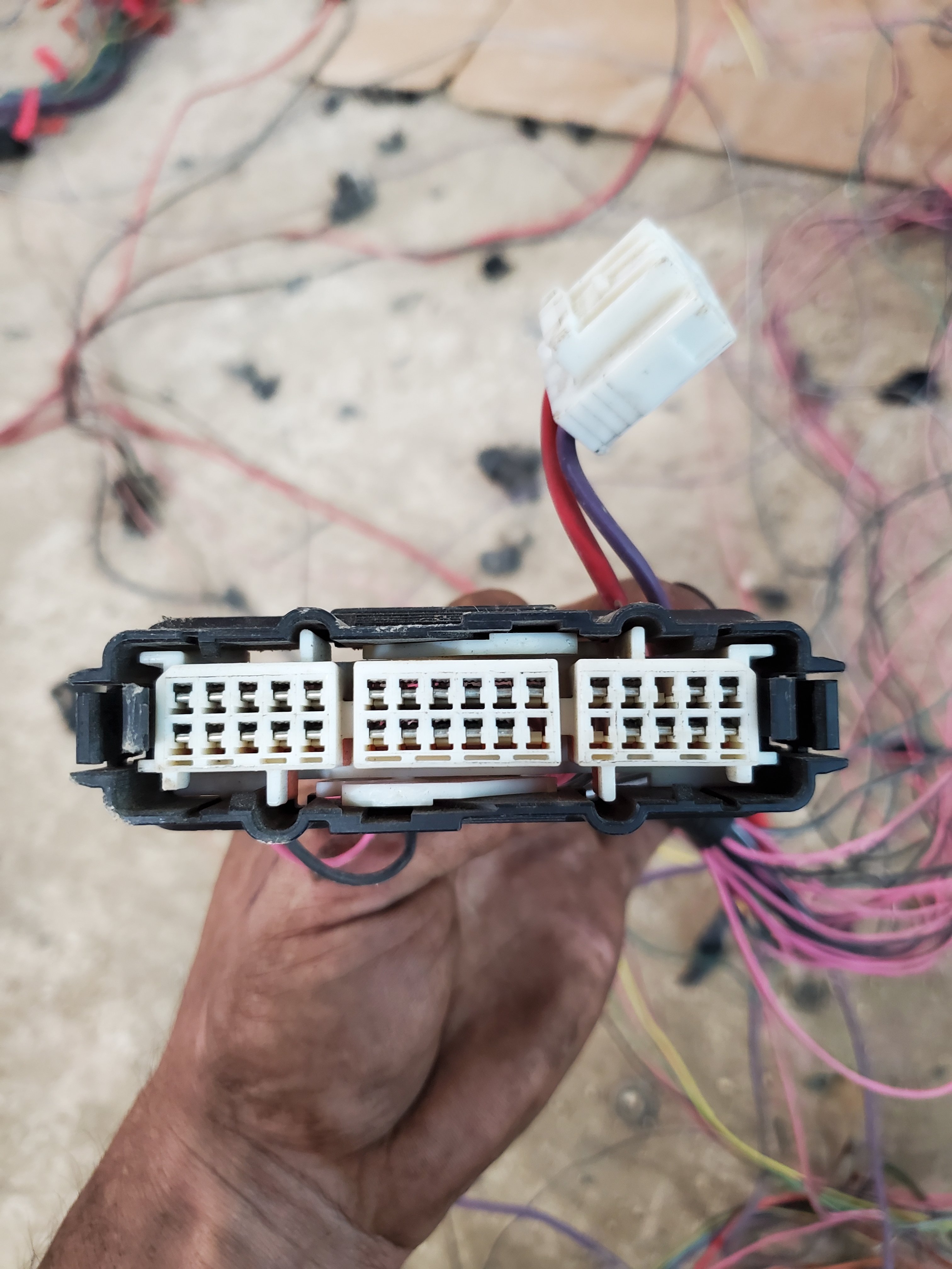

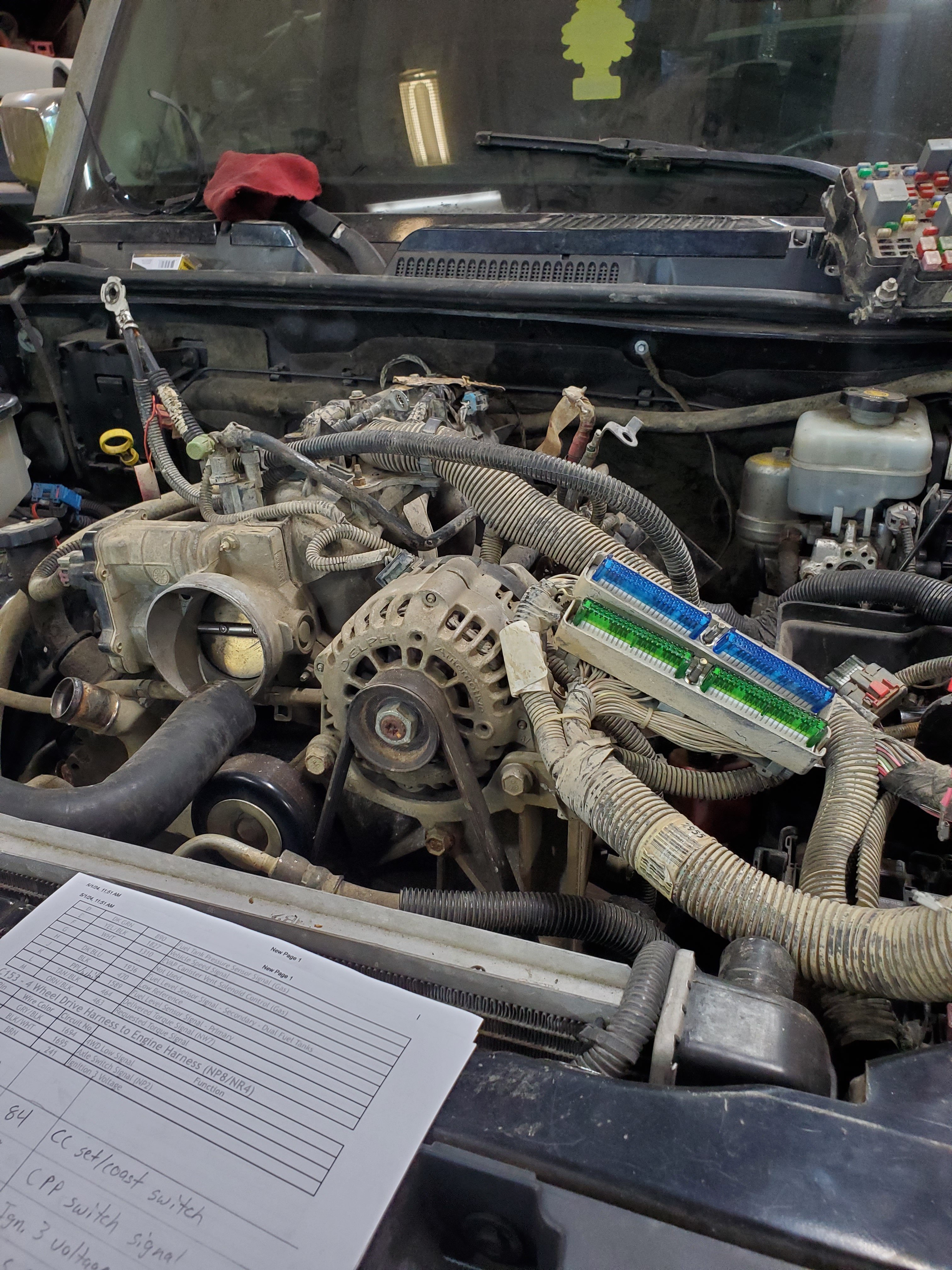

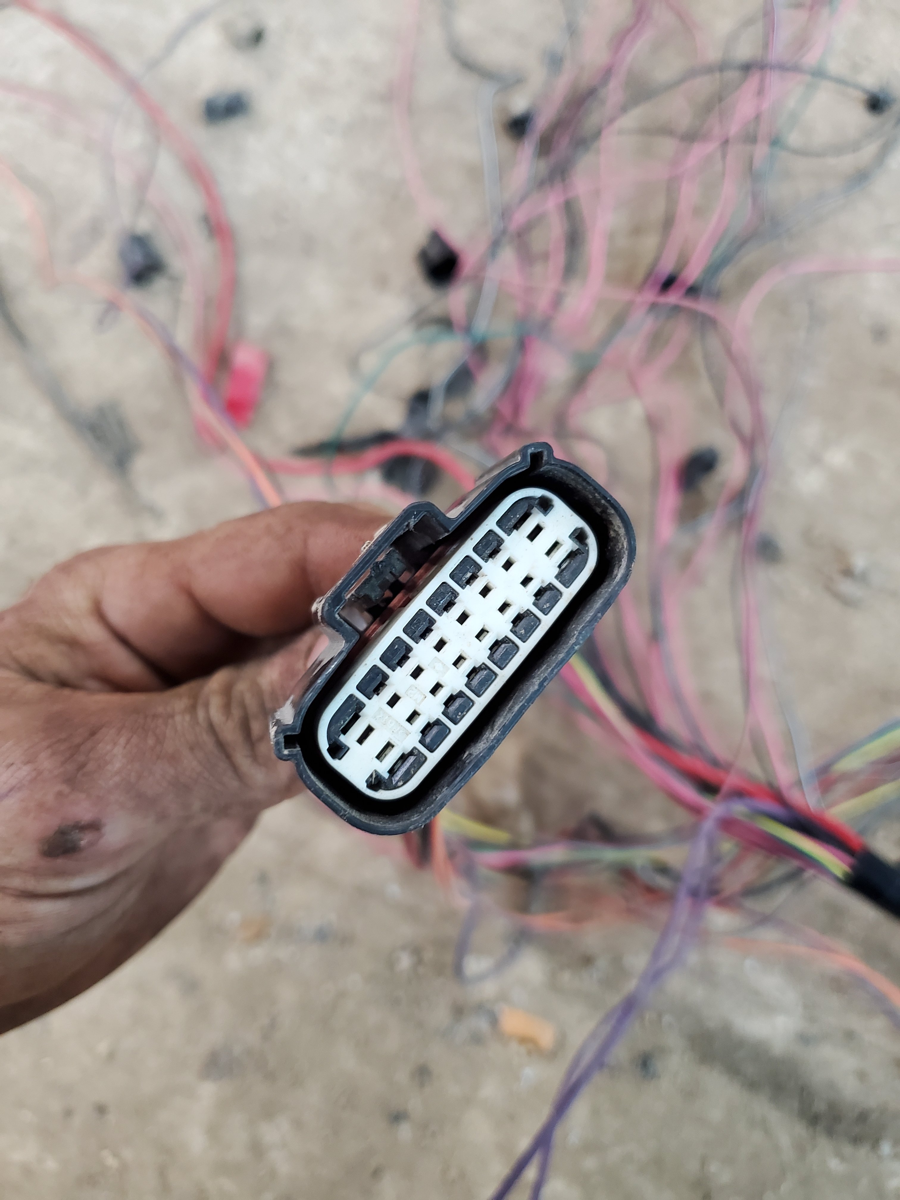

Hey guys, doing a 5.3 swap on an 07 h3 with 3.7. I've got most everything figured out except for I cannot find the c3 connector at fuse block and the c125 body harness to engine harness connector pinouts. This is the last bit of information I need and I have searched all over and can not find them. Please help!

He has links to PDF's down at the bottom of the page. 2006, 2007, and 2008 wiring diagrams are there and they are complete and showing wire color codes and pin positions on the connectors. I'm not aware of any wiring changes for the 3.5/3.7 between the model years.
