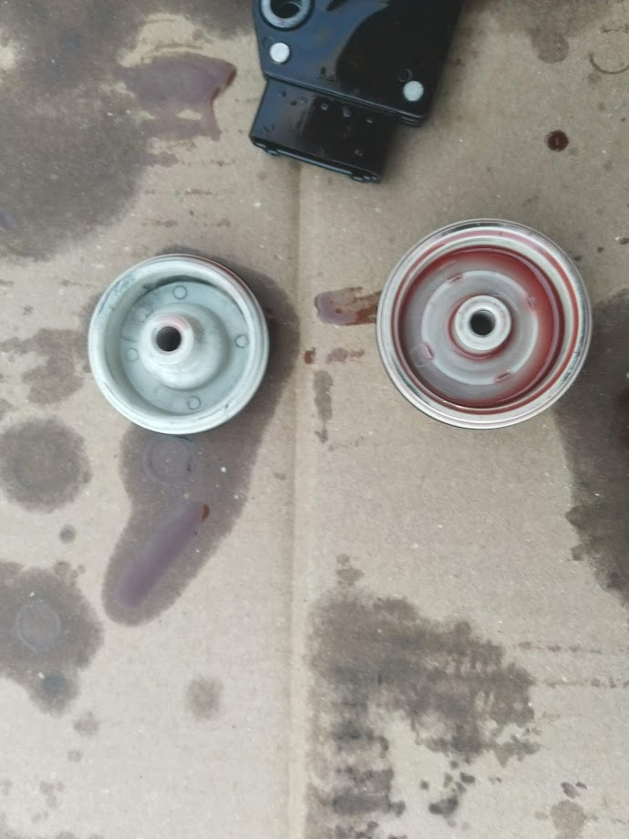

2. The forward Accumulator piston with a Sonnax Pinless piston on the valve body (remove plastic piston). As a side note, this kit does remove the guide pin for the piston. The kit includes a ball bearing which you use to block the hole and then gently stake in. Meaning, tap in the ball with a punch, use a chisel around the opening to make indents to block the ball from backing out. Sounds tough, was super easy. The pin is removed becuase the new piston is longer and has two seals, making it stable in the bore; it no longer requires a guide pin for stability. It also seals better!
I can confirm the new ACDELCO rebuild valve body listed above comes with a plastic piston. Get rid of it and use this instead:

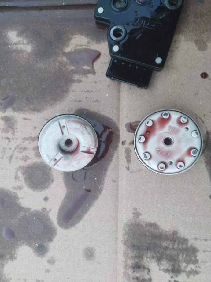

3. The 1/2 and 3/4 accumulator pistons with Sonnax pinless pistons (Same reason and to add new seals). The kit includes a ball bearing which you use to block the hole and then gently stake in. Meaning, tap in the ball with a punch, use a chisel around the opening to make indents to block the ball from backing out. Sounds tough, was super easy. You only block one port even if you are replacing both pistons.
These also worked.

Here are a couple of pictures. A couple of the plastic accumulator pistons and one of the original valve body. I will take a couple of more pictures of the old valve body tomorrow for reference.
IMG_20181208_165831.jpgIMG_20181208_165826.jpgIMG_20181208_165816.jpgIMG_20181208_122008.jpg
