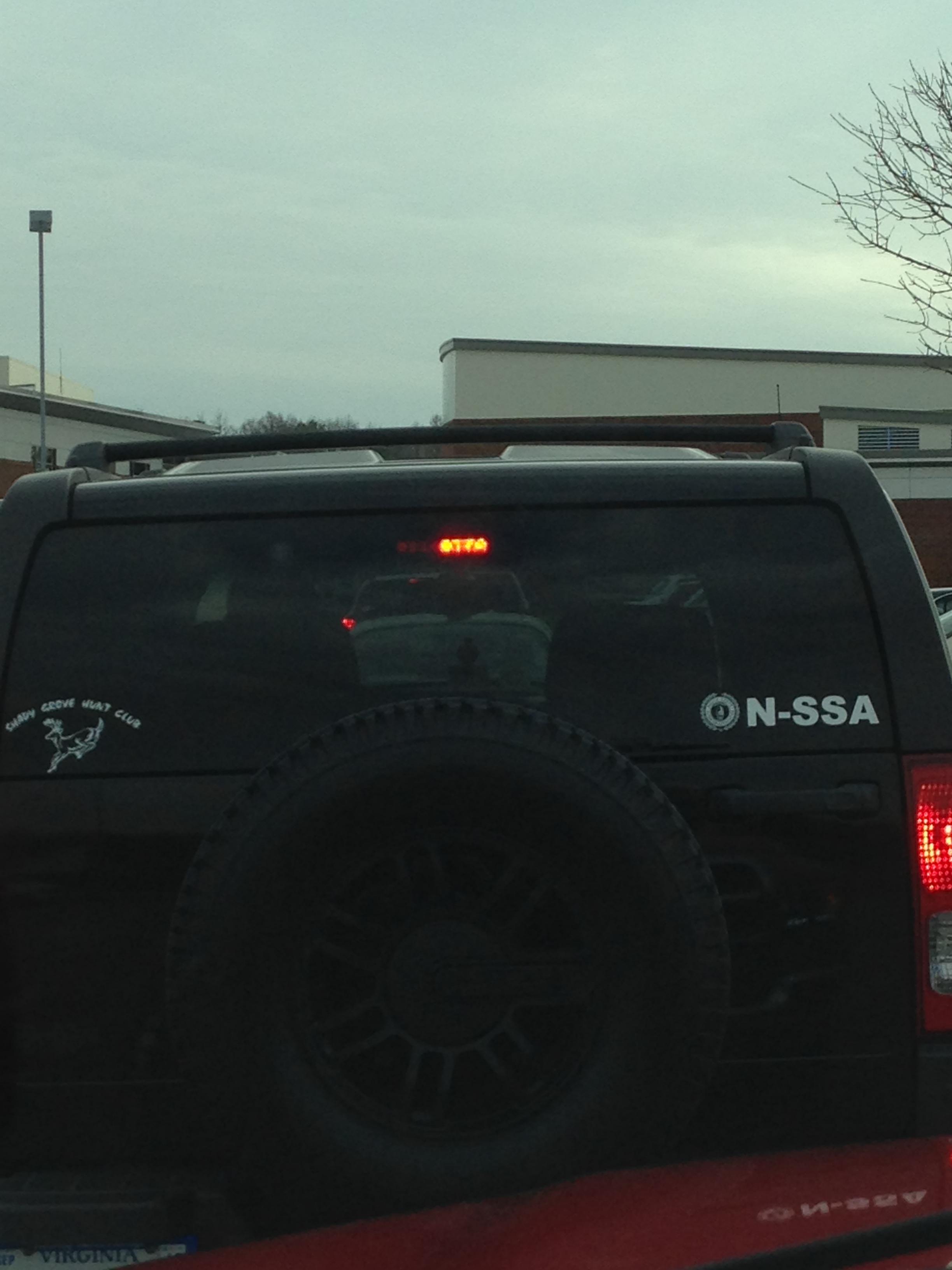

Hey everybody,
I was wondering if you had seen or heard of this happeneing and new nything about it. My thrid brake light only fully lights up halfway and the other half is super dim to the point where you can barely see it.

The CHMSL assembly is comprised of two different circuit boards containing (I believe 4 LED assemblies each). Usually, it requires a replacement of the entire assembly. However, if it was me, I would remove it and take it apart and attempt to see what broke and possible rebuilding the circuit board. But that's me. Granted it is easier to just replace. One of the suppliers here, GM parts warehouse probably sells the replacement unit.

ouch. $157, look like ill be riding around with half a brake light for a while :giggle: i might try and take it apart one weekend. Thanks for the help!

Mine went out like that. Took it apart and fixed the board. There was some water damage/corrosion on the board.
