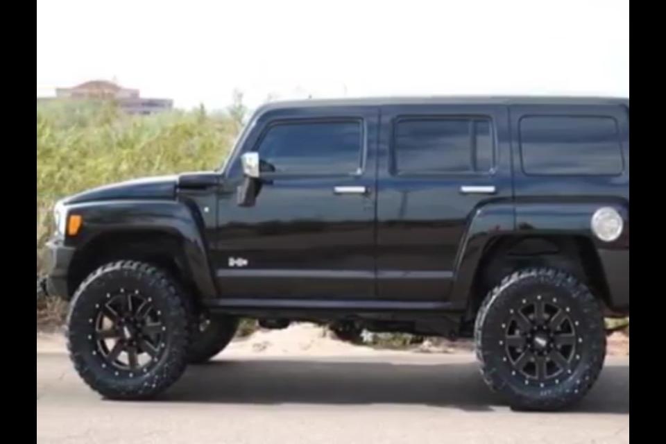

Next month i'll be upgrading my tires to 35" Nitto Trail Grapplers along with Moto Metal 962 wheels. I just cant make up my mind whether to get 18" wheels or 20" wheels. I attached an H3 with 20" Moto Metal 962's and 35's on it. Now the question is 18"s or 20"s?

Do you wheel it? Most people that plan to wheel their trucks won't go over a 17" wheel with 35s. You lose the sidewall flex with the larger rims.

I'm in same situation. Not sure what to do .... 20s look like some gold tooth rapper might choose. 18s might look best.

I have 20s and I haven't been on some hardcore trails like some of these guys but I have out mine through the paces without issue...

My thinking has always been the less wheel or rim you run the lesser the chance you have of damaging one offroad..Being you're in Florida and not likely to be playing in or even finding a rock garden I'm thinking you would be ok with the larger..
I say go small which is just a personal preference.. :thumbs:

Width is important also........I run 16x8's with my 35s and would not go any bigger than 17s.......... With a smaller wheel you have a bigger sidewall on the 35" tire......... When you air down a bigger sidewall tire you get a much bigger footprint which is great for sand driving. (Florida had plenty of sand when I was there last time!!!)

The PO put 20's and 37's on my T and I will be dropping down to 17's and 37's once my rubber wears out.... Too much bling for me and I really don't care for that look.... 20's and 37's have the same side wall as 16's and 33's so I don't consider it a bad combo but I wouldn't have any smaller tire then that on 20's

One could also argue that the H3 design also had a significant amount of on road performance in mind otherwise it would probably have a solid front axle. If you increase the tire diameter you should also increase the wheel diameter to maintain the on road performance as it was designed.

Reality is 90-95% of the time these "offroad" trucks roll on streets and highways. So looks are important.
I have h2 with Toyos 38x15.5x20 -works very well, but with rim being 12" (aesthetics) I get rim rash on rocky trails.
h3 has Nittos 35s on 20" rim not a lot of flex but tires are much softer so it works well too.
GMC has 40x12.5 on 17" bead locks -in my opinion it looks stupid,calipers don't fit inside wheels so my brake rotors are completely exposed and they have 2" spacers.
If I can get 20" bead locks I'll be switching for 40x15.5x20 with 20x12" rim.
