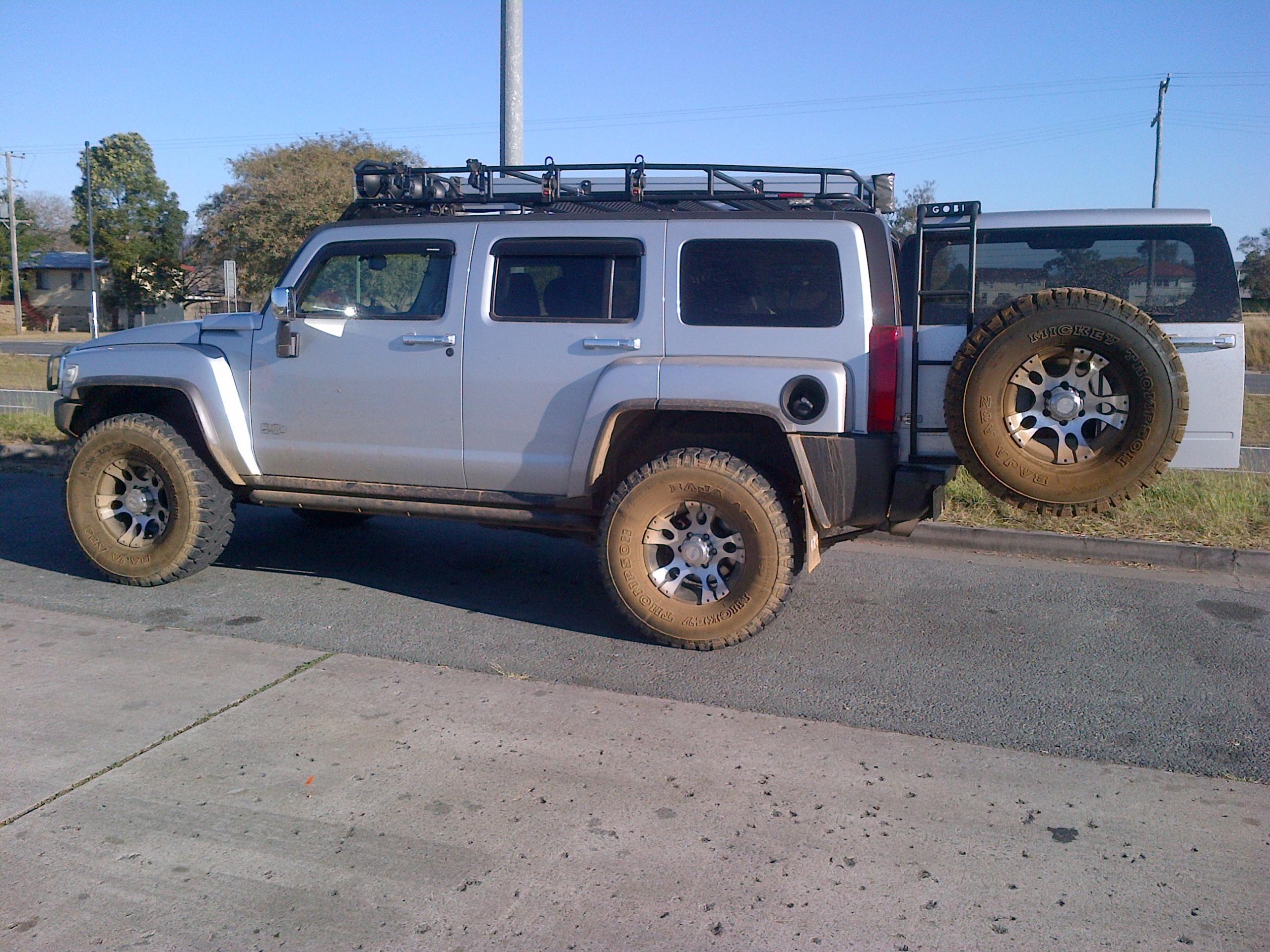

Ok great........I am going to try my usual 40 psi & 18 psi and see how that goes for now. With the tyres now fitted I am off to Gordon Country tomorrow to blood these newbies. I noticed the fronts rub on the mudflap @ 3/4 lock.

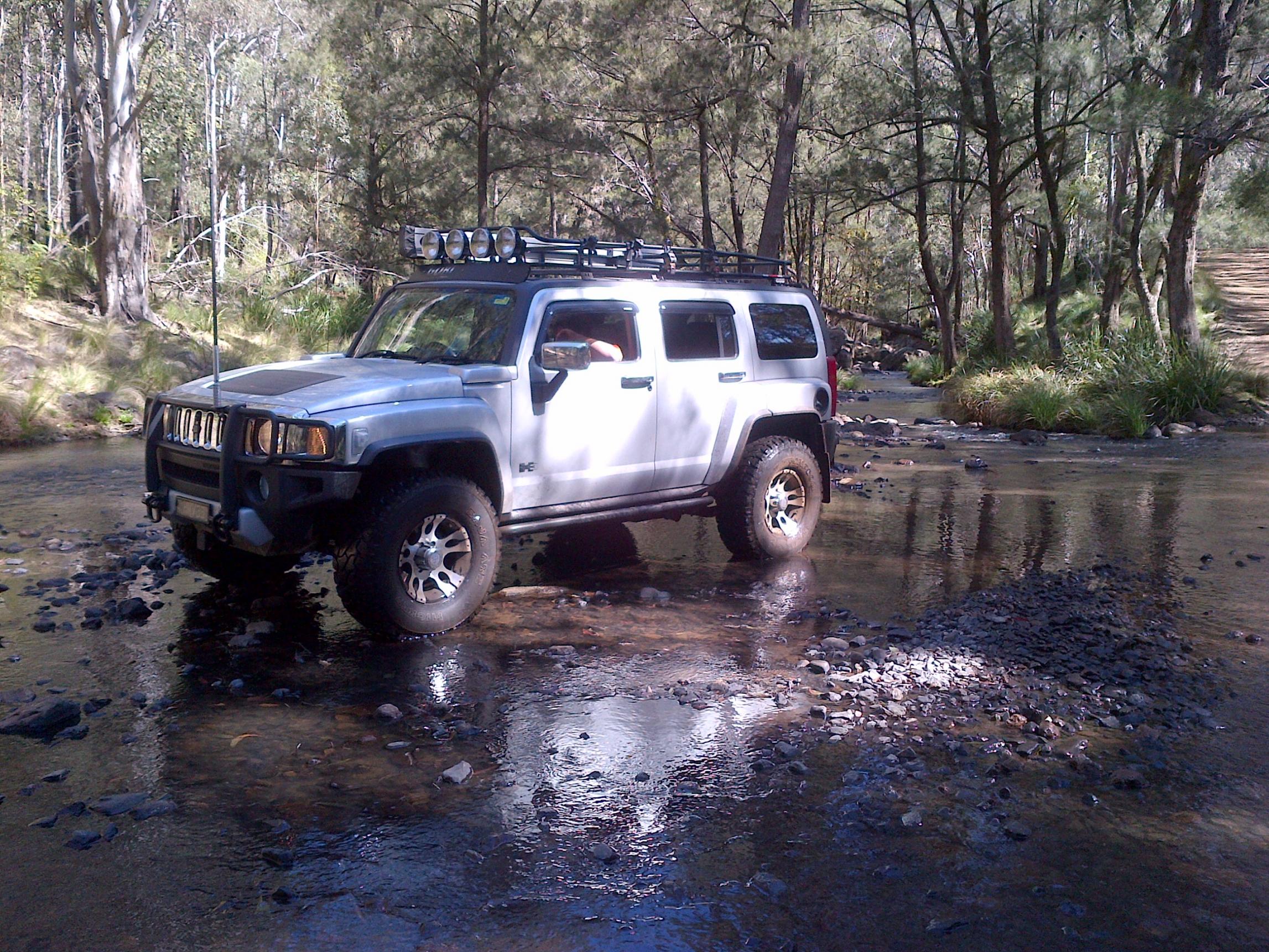

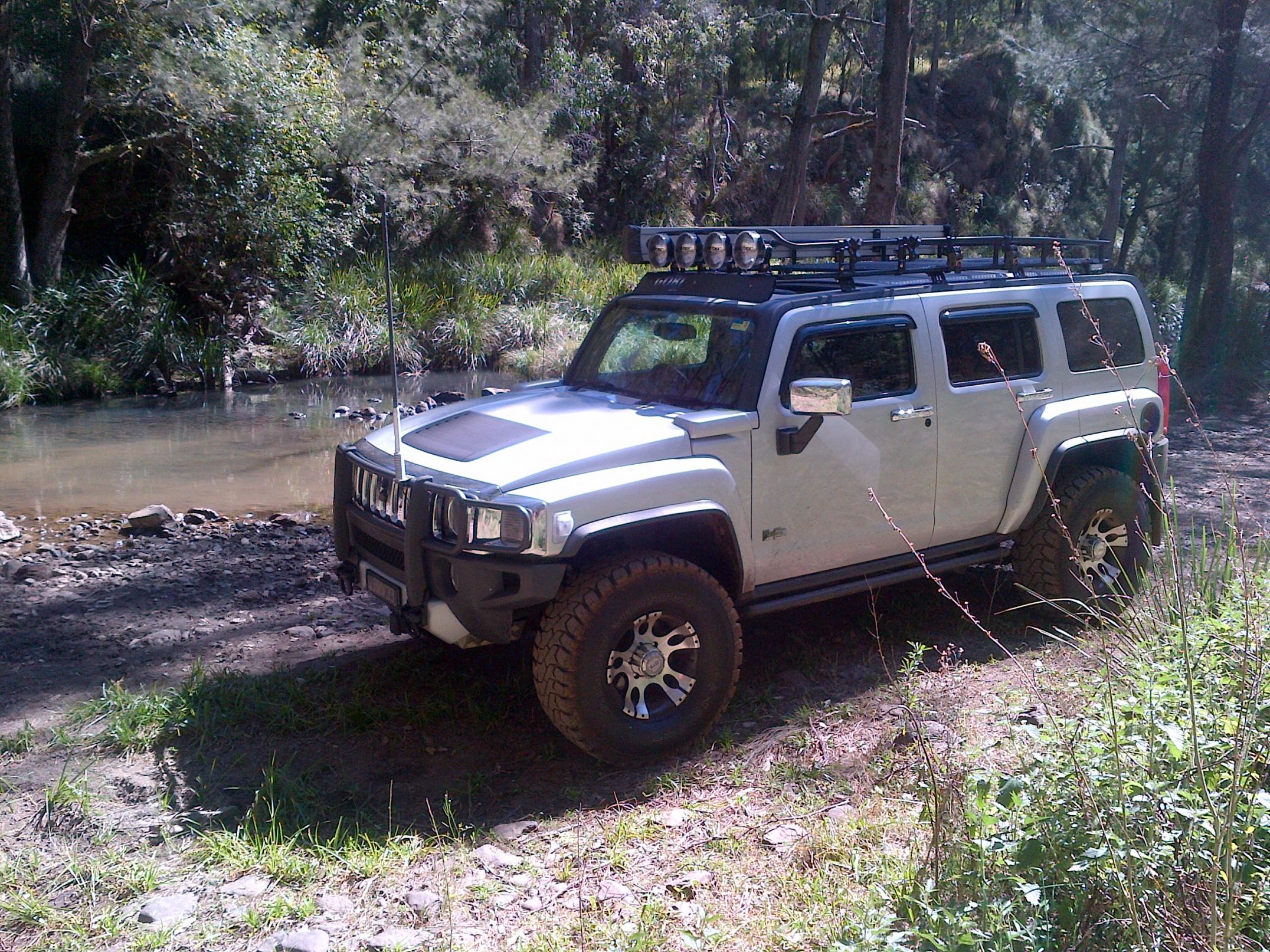

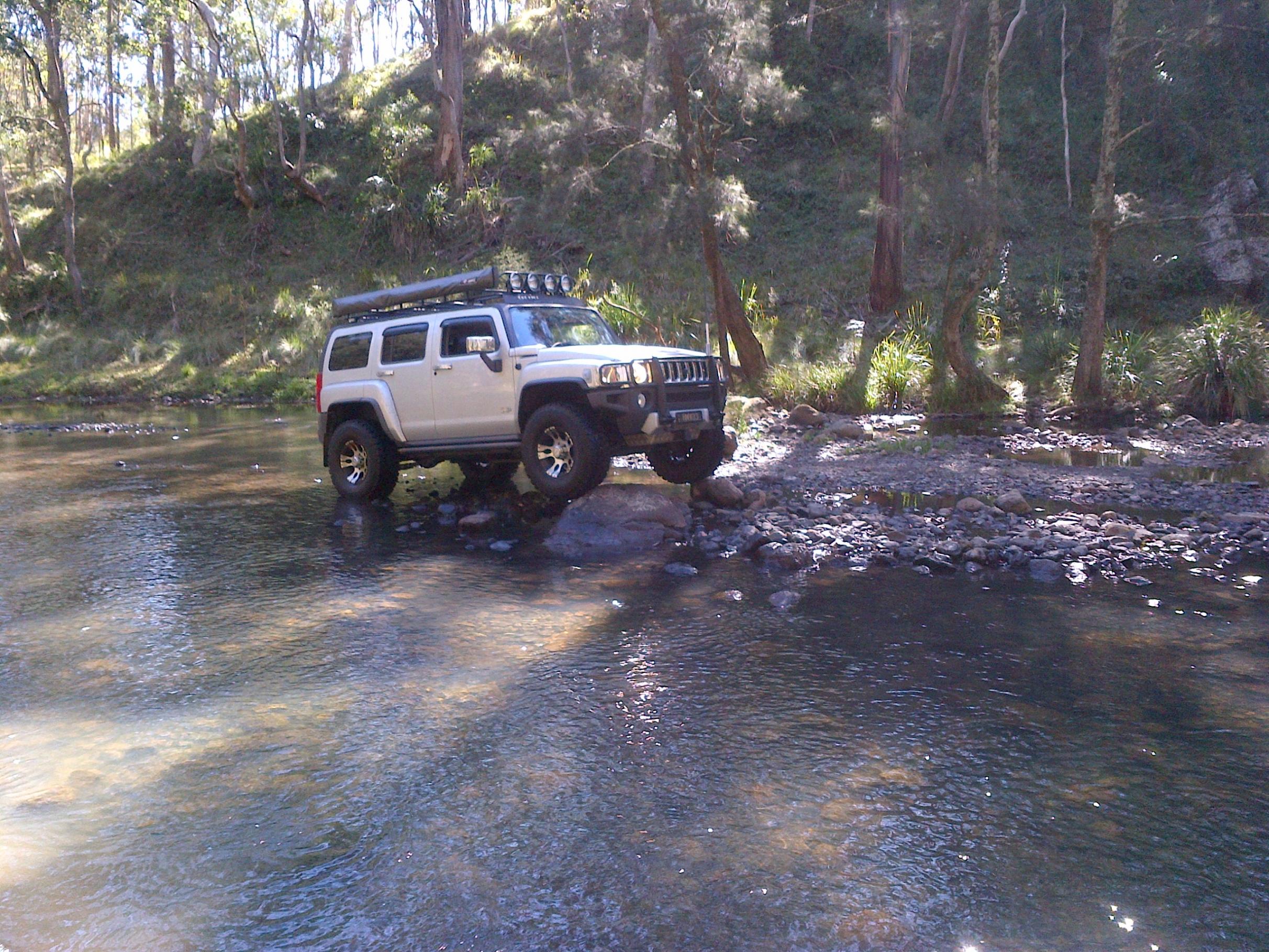

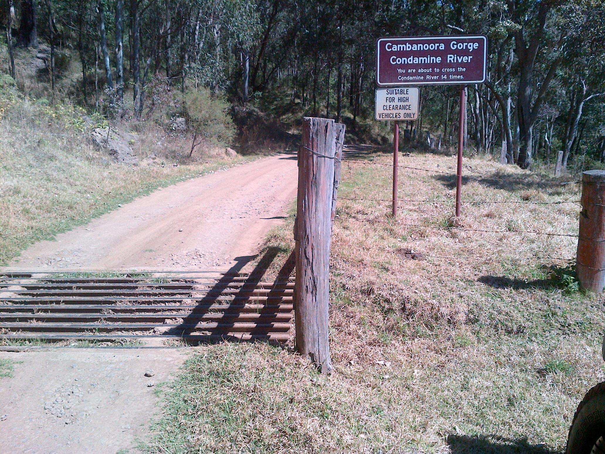

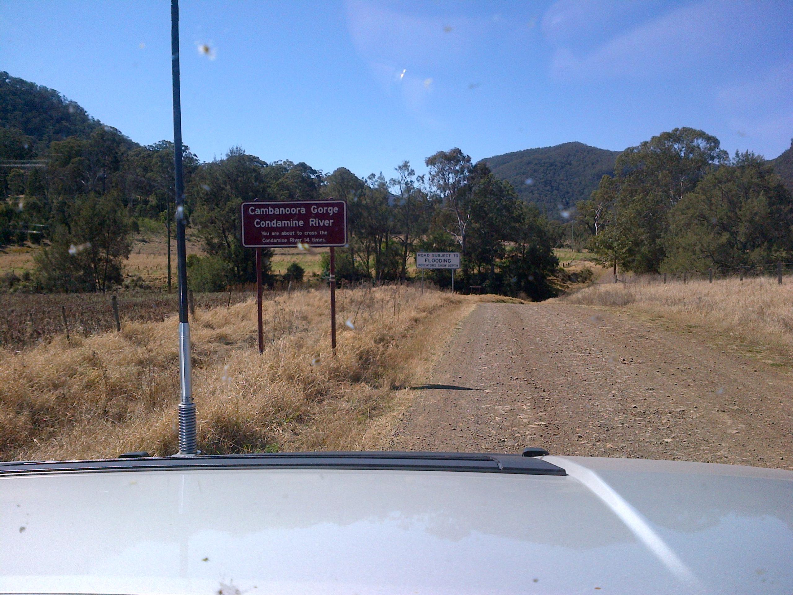

Ok.......... The new shoes got their feet dirty today. Took a trip to Condamine River Road. (The Condamine River is 2hrs South West of Brisbane & is one of the tributaries to Australia's longest river Murray)
Bush Car Ramps.jpgCambanoora Gorge.jpgCattle Grid.jpgCondamine River Road.jpgEat Me.jpgFirst Crossing.jpgHigh clearance.jpgLunch.jpgNew Tyres.jpgNot so new tyres.jpg
